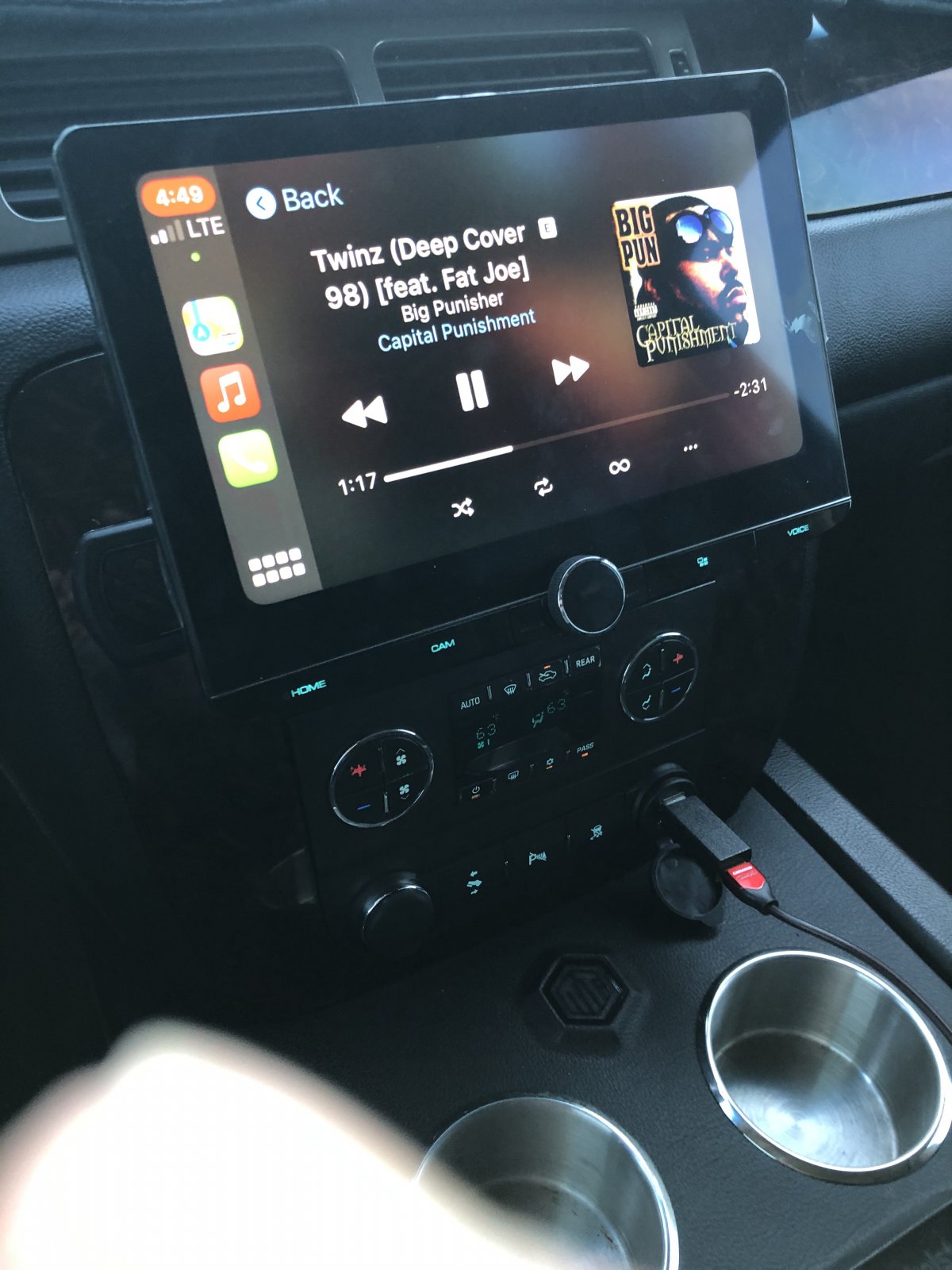

Highly recommend if you’re looking at Kenwoods to go with the 10.5” screen Kenwood DMX1057XR
amazing touch screen, hi res audio, multi media headunit with all the toys you’d want as well as 5v preout which is hard to find in any headunit on the market.

What cup holder setup is this? Looks sharp.

Curious how much that interferes with those center A/C, Heater vents???
That was always my concern with head units that are in front of the vents like that. Seems like the moisture from the A/C and the extra heat from the heater would cause issues with the screen. Maybe I am just paranoid.
