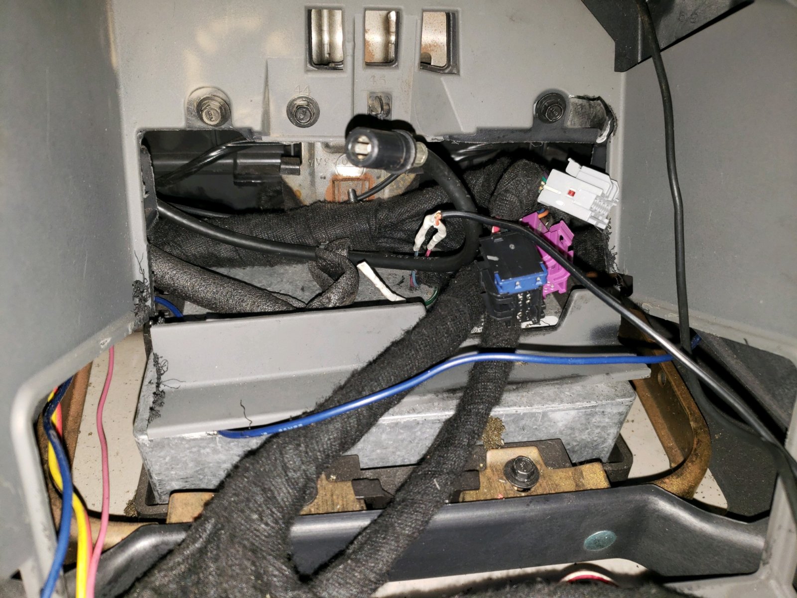

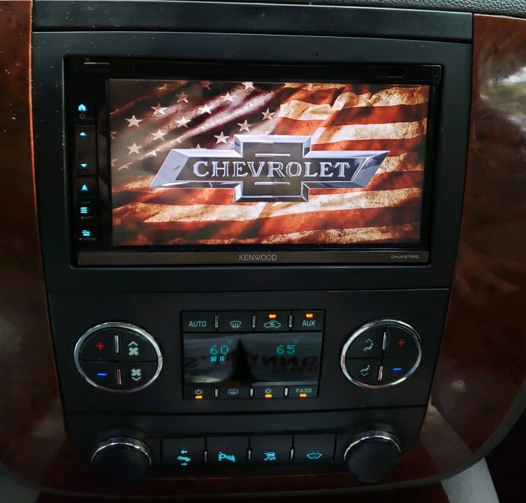

I am running a Kenwood DNX575S in my '08 Burb with the Maestro setup and I love it.
Custom splash screen I made.

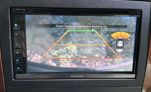

I also have a Kenwood dash cam and Kenwood CMOS multi angle rear view camera which is pretty slick. The dash camera records to the HU and you can play back right on the screen.
It also has the ability to integrate a radar detector into it as well.
Plus many other features including Car play and Android Auto.
With the Maestro you can also hook it up to the OBD2 port and look at your gauges on the screen as well as TPMS sensors and door ajar warnings and check and clear check engine lights.
Having it hooked up to the OBD2 port also gives you functioning backup lines that curve as you turn your steering wheel as well as showing the backup sensors on the screen.

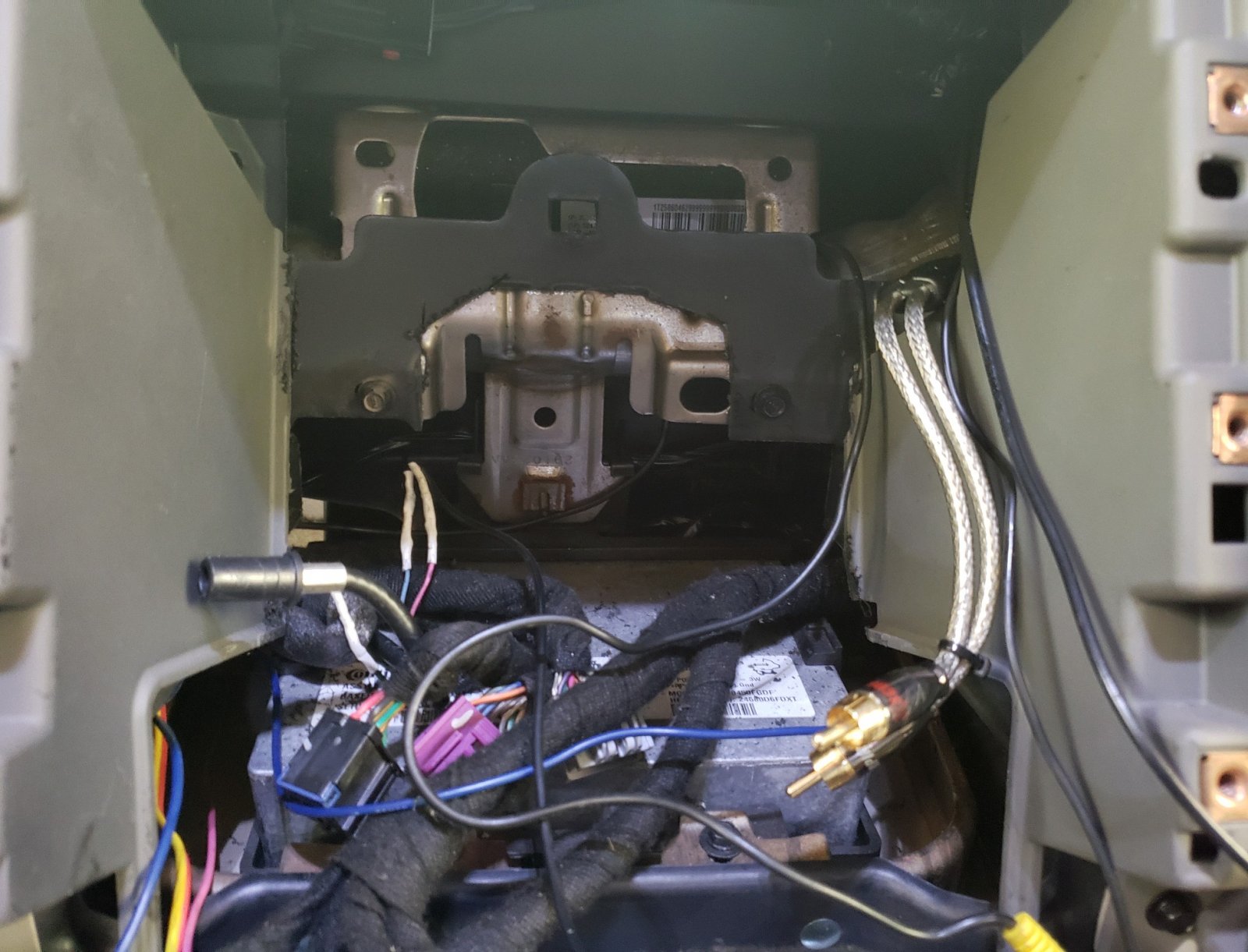

The dash boards, at least behind the HU should all be the same. Some of the trucks have the upgraded Bose system with the center speaker in the dash but as far as I know they have the same amount of space behind the HU.
I did cut and remove some plastic behind my HU just to make some extra room for all the wiring and Maestro module and such but it wasn't necessary, it just makes it easier to tuck everything in there.
