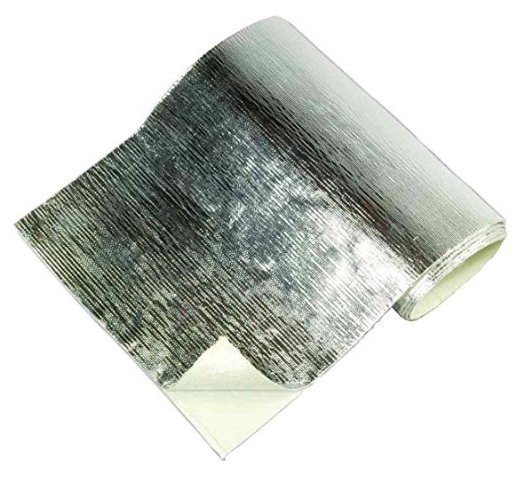

I would probably stick something like this onto the pan above the pipe...
https://www.amazon.com/Thermo-Tec-1...d=1537324729&sr=8-5&keywords=engine+heat+wrap
It is a fiberglass material with a foil backing to reflect the heat.
While I doubt it would make a huge difference in overall fluid temperature it certainly couldn't hurt anything.

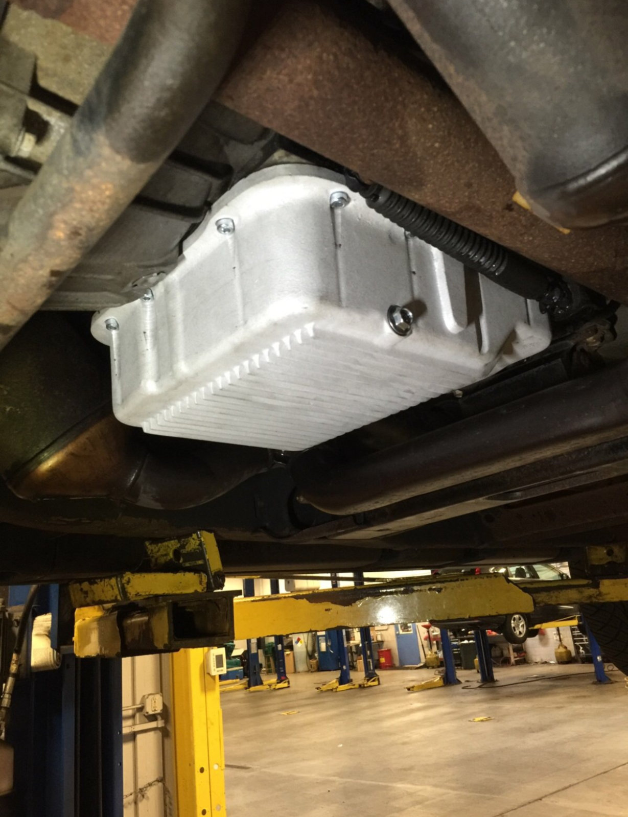

Just a question in regard to the deeper pan, The space between the trans pan/ exhaust crossover is allready tight. Is the deeper pan still recessed to allow for this clearance issue or the same depth throughout? i want to install one simply for the drainplug and future servicing but questioned the fit. Oops, i see the pic but i dont feel i have the much clearance currently, The pic is a 6L80 on a 6.2?
No 5.3, but nonetheless, its only deeper on the one side, not the exhaust side. Fyi 6.2 and 5.3 bolt up same to 6 soeed trans. Basically they are same motor,

This is the 6L80 deep pan...
https://www.yourcovers.com/transpan_9427.php
The other one I posted was for the 4L60 4 speed.

I bought the b&m pan for mine, the exhaust had to be lowered a inch or two to get it on but it does not rub or anything it was just while getting it installed

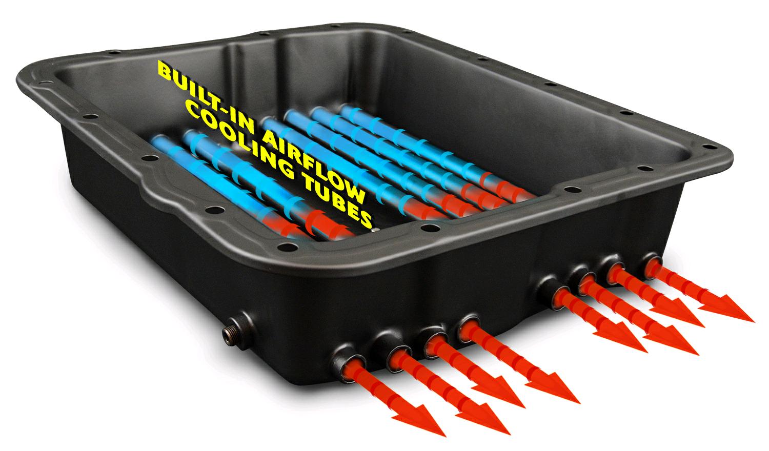

Derale also makes one that has cooling tubes in the bottom of it.
https://derale.com/products/transmission-pans/cooling-pans/14204-detail
Pretty cool idea... unfortunately from looking at the stock deep pan height, and comparing it to this one, it will definitely not fit with the exhaust crossover pipe in the factory location.
