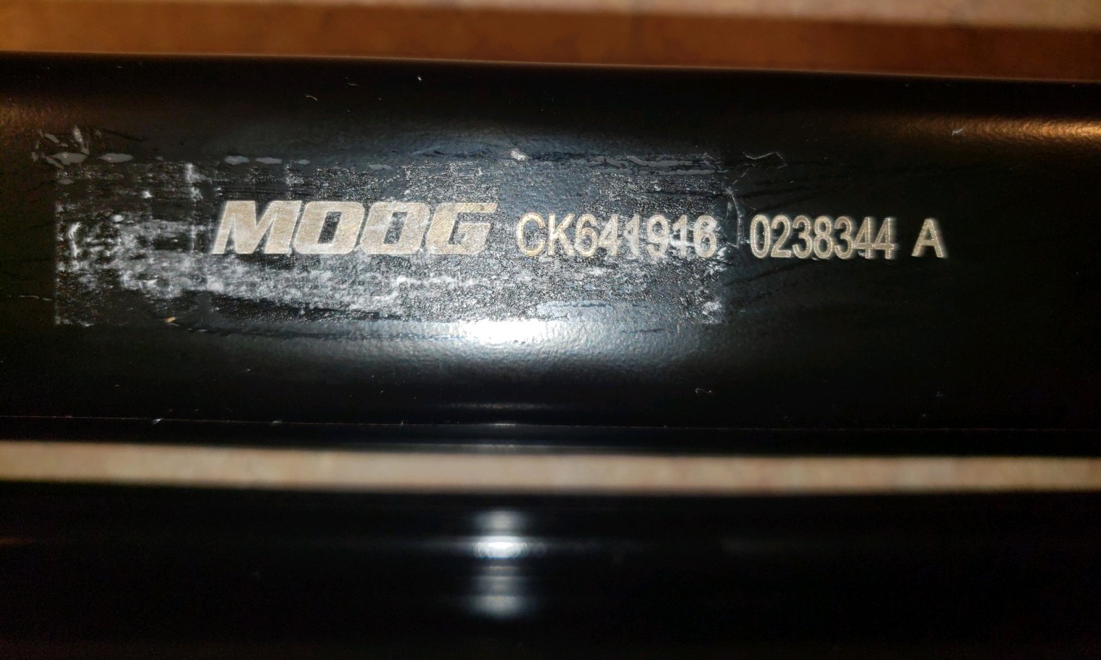

Received the new Moog lower control arms for the rear today.
Moog only shows RK series parts for the rear end of our trucks. No CK series is available.
For those of you that may not know, Moog has the RK series, which is their Budget line and the CK series, which is their Premium line.
The funny thing is when I opened the boxes, to check out the parts, I noticed there was a black sticker on top of one of them. When I peeled that sticker off it has CK641916 stamped onto it.
Looking at both parts side by side I can see no noticeable difference.
I'm not sure if one of them was an older part that got relabeled or what. I can only assume that they used to have CK series parts for the rear of our trucks and for some reason decided to no longer market them as such.
Anyway, just thought I would share.

Well, like I said, one was marked with the CK part number hidden under a black sticker. The other has no markings at all but they look identical to me.

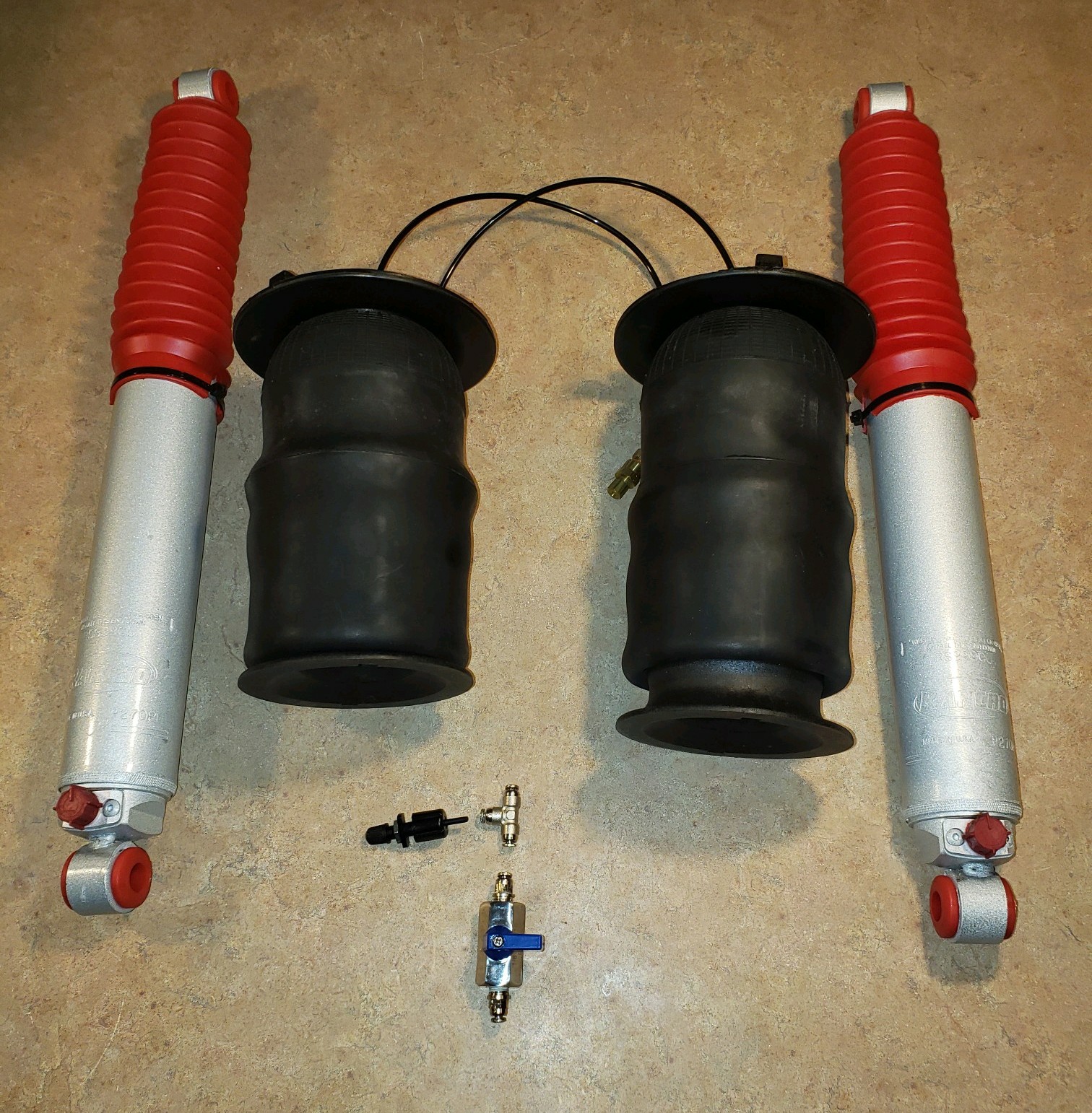

Please don't "T" the air lines together. Make them independent of each other. When you turn, you don't want all the air to move from one bag to the other... hella sway
Truth. Independent systems on each side is much more stable. Like one long ballon or two balloons. Step on one end of a long ballon and the air all rushes to the other end with little or no resistance. Step on one of two individual balloons and it will resist more load.

Kind of hard not to T them together and still run them off the auto leveling compressor as there is only one outlet from the pump. The whole reason for using these is to maintain the auto leveling feature while running the shocks that I want.
If I were running them off of shrader valves for manual filling then I would definitely run them independently.
I will try this first and if I don't like it then I will change it up.
I don't plan on road course racing a 6k+ lb long body or doing a slalom so maybe it will be ok.

You’d need two solenoids and switches or a manifold. Not sure how well this is gonna work with the autoride system. Is this an experiment or have others tried this? If you’re running bags in place of springs you’re gonna need control of each bag and plumb them separate. You won’t like how it corners, guaranteed. Believe me, I know. That’s how my bagged Silverado was set up when I bought it, and every corner was an adventure lol. Slow and steady was the only way I could drive it, and if I put a passenger in the back seat it leaned. And then go around a corner with it already leaning....it sucked.
It is an experiment as far as running it off of the auto leveling compressor on our trucks I guess.
Looking at the specs for our compressor and comparing it to the TBSS compressor, our compressor actually puts out more PSI so I don't think that will be an issue.
As for adding solenoids and switches and all of the other stuff... it's not going to happen.
If I decide that I don't like the way it rides or handles with them linked together then I will either run them independently to individual Schrader valves and lose the "Auto" leveling or I will pull the bags out and go back to springs and maybe build some dual shock brackets so I can add the air shocks I currently have on there, in conjunction with the new Ranchos, back to regain the auto leveling.

I am not sure how the compressor and relief valve works but maybe a simple system with two check valves in the pressure lines and a pair of relief valves independent of each other would work. I dunno how the pump is assembled.
