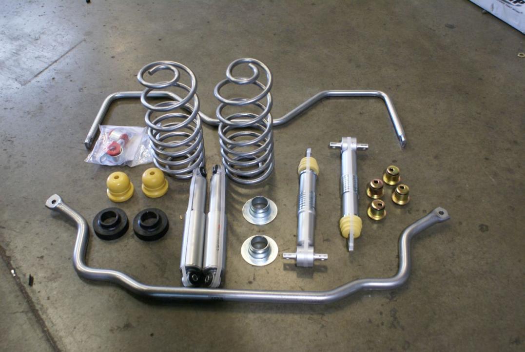

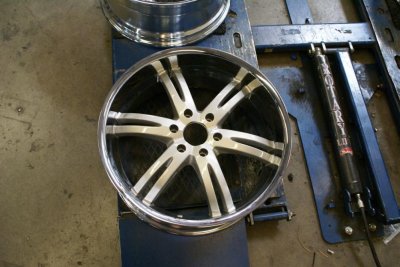

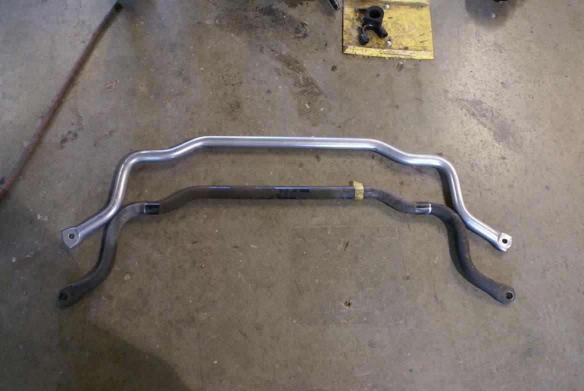

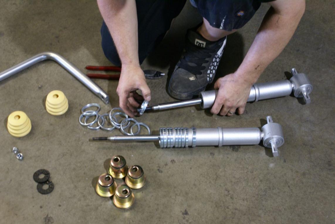

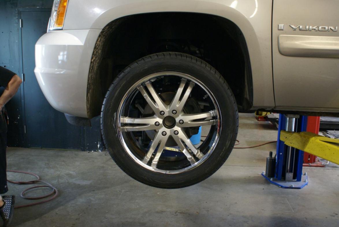

This is the Belltech kit. With the adjustable struts you can lower or lift your front end 2 inches (or anything in between). Just install or remove the rings. I have spindles coming because I want it to go lower than 2 inches. The back is lowered 3 inches but once I install the front spindles I will remove the spacer in the back to get it a little lower. I also installed Belltechs front and rear sway bars (much heavier than stock). The 22 inch wheel spokes are painted (color matched) but the lip is chrome. The tires are Toyo Proxes 305/40/22.
I dont want to show the complete picture because I am doing this build for Truckin' Magazine.
Overall, this was a very easy install that anyone can do with a strut compressor.
