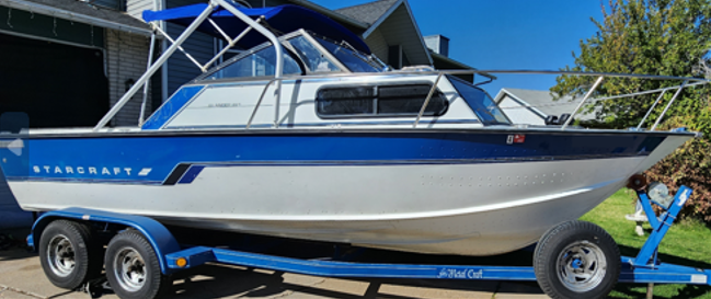

In the end of 2023, I picked up a new to me boat, and the Tahoe did fantastic hauling it home for its several hour drive, and up some canyon roads at highway speeds. :ehcapt:
The boat is a 1994 22ft StarCraft Islander 221 with a MerCruiser 4.3l that has a somewhat small crack in the engine block.
The trailer is a 05 Metalcraft with all the bells and whistles, first time having something with brakes and double axles!
Not to mention this thing was professionally fitted to the boat as metalcraft is local.
The PO kept meticulous records, I have everything including the trailer and the fitting done by metalcraft.
Work starts on it soon... :ehcapt:

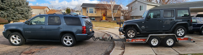

Then the end of 2022 I also picked up a new project, the price was right so I couldn't pass it up.
The Tahoe got it's first taste of about 7,000 lbs (+/-), it did great!
The project was a 2007 Jeep wrangler Unlimited.
Price was 5k.
the catch: Severe rod knock/spun bearing.
I think part of the good deal and the motivation is that the seller came from NC, and the Jeep still had the NC plates on it.
He tried and failed to get it registered here in UT per some receipts I found.
I found it was leaking oil, and antifreeze pretty badly, I suspect that helped make the engine fail.
