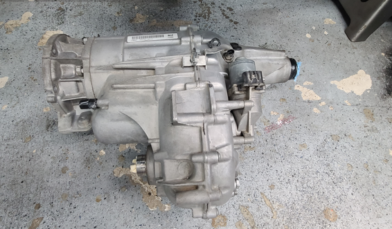

I didn't get a picture of it yet, but I took my transfer case and taped up the shaft ends, and the breather.
then rolled it out front, hosed down with the finest engine degreaser, and used a toothbrush to get all of the crud off of it.
Paying special attention to bolts, and the electrics.
I haven't decided if I'm going to crack it open and freshen it up or not, but this would be a good start.
At a minimum, it will let me see if there is a leak somewhere.
Most likely I'm going to run it as is.
Main thing I would like to do would be to clean the pump pickup, and reseal it...
I'm planning to reinstall the transfer case with the transmission, with the engine out it's easy enough to roll it under there and slide it back into place...
4x4... pita but I need it. :cheers:

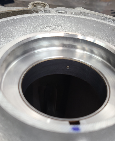

Oh yeah, precision youtube videos.
One of them he called out the rear case bushing.
Saying you need to line up the "lube hole" in the bushing with the space in the case.
I did some research after noticing my OEM installed bushing did not line up with that hole.
What i found out is that pass through hole is just to allow fluid to escape back into the transmission and not cause a leak of the rear seal.
Lube is controlled by the rear carrier, there is a lube hole that comes from the shaft to lube up that bushing.
Lining up that hole will let the pressurized oil to leak right through it.
Do not line up the hole. :jester:
I put my little hole exactly where the original bushing was. :cool:

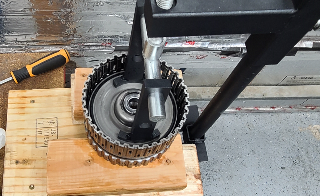

Random find while looking for more detailed specs related to clutch pack clearance.
Lots of good info there.
Doing a check on my clearance, I'm a little tight on one, and in the middle range of others.
There does not seem to be any real selective options available.
As it sits, everything should be fine.
But I'm more concerned with the tight clearance of the low rev clutch at the back.
Part of my mistake was saturating the clutch packs in fluid before installing.
Cleaning and drying, i get a good .048 per my dial indicator.
Spec in atsg says around .050.
Per the link, I'm good.
But i would rather have the clearances a little more uniform.
Rest of the packs, I'll see if i can't tighten them up just a little.
But I'll wait until i confirm end play since this will be another order and a wait.
Might as well get shims on order with it.

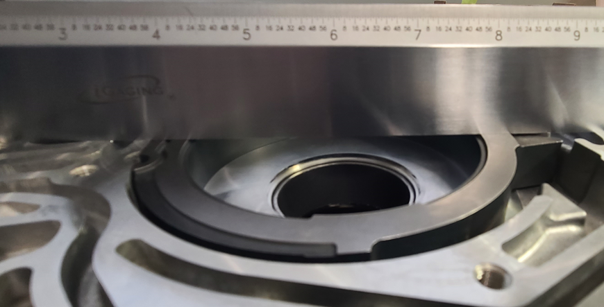

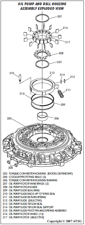

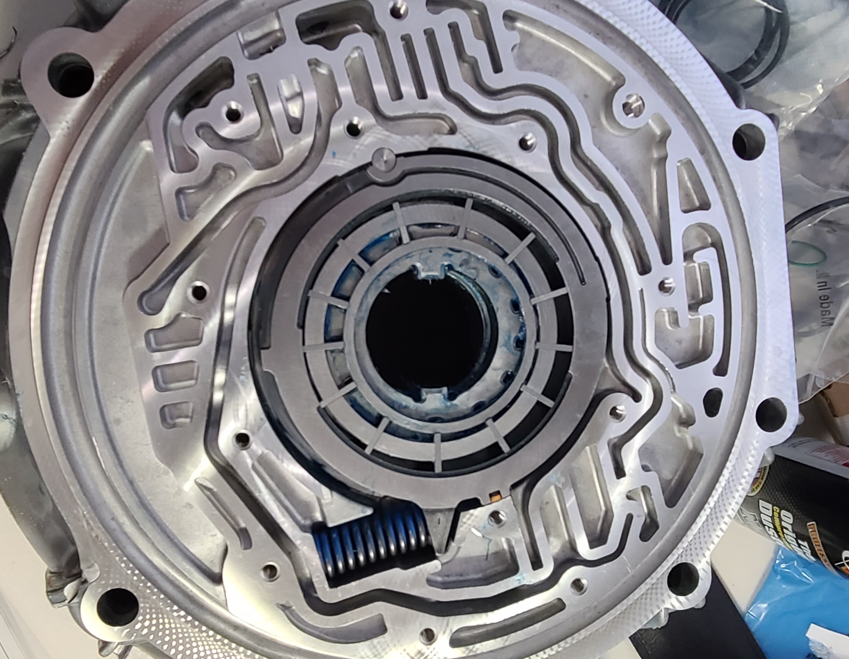

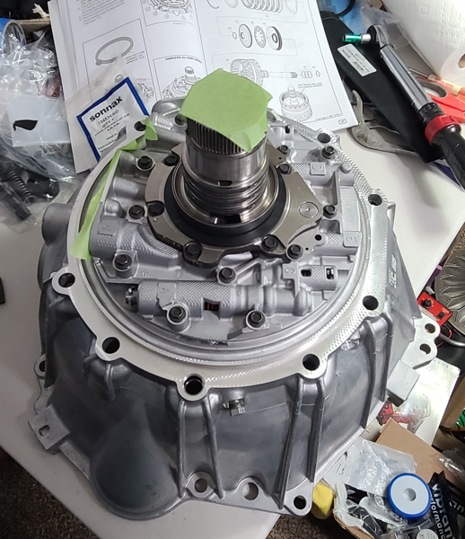

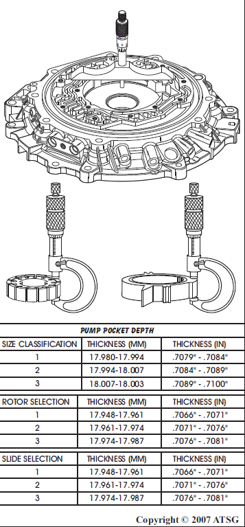

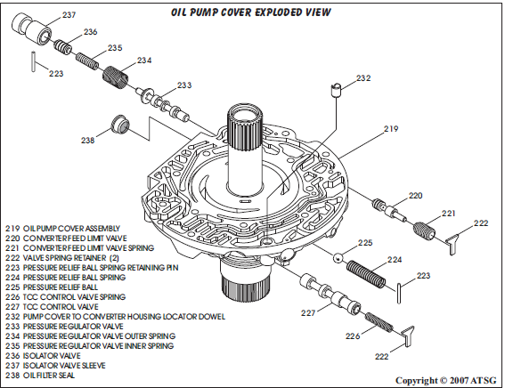

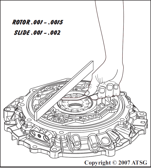

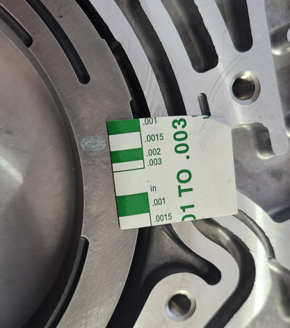

Soon I'm planning to start the pump final assembly.
I'll get some pictures of that process.
This differs a bit from what i learned with the 4l60.
Pump selectives... lol
What i figured out there, is to use the pump slide to confirm clearance.
Those are cheap.
Probably easier if you have the original pump handy, but with me i went with a whole new unit before even tearing down my original due to the pressure gauge suggesting issues.

What wouldn't you check everything with the frictions soaked in fluid? Do they make a thinner steel or pressure plate to get that extra clearance you need? I ALWAYS soak my frictions for a while and then check everything with them saturated.
Generally curious if this is specific to the 6l80
Just Fishing
Just Fishing
Can't fix stupid
Aug 30, 2020
4,499
10,114
Utah
So what i'm seeing is there are no selectives for the 6l80
but some of the clutch packs have selective retaining rings.
So far It looks like I can tune the 4-5-6 and the 1-2-3-4 clutch packs
And I learned the spec is while the clutches are dry, that could be wrong.
but the assumption would be that the fluid would take up some space.

First the t-case all cleaned up, this thing was nasty.
Looked like some seeping of oil over the years had attracted lots and lots of dirt.
I really should have gotten a before.

Here is the rear case bushing before I changed it out.
Still a nice coat of Teflon on there, only mild wear but I replaced it anyways.
Notice the pass through in the rear of the case.
There is no lube feed here, it's just a return to the pan.
Notice the hole in the original bushing being clocked away from it.
I also noticed a mark from the original assembly there, the blue mark.
This was under the rear seal.
This looks like it was marked to avoid placing the bushing hole near the case pass through.
New bushing was installed in the exact same location.
This image was to just keep track of where it was, I have a bunch more of these but I won't clutter this thread with those.
Moving onto the pump assembly,
Snipping this from a PDF version I have of the ATSG manual,
Pump clearances,
Pump and rotor selection,
Just Fishing
Just Fishing
Can't fix stupid
Aug 30, 2020
4,499
10,114
Utah
I bought an actual straight edge for this.
I used my handy caliper set to measure pocket depth, then made the selection.
I came out within #2 for both the pump and rotor selection.
I have one that's great for most things, but not for this level of precision.
So I bought a new one.
Iirc this was about $30 on ebay.
With the pump and rotor, I came out right in the spec, so it's gtg for install.
Plastigauge to confirm,
Rotor is the exact same measurement.
Pump ready to bolt together!
I used the sonnax pump spring, helps keep pressure up at higher rpm
otherwise, the rotor likes to move to bleed off pressure causing some slippages.
I had a good experience with this in the ol vette, so I wanted the same.
This thing was fun to get in there.
I did some testing with the old pump using tools.
but in the end I ended up squeezing it in there.
And of course, the other half has all of the other upgrades from transgo.
I didn't get any images of that process, but it's pretty standard.
Looks complex until your actually holding the parts.

I also used that straight edge to install my rear engine cover to absolute perfection. :jester:
And here we have the pump ready to install and check clearances.
ends taped off for now to keep everything clean. ;)
