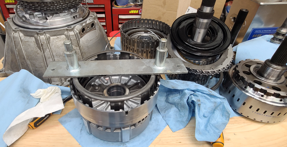

Most of what I have in that transmission looks fantastic.
I have yet to pull the rear support stuff, but the tool for it just arrived today.
It's going to be exciting soon!
I also got the shipping notice for my rods last week, but I don't see any action in the tracking information...
So, it looks like I might be doing the transmission before I complete the engine.
:rolleyes:
Oh well, should be easier to install the transmission and t-case as one unit.
Lifting in and then rolling back into place, with the t-case above the one crossmember that can't be removed.
:Rock on:

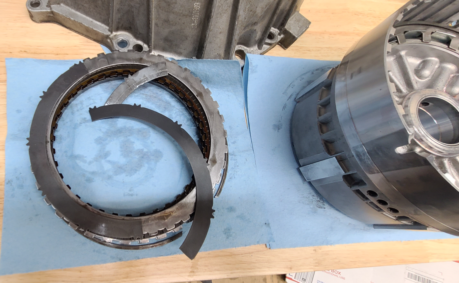

First casualty found!
2-6 wave plate was broken in 3 pieces
I saw this in one of the precisions 6l80 teardowns.
He did say, if he found one there will be more.
Who knows how long it has been like this. :think:

Now you know for sure you made the right call! Last 60 we tore down had 2 broken frictions in the 3/4 and it still drove...amazing how much can be wrong and they still work, yet one tiny thing, and they quit

I agree on the zpak for the heavier trucks. The steels over heat and warp too quickly. I have one in my camaro though. I try to get the tolerance just under minimum spec in 3/4 stack. Like .05 too tight. Seems to be just right after initial break in.
Just Fishing
Just Fishing
Can't fix stupid
Aug 30, 2020
4,499
10,114
Utah
borg iirc makes one of those brands...
I could be wrong... :think:
Mostly there is a difference in different clutches via the friction material they use.
been a long time since i spent the time looking that crap up.
I want mostly stock feel, but a tiny bit better than the stock paper clutches would be even better.
In the end I won't be doing any burn outs with this thing, hell I don't even speed in this thing. :jester:
What I do want is it to last.
And I should have like 90% of what i need to complete the transmission this weekend.
adding the wave plate and the 4-5-6 piston will push this back to next weekend.
So, I'll get done what I can.
Then the engine,
I messaged the seller of my rods to check in with him since the tracking number has 0 activity.
He said I should see activity today.
so far that's a big fat negative.
Lots of fun having engine and transmission parts everywhere... :chair:

and a little something i learned from one of the many youtube videos i watched on the transmission subject.
There is a little part in the 1234 drum, it fits perfectly on the 2-6 piston spring.
I just took a bar across it and was able to compress the spring.
This was a slight motivation for me to just replace the whole drum so i could have a left-over part. :jester:
but in the end, I didn't even put enough pressure to risk damaging that part.
In the video, he actually modified that thing by welding on old steels and made a nice center point for his press.
