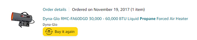

That is a worry.
I had a pretty small propane heater to start, but then when that died, I went with a forced air heater.
My garage door is insulated, I even insulated the little splits in the door since artic winds would cut right through them.
I also have the top and sides of the garage door sealed up nicely.
The garage itself is drywalled, but not really insulated.
I did add some wall insulation for the AC unit I have installed in the window, that wall got really hot in the summer, and it helped quite a bit.
but the propane heater i have is this one.
Even on the lowest setting, that propane heater is too much for my garage.
I have to run it for a little, and then turn it off or I start sweating.
On high, it heats my garage up to a nice toasty temperature in like 10 minutes or less.

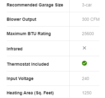

I selected the 7500-watt heater after reading through some reviews.
Decided the 5,000-watt version was not enough.
It's pretty warm here right now, but @40 degrees it did great.
I found a fan helped a ton to circulate, and to keep the celling area cooler so the heater won't shut off so quickly.
Heater specs:
Can't wait till it gets cold again so I can give it a real test.

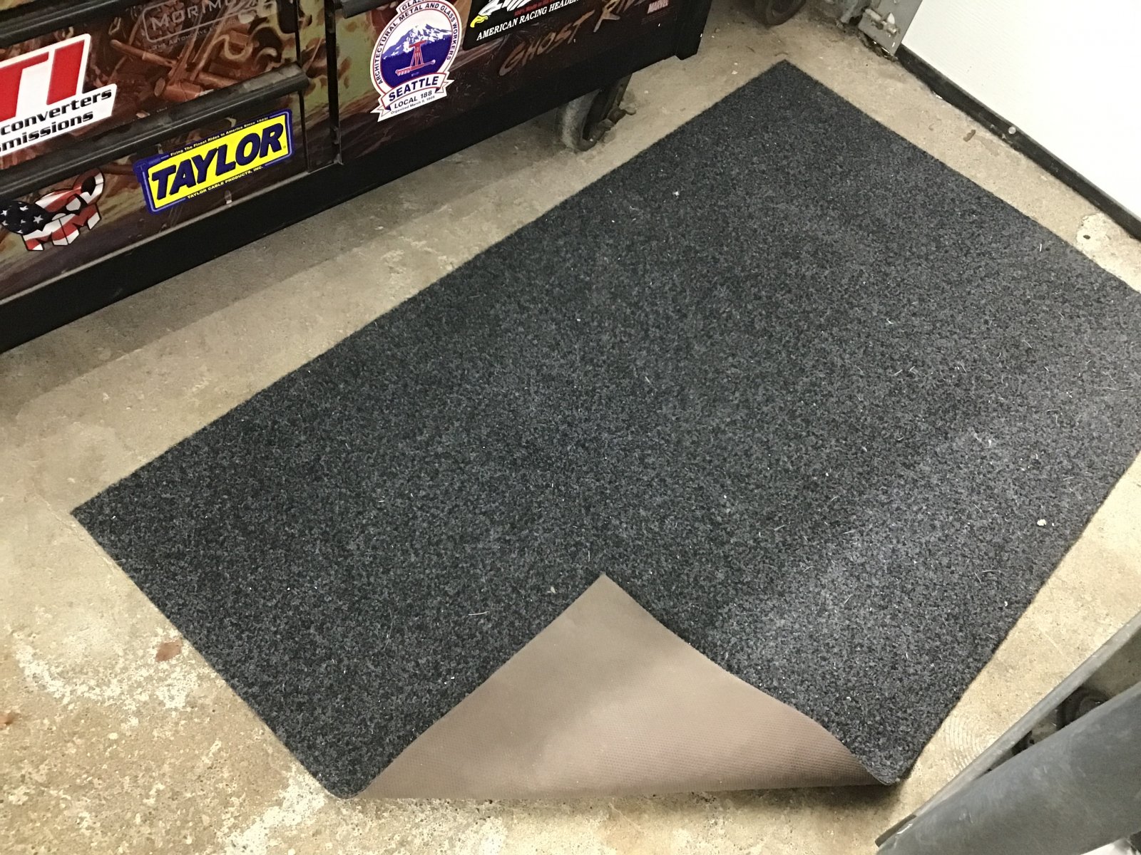

I like indoor/outdoor carpet that I get at Home Depot. It’s cheap enough that when it gets oily or dirty I just buy another chunk.

And that out door carpet is a pretty good idea.
I recall being able to get a decent sized sheet of it for like $40 ( grey color )
That was about 10 years ago.
When i did my first boat refurbishment.
A little 15ft starcraft, the type you drive from the front.
Tossed a 3cyl 65hp mercury on there, that thing really moved.
Second boat i went with vinyl flooring, specific for marine use.
The carpet held up well and cleaned easily.
But it was a fishing hook magnet.
I still use that home depot stuff to line trailer bunks.
Very tough stuff.
52,949
If I’m draining anything I keep the carpet back a ways so it doesn’t get any fluids on it. This is the stuff I get. It’s rubber backed, real thin. I have some bigger pieces rolled up but this one stays on my garage floor, ready for quick use.

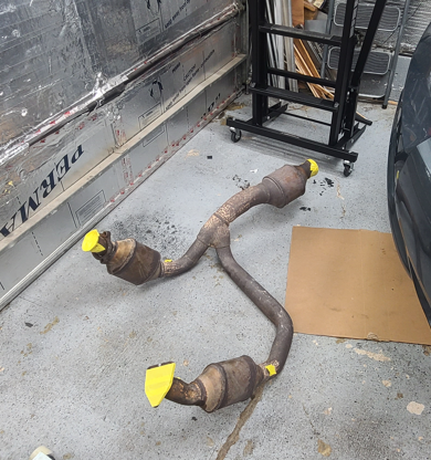

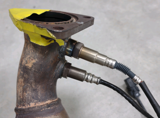

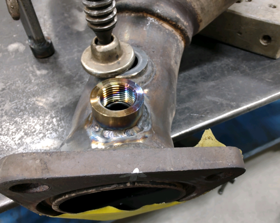

Got a bunch done to the hoe over the weekend.
Exhaust is with the welder to have him install an extra O2 sensor bung.
I found some caking of oil all over the transfer case.
It also looks like the output shaft to driveshaft seal is starting to leak slightly.
I'm not sure if the nasty all over the transfer case is from that or not, but I'm leaning towards resealing the case while I have everything easy to get to.
This will also make it easy to replace that bushing in the case extension. ;)
I'm thinking it might be a good time to have U joints done @ 180k

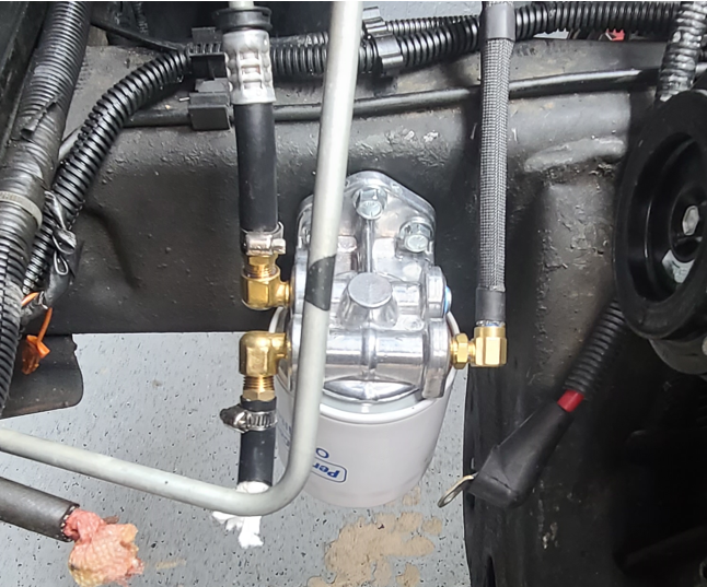

I didn't get a picture of this when i installed it, but this is my install of the transmission cooler line filter.
I used rivnuts in the frame to keep it cleaner and easy to remove later.
I'm planning to do the same for the power steering side.
For the transmission side, this will be AN fittings once I'm done.

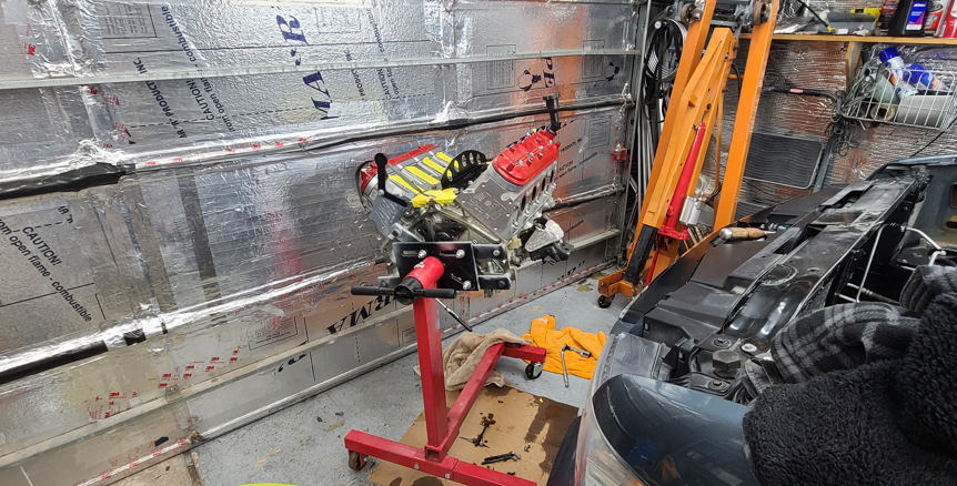

I pulled the engine, heads still on.
I ended up removing the exhaust manifolds to ensure it didn't damage the AC.
Doing this on my own, so it's hard to watch everything.
With the crank pully off, it gave me plenty of room to clear the engine bay.

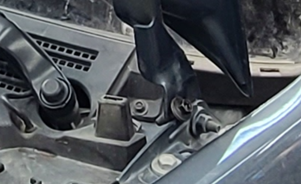

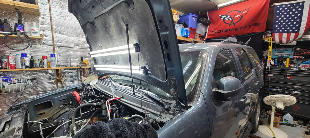

I also tried out this little thing i saw on youtube.
Apparently, the hood has a "service position"
You remove the spring-loaded bars on the side, and disconnect the gas filled hood prop.
And with the plastic hinge trim removed, the hood goes back.
Then some little hook little things are visible!
Just the right size to jam the bolts you removed from the spring struts.
Hood in service position!
Zoom in of the locking location.
Apparently in the NBS, this is actually a hole and it's threaded!
I heard after 2015, they did away with it all together...
