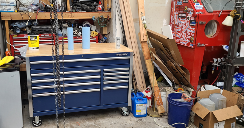

Slowly getting the garage organized.
My new workbench.
The original plan was to rip out that shelf crap behind it.
But as reviewed the crap that got piled up there over the years, I opted to just place it here for now.
Sheds are planned for this summer (if finances allow), I can clean up my mess afterwards. :jester:
There has been a wood bench in this location, so it's now sitting in the front yard.
My OCD neighbor I'm sure loves it. :)

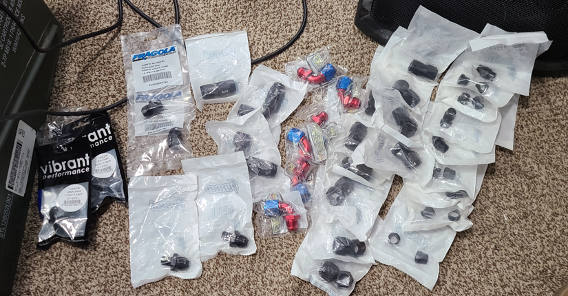

And i got a delivery today.
Seals, bolts, and the -8an fittings.
Always amazes me how fast -an fittings add up $$
not in the image is a box of braided transmission cooler line and the transmission -8an adapter plate.
I'm also pushing the engine oil cooler order back a little, i plan on doing the same -8an deal.
but the cooler adapter seems to be about $100 - $200
Other options are cheaper, that is if i can mount the lines straight out.
Pending a decision after i have everything apart again.
Hopefully i'll have some -an fittings left over. :jester:

taking inventory, and it looks like i forgot that i still needed to make a decision for the style of -An host to hard fittings i needed. :think:
So, i don't have enough for the project.
Whoops!

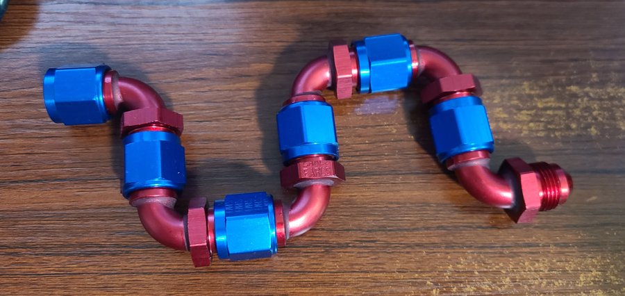

Having fun with the fittings... :jester:
These earls 90 degree fittings have little holes in the packaging.
those holes allow dust in.
I think these fittings have been on the shelf for a long time. :rolleyes:
This is after i cleaned them...
nice hard film inside of some of them...

soaking them in pb blaster, hopefully the film cleans up a little easier afterwards.

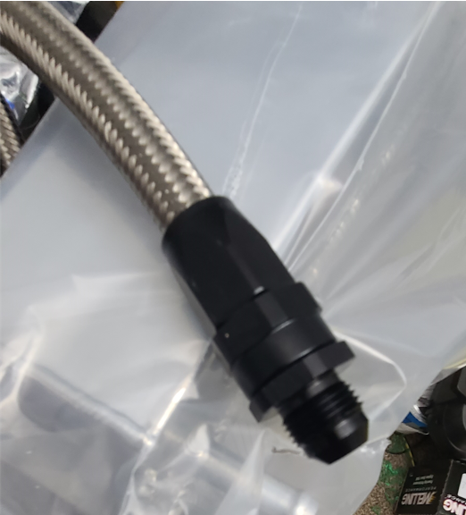

First attempt at doing SS AN lines.
Success!
I used some green masking tape i had laying around to apply to the braid.
Then used my die grinder to trim/cut the end off.
I left a thin ring of the tape in place for assembly.
and used some dielectric grease to lube the fitting, being careful to not push/ooze it into the hose during assembly.
I have one special -an adjustable wrench.
it worked great, used an evil energy branded one since it was less than $30 shipped off of amazon.
I decided the single an wrench won't cut it, so another one is on order.

I'm not sure if the official tool to do this is a miracle or if it sucks all together. If I ever do that shit again, I'm buying the tool.
When I did my ls swap on my 74, I did all braided fuel and trans lines. Wrapped it super tight with electrical tape, then cut with die grinder. Forced the fitting on, yada, yada, yada. By the time I got all the lines made, my thumbs full of holes and bits of wire from the braided part fuzzing up. Out of everything I did to that truck (full frame off resto), that was the part I hated the most
These went together pretty smoothly.
I'm remembering loosely a video I watched months ago when doing it.
I recalled masking tape for the ends in the video... so i ran with it.
I thought electrical tape for a sec but decided it would probably bunch up on me.
I was able to do a nice tight wrap using the masking tape, but it's also an auto body grade stuff.
Sticks really well.
and it was difficult to trim to a thin ring, stuff didn't want to let go of the braid.
I was also worried that the stainless braid would be very tight (reading reviews for fittings)
These fittings were "Evil energy" via amazon.
they are -8an lines, but the one larger end for the hose connection was -10 for the wrench fitting.
I'm hoping my other connections go just as smooth. :jester:

I think I used jegs and russel brand fittings. Russel brand hose. I did -6. Had fittings to return less style fuel filter then to fuel rail. Trans I did to hard lines I bent all fancy like from radiator to inside the frame rail. I may have had a beverage or 6 when I was doing it
Lol yeah,
I'm planning to try the fancy bends for hard line.
And only use the braid for areas where i think it will need flex.
Pretty much planning to copy the factory line, but with the larger -8
We shall see how well that goes. :jester:
Last time i did this, i found it was one trial run, and then a final after the trial run was all sloppy looking because i made the bend too far out, or too short.
but that was with -6 an
I expect this to be a pita.
:yaoface2:
