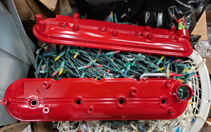

Well i was just painting my other valve cover silver.
then I started thinking.
:hmmm2: Man this engine could use a splash of red...
so figured wth, decided to see how it looked with a light coat of red...
as hoping the silver backing would show through.
Answer = not really. :jester:
Fk it, A heavier coat of red is now drying... :D

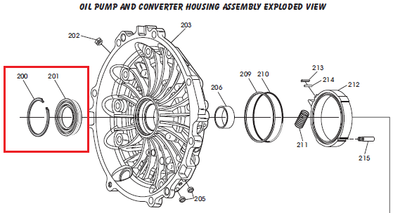

Well for this weekend tasks,
I decided i best go ahead and crack open the ATSG manual for the 6l80 to see what the pump to converter seal looks like, and the recommended replacement method.
They put in a c clip to retain it!!
Explains what i saw with the replacement that i have.
Has a nice little rubber seal on the outside.
Usually it's a smooth surface where they recommend to use some sort of locktite to prevent it from walking out under pressure.
That makes life so much easier, i was worried i would need a special tool or something in order to get around the input shaft.

I searched around looking for info on what's needed to change the seal out and found nothing.
The new seal, i found it odd that it had a rubber seal where i expected smooth metal.
I was assuming i would need to make a tool in order to drive the seal in around the input shaft, i was so glad to see this improved design over the old 4 speeds.

Splash of red for the engine bay, check.
Wind picked up as i was letting it dry, so i got a little trash here and there.
Coil packs will cover most of this anyways.
And I planned on allowing the paint and clear coat into the oil fill hole.
Only goes down to the retaining lugs.
I'm hoping this will tighten up the silly oil fill neck.

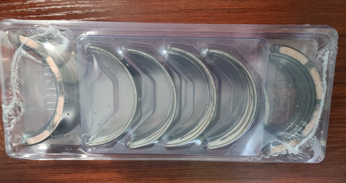

and fedex finally decided to grace me with their presence.
Mains w00t w00t

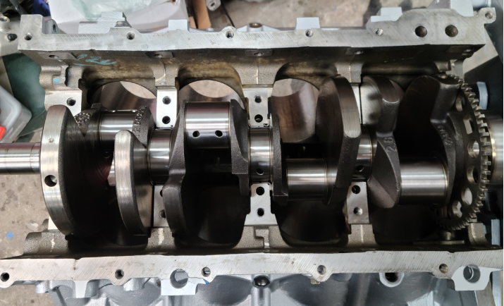

got everything nice and white glove clean.
Camshaft is in.
Working on the crank now.
Just set the thrust bearing, about to angle torque that *****.
I checked the end play with the inner set of bolts in place, came out to be about .002.
Then i found out i need to finish up the bolts before I'm supposed to check. :jester:
got more pictures to come.

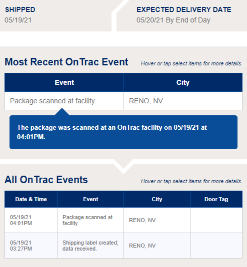

Ever since the whole rona thing, Ontrack started sucking balls.
These are the same guys that had my engine block for a solid week before they bothered to deliver it.
I figured that was just because of it being heavy...
