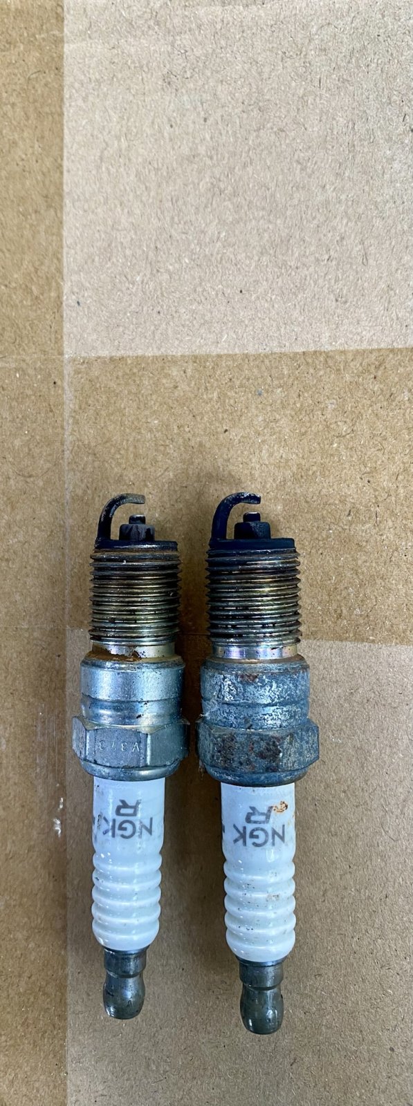

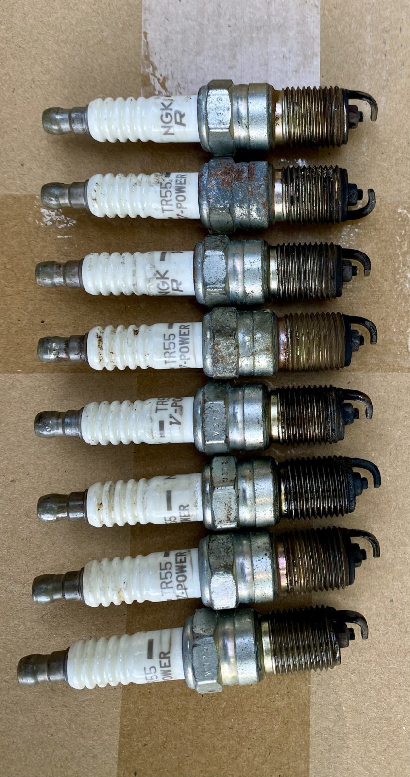

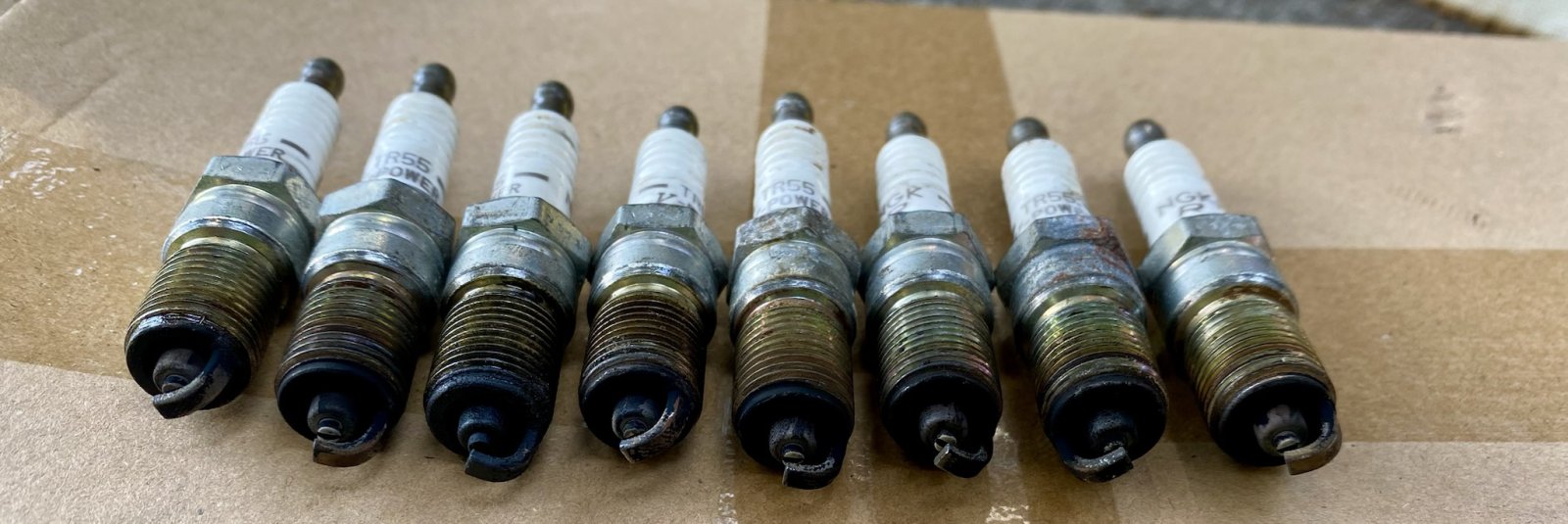

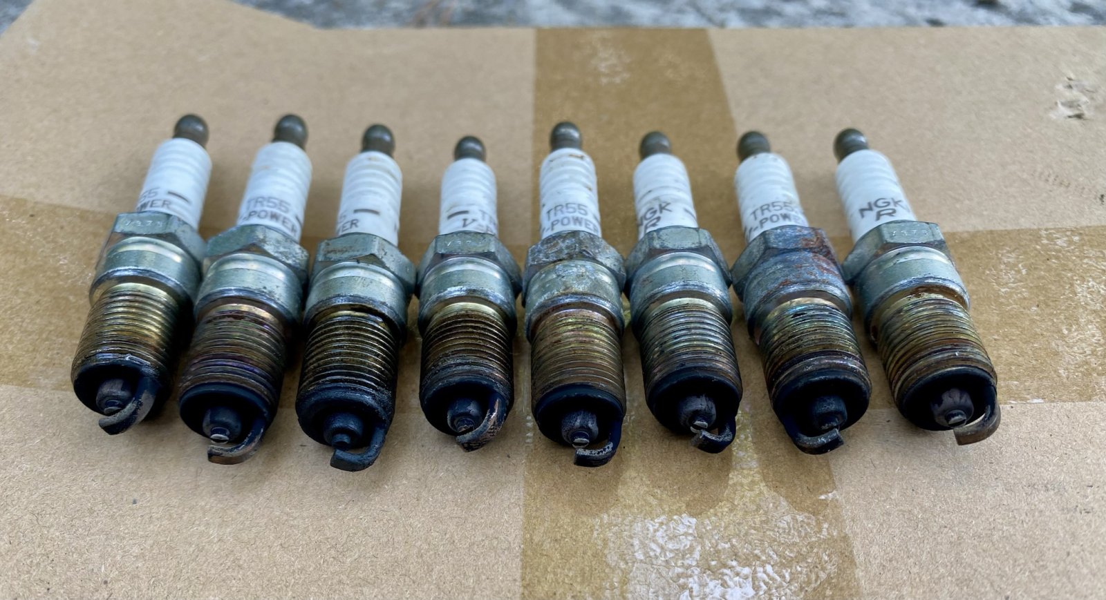

just changed my plugs....
Jul 9, 2026
95
87
somehow were gapped to .60. they're at .40, now.
what do they look like to y'all? (bad) but ideas?

Gaps change over time as the tips get burned away, especially since, like @Fless said, nickel plugs instead of platinum or iridium. How long were the old plugs in there? Unknown? Age of ignition coils? Age of wires?
Since, IMO, looks like a slightly rich concern on all of them, may have been a weak spark or needs some TLC at the MAF/MAP sensors and a thorough cleaning at the throttle body with the correct cleaner and correct procedures for the cleaning and then a possible relearn drive or scanner reset.

Those TR55 plugs are very common in the LS world. TR6 is more common: it's the same plug just gapped diff at the factory
They should have been pre gapped from the factory, but you never know
what gets thru these days.
Make sure to just replace them with real NGK or ACDelco plugs per the application
and you'll prob be just fine. Wires would be a good idea at the same time

I run tr55 or tr6 in everything I run or build. Granted most of the stuff i do is running much higher than stock cylinder pressures, so i want the copper core as a last resort fuse, but i still huck them in even basic stuff. I can do 4 plug changes for the price of one plug change in iridium, and it only takes a half hour. Maybe I am getting old. Looks like the plugs were running just fine to me.. just time to change them.
