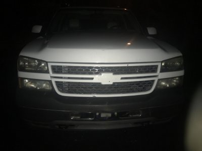

Got the bumper light connectors on the drivers side replaced with new ones with a bit of solder and tape. Was gonna work on polishing headlights, and then got distracted by paint.
painting over chrome sucks, and this won’t actually be the last time I do this job, because I’m not happy with the way it turned out, yet. But it is done for now, and until I figure out the permanent bumper situation, I’ll just ride with it, then paint all the new parts together. It was dark before I got it back on though, but here’s and idea of what it’ll look like370119FB-EDFD-49AF-848C-58AA03FEAC5E.jpeg
