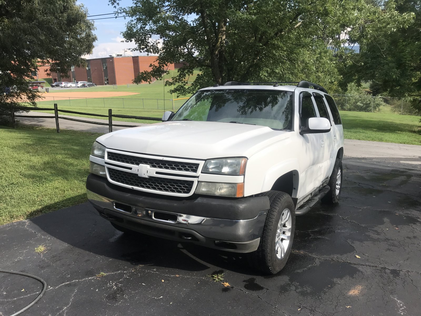

Finally got the old girl washed down and took some actual pictures in the daylight.
Next steps:
replace drivers door (deer damage)
Replace knock sensors and all upper engine gaskets.
Fix 4wd (modulator motor)
Fix rear air
New headlights/tail lights/fog lights.
Now trying to find out if I’m gonna try for 35s or just 33s.

Well, after a long break, I’m back.
I daily-ed the Tahoe to work for a while and it was all good, until one of the used GMT900 front brakes decided to lock up. So I pushed against it for a while, thinking I’d get in there and rebuild it, but when I took off the three months and didn’t drive it, the battery died. I left it alone while the wife and I decided if we were gonna sell it.
Then last summer, I got frustrated of having to jump it off every time I needed to move it and parked it on the farm. There she sat, sadly until about a week ago. I really got mostly afraid she was gonna turn into a mouse house, or lose some electronics that I wouldn’t be able to track down. After a scare of not starting, I realized it was too steep of an angle for the fuel pickup. Poured some in from a can, and bam. Runs like a top still. I just love that damn motor.
Anyways, replaced the battery, and went to rebuild the caliper, only to find it was essentially junked. The pistons were totally locked. So bough a re-man and slapped it on. Rebled the brakes and now works perfect. The stop power really is much better.
Then I snagged some 33x12.50s off Facebook for $125 with great remaining tread, and had them thrown on today. Next step will be removing the wheel spacers which right now make it look like I’m trying to build one of those trucks that explore the Arctic. Aaaaaaand hopefully it’ll correct some of the rub I’ve got now when turning. If not, I’ll get creative with the plastic cladding.
Next steps will be hunting down some electrical gremlins, run her to a body shop to get the replacement door painted, and some other body parts as well, and then probably have to let her go.
Anyways, here’s some pictures!AB5909E6-73E3-4994-A113-0F2E340B2AEF.jpegafter brake replacement. Before tires.696F8F57-37A4-44B6-B50D-1C13A06B25B6.jpeg01FBCC0A-4A3A-4E42-B8B7-1CFBEC57C729.jpeg

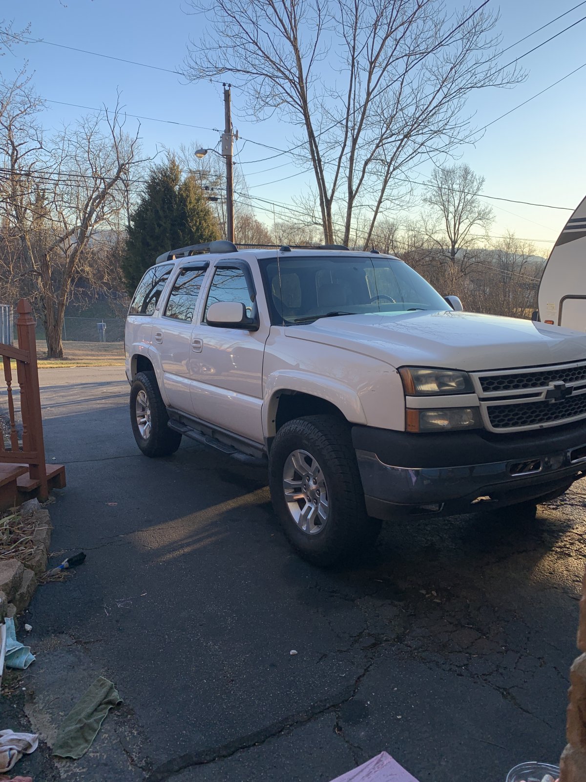

Anyways, here’s some pictures!View attachment 390588after brake replacement. Before tires.View attachment 390589View attachment 390590

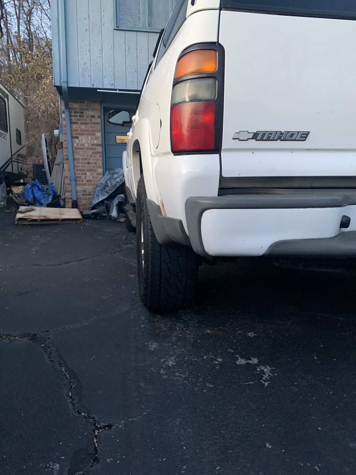

Took the wheel spacers off because I was getting rub on the bumper corner and the grey trim at the bottom of the wheel-well. Now only rub I get is at significant suspension flex with nearly full lock, but on flat terrain, the wheels go lock to lock without touching anything. F9948ABF-46E1-47FB-8D47-AFB57B4BFCF1.jpegE7FDA489-B3E8-48C5-9894-147D61A1CED5.jpegC6C4B155-ADC0-434F-8AC7-4FB45328AC89.jpegD7B561F9-7E6A-4ACC-9AB7-9EFA5E2CD2B0.jpeg
