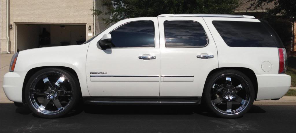

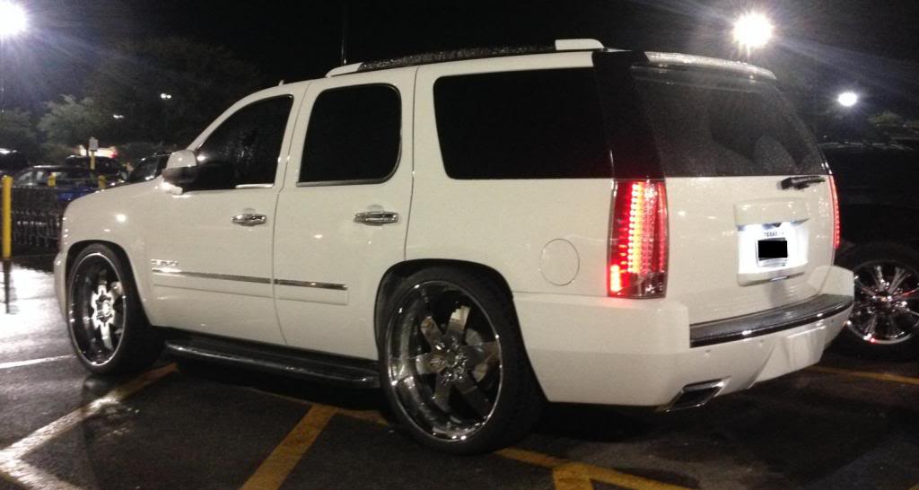

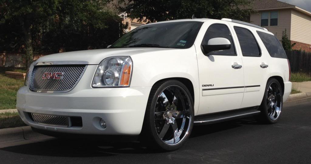

Well close to a 3/6 at least. The truck isn't clean and it rained right after taking these pics... but I'll post more once the weather improves.
Fender lip measurements on 305/30/26 tires are:
Front 33 3/8"
Rear 34"
The kit consists of:
Front - Bell Tech spindles, McGaughy's coil re-locators set at 1"
Rear - NORCAL SS 6" springs, DJM rear hardware kit

I see you have 305 tires as well. How is the rub?
Looks great btw.
iwaslowr
iwaslowr
ɹǝqɯǝɯ ɹoıuǝs
May 4, 2009
1,640
33
Austin, Tx.
The "rub" is gone... For the most part. A hammer, mallet, and removal of the front fender well liners did the trick...
