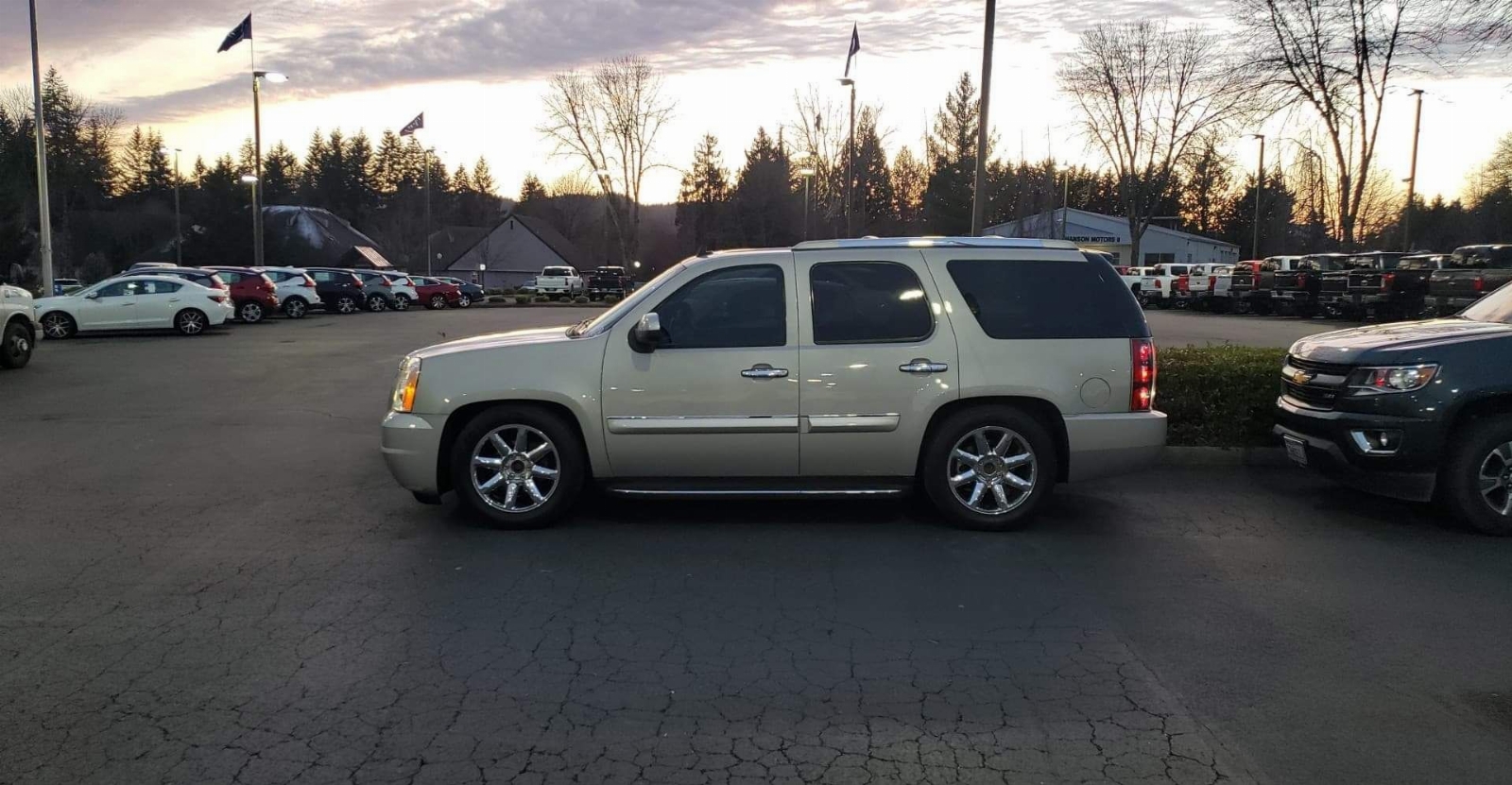

Before:
Measurements: Front 35.5" Rear 37" from ground to fender

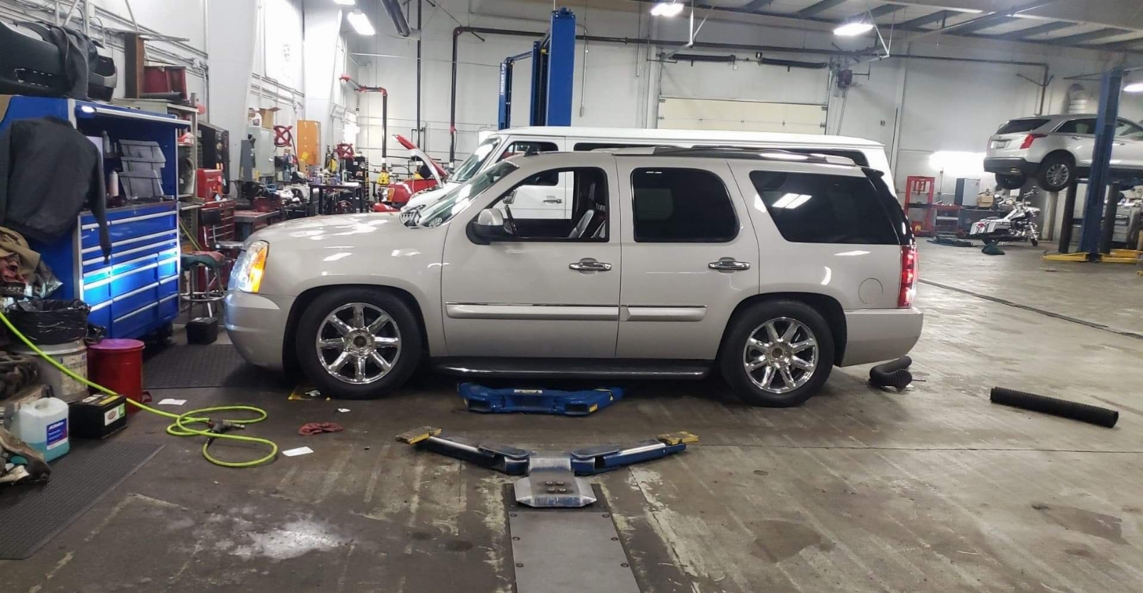

During:

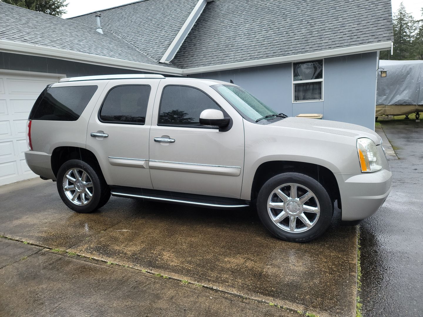

Finished:
Measurements: Front 32.25" Rear 33.5"
I will attempt to get it all cleaned up and have some proper photos taken later this week with all of the spring blooms out, but I got it back at sunset last night and am at work today. It does have room to come down in the front and initially it was lower when putting the drop spindle in with the coil over, but cranked the coil up as far as it would allow for to give a more uniform look to the rear. I may or may not consider the 6" drop spring at a later time, but we will see... As for initial impression for driving... holy s@!t!!! feels amazing going around roundabouts and corners now. Completely flat throughout and does not have any roll whatsoever. I will have to get used to the bounce a little now as I cannot tell if it is just "that firm" or if it is a combination of being a firm ride and me being used to a shot and worn suspension from prior to the work. Regardless, I am very happy with how this has turned out.
