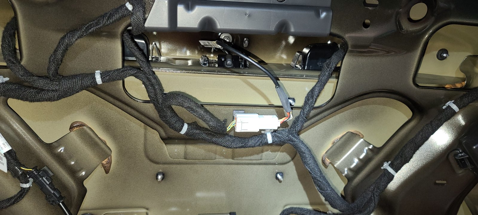

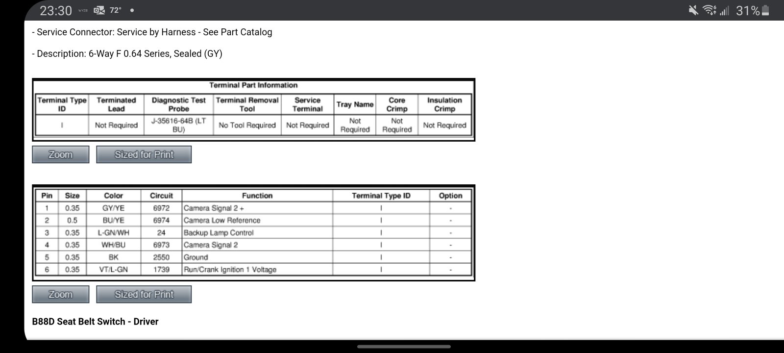

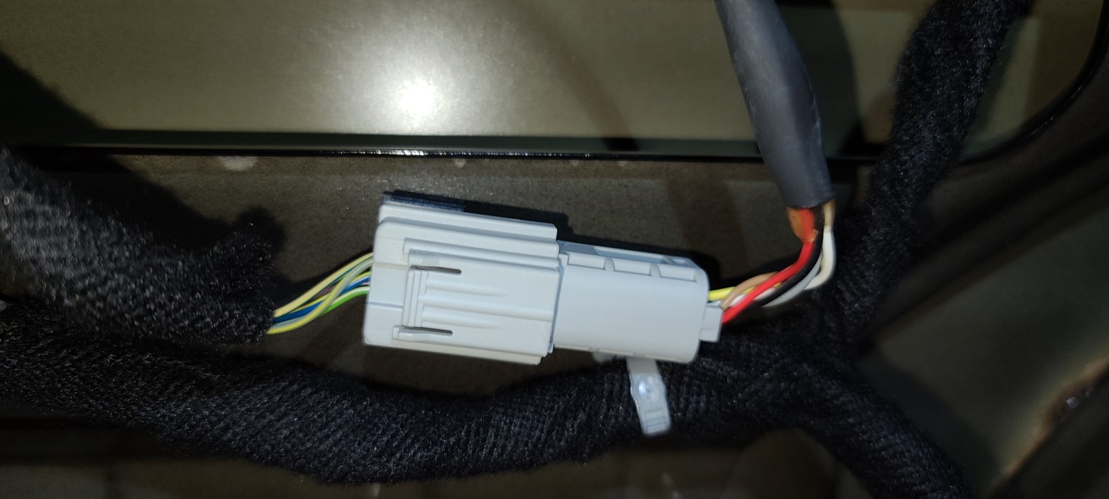

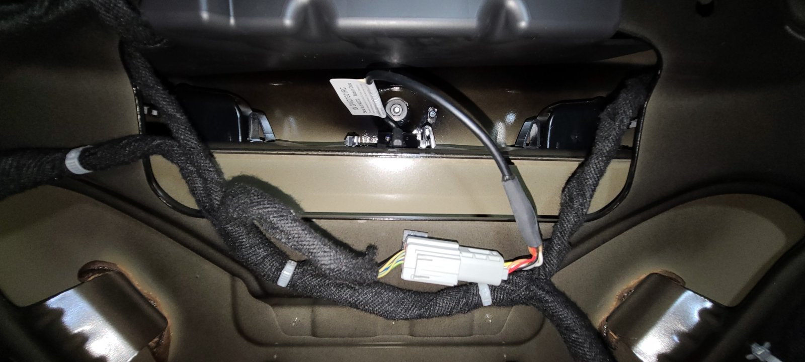

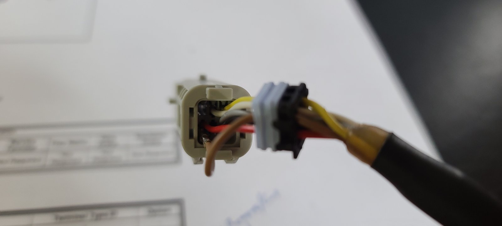

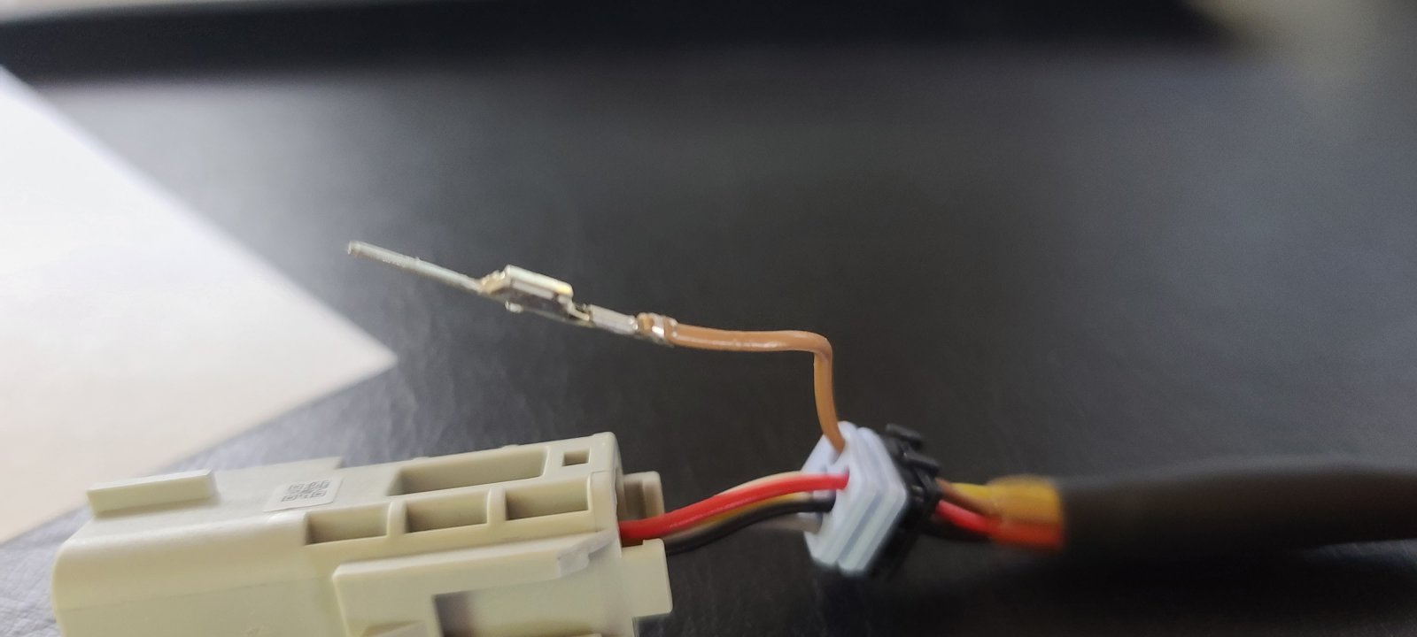

Yes. I had to make a custom harness. The Yukon's have a slightly different wiring setup. I bought another harness for the rear hatch off ebay to sacrifice as well as another camera just in case I "biffed" up. Hacked it up and soldered and landed the pins so that I now have the camera operational while in motion. Unfortunately, it's pretty much impossible to find the connectors available outside of getting another harness from ebay or the like. Talked with pgamboa at length sharing my info with him as well. Attached are some pics of everything. I can't remember the exact order but have a look and you'll see where I moved/spliced, etc. for making the new harness adapter.... hopefully.
