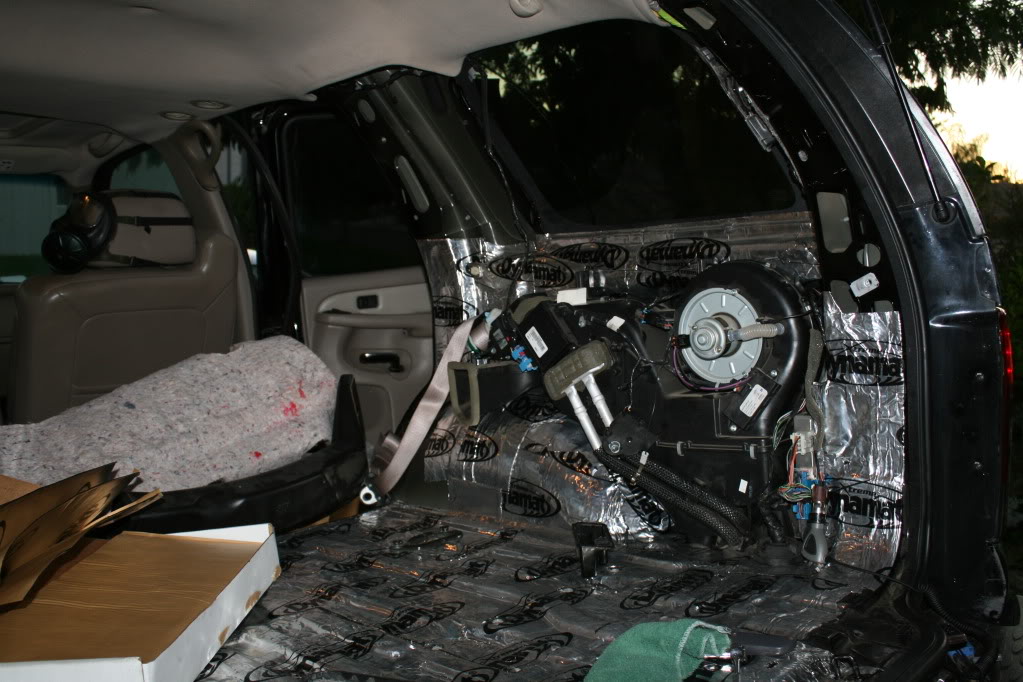

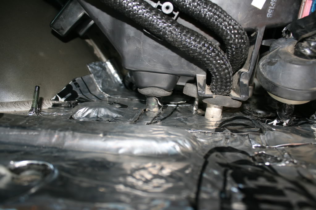

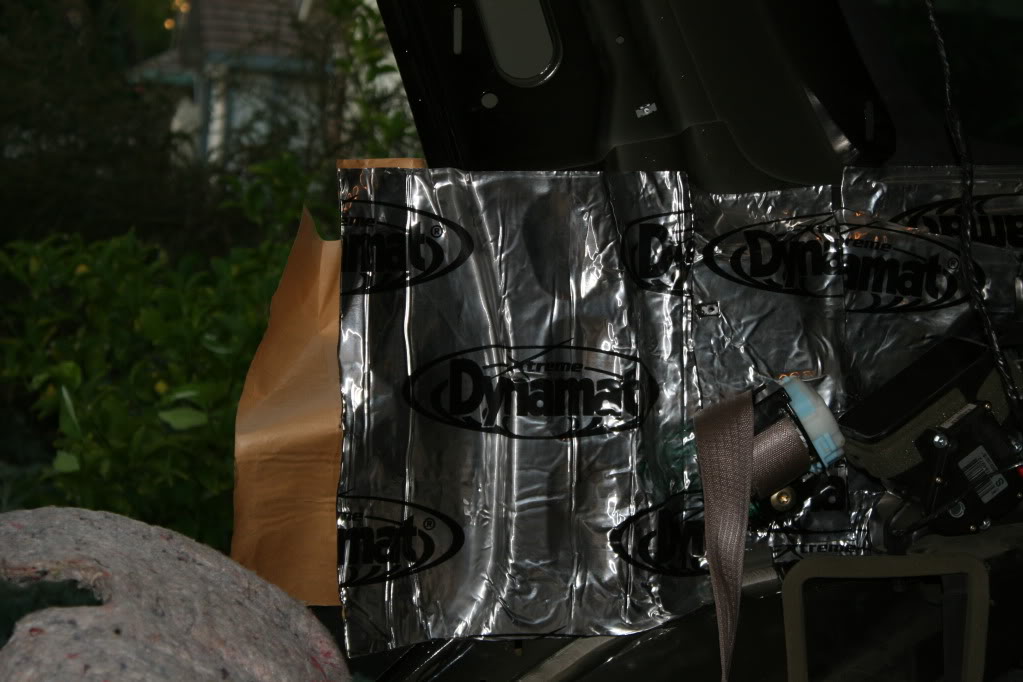

I just took the front cover for the tubes leading to the upper most core, and then you get some play in with the unit back and forth. Also remove the rear a/c fan, it will have a hole straight to the other side. Don't remove the unit, I got everything by pre-peeling 10" squares and carefully tucking them behind the unit and sticking them...
Sorry you are having trouble...
The top arrow is the fan, and bottom arrow is where that tube support is held down....
---------- Post added at 08:06 PM ---------- Previous post was at 08:01 PM ----------
Oh, and it helps to remove all the retaining clips around the unit, so the two halfs can move somewhat independently of each other...

no...they are preformed metal tubes with the rubber sections here and there...but I was able to move the system enough to get my hands in there and lay the dynamat...Im finishing the lower wall section right behind it...Im taking pics...so I'll post when Im done :)

Releasing AC unit from wall
Nuts holding the AC unit down
Under the AC unit

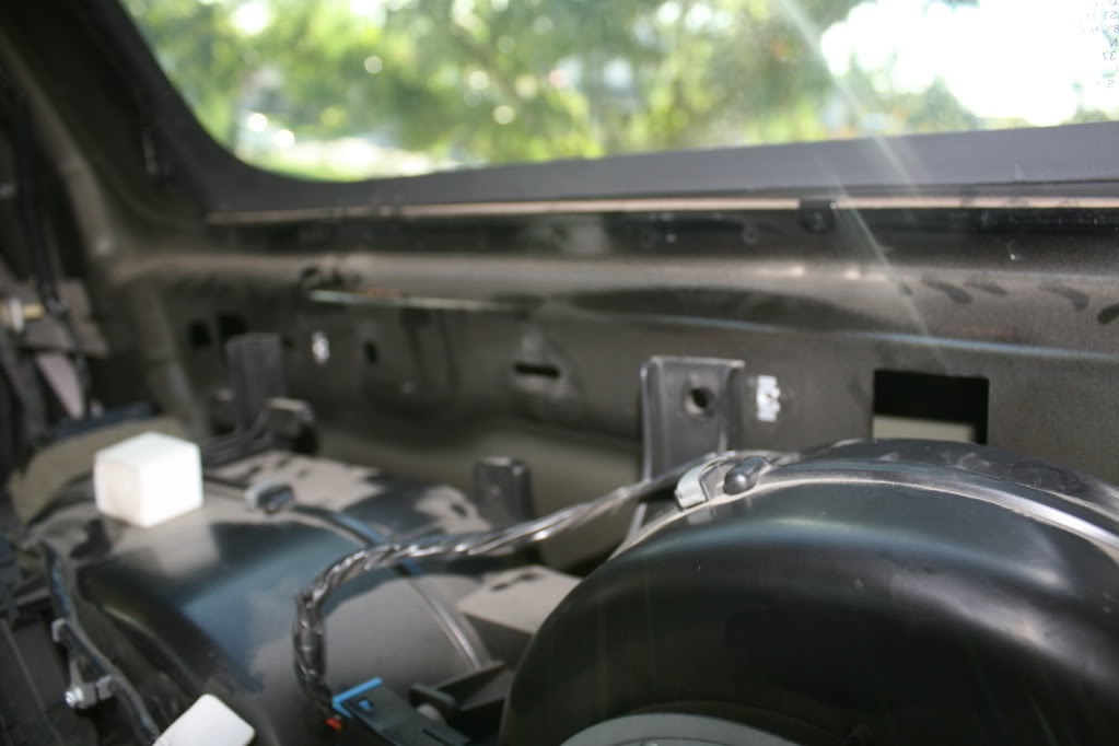

Behind rear AC unit (between AC and Wall)
Unbolting seat belts for complete coverage

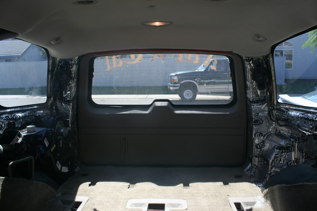

Slept from like...8:00PM to 10:30PM...went out and finished the wall at 11:00PM
AC system re-installed (bolted back into place)
I put Dynamat down then put the stock wheel-well insulation back on
