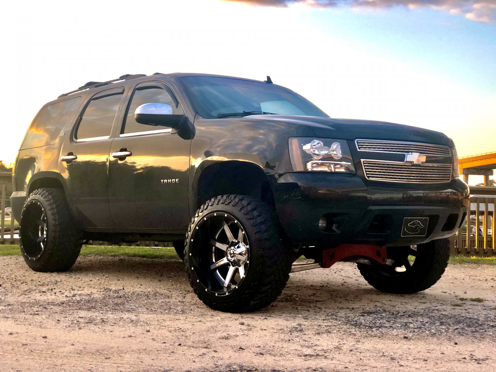

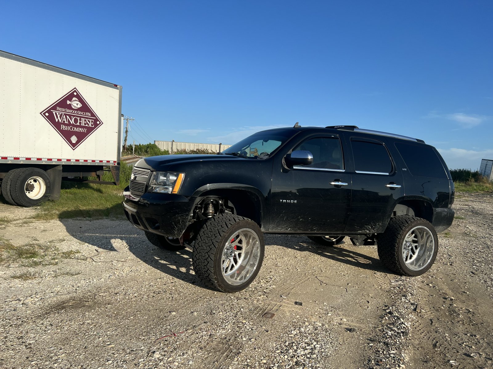

unless you run 12-14” wide wheels it’ll look goofy I’ve had 35s on my Tahoe ever since I lifted it at like 275,000 miles and now have over 400,000 and I’ve never torn my transmission or rearend out I dog the shit out of it too!
I ran 33s when I had just a leveling kit
Both of these setups were 22x14 on 35/13.50 and 24x14 on 35/15.50s
View attachment 441096you got a pic of your set up leveled with your 33's? If so let me see it.

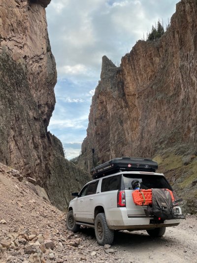

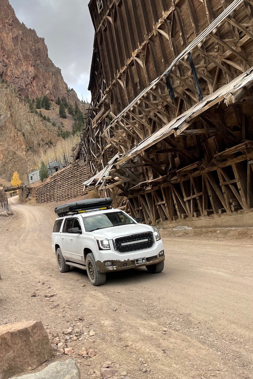

If you're really looking to overland, depending on where you plan on going, I wouldn't want a lift based on my experience in my Yukon XL. It's already uncomfortably tippy on some Colorado trails. Keep your COG as low as possible. I'm running 34x11.50 on 18x9 wheels with 20mm offset with 2" strut spacers upfront and some minor trimming. You could accomplish the same lift height as the strut spacers with good shocks like Kings and new upper control arms. I also had a Yukon with a 6" lift and 35x12.5's and would not have wheeled that where I wheel my XL.

Why I was thinking a mid size lift. However this would be my first time overlanding in a vehicle like my YUKON. Whole diferent animal than my big boy Silverado HD . So im definitely open to other lift options.
But ya I had already considered diferent upper control arms and I trust Kryptonite for all 4 of my vehicles.
But ya I definitely have some time to gather information on people's lift and or leveling with there Yukons.
The one caveat to what I said earlier is that more ground clearance would be nice, but I still wouldn't want much more if any lift height if you're going to be doing any off-camber driving.
