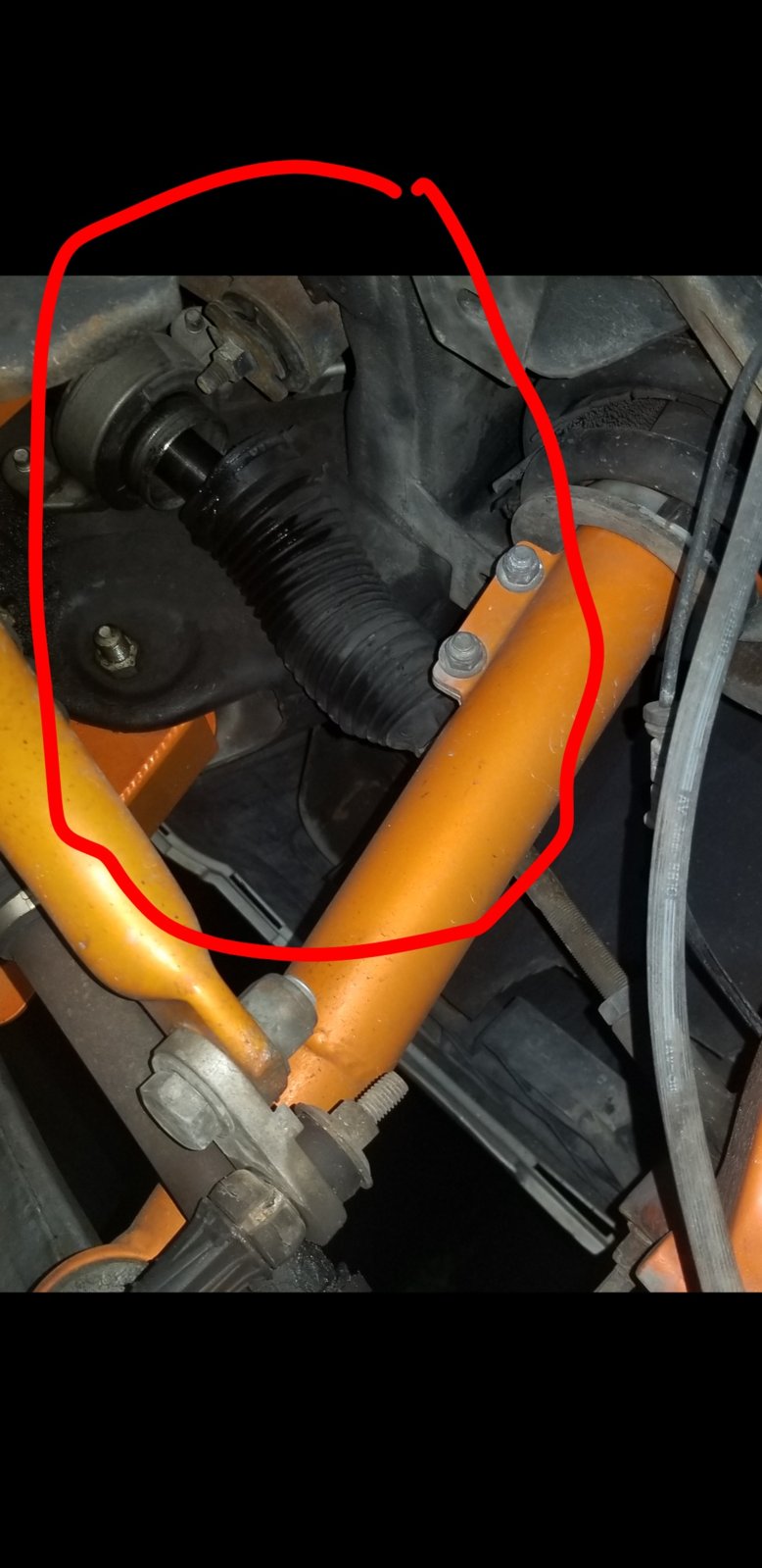

So... I hit a gnarly pothole going about 45mph tonight.. then I started hearing this wonderful sound from the undercarriage.
I got under the car and think I identified the problem but am wondering what yall think...
The sound only occurs when I accelerate and the vehicle is in motion. If it is in neutral I can rev the gas all I want and nothing...
I've attached a video of the sound while driving and picture of what I believe is the CV shaft and the cause of the sound...
Any help would be appreciated or where else I should look for the issue.
Thanks
30,773
48,479
that is a boot that has come off the rack-n-pinion, the sound i hear seems more like a hub bearing or maybe a brake pad rubbing, could even be a ball joint if it is making the sound when turning the wheels
Ok, will look at all joints in morning and see if I can see anything obvious.
I was going to do my brakes soon, and it could certainly be that... didnt even cross my mind. my mind tends to always go worst case scenario

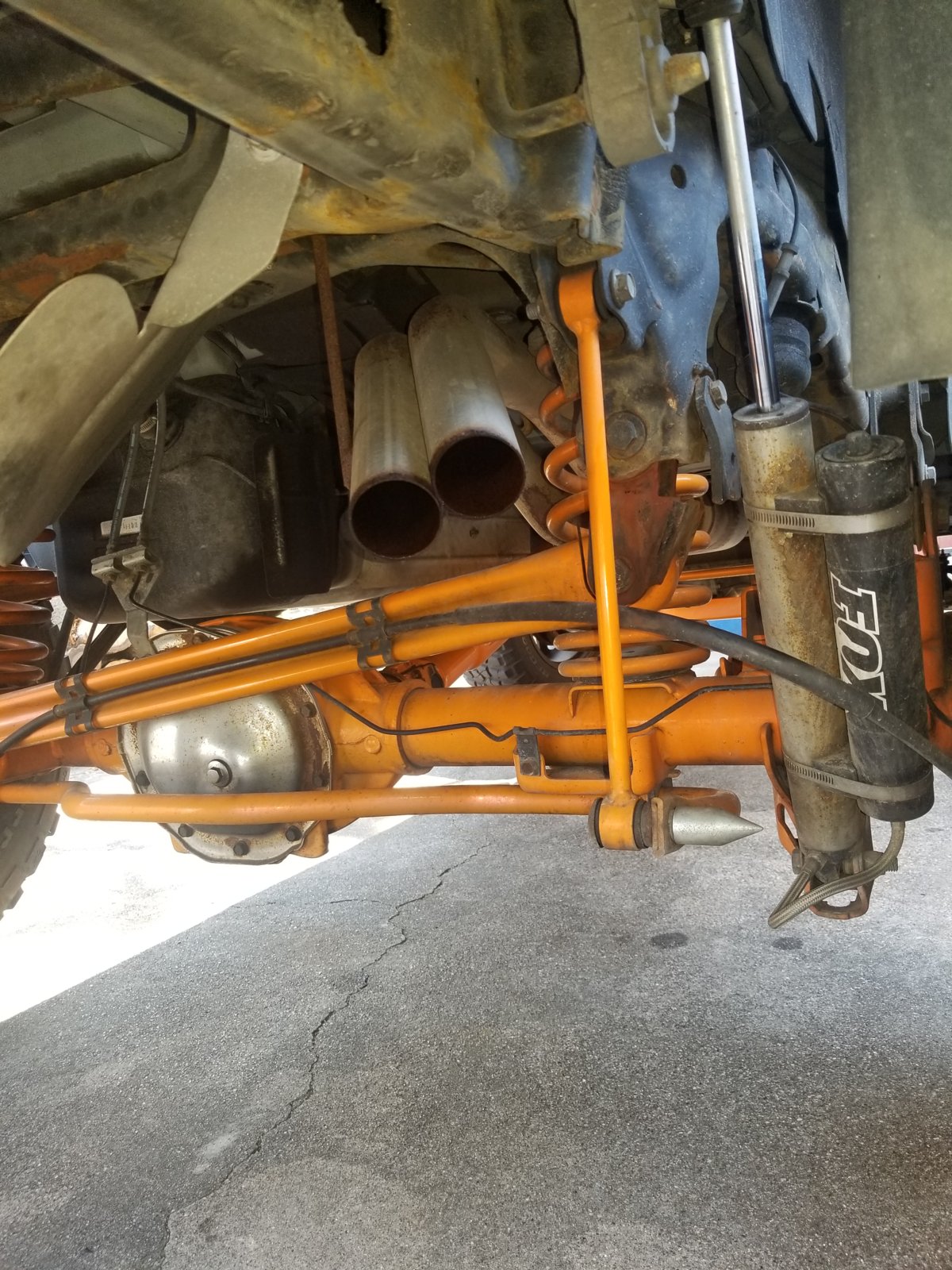

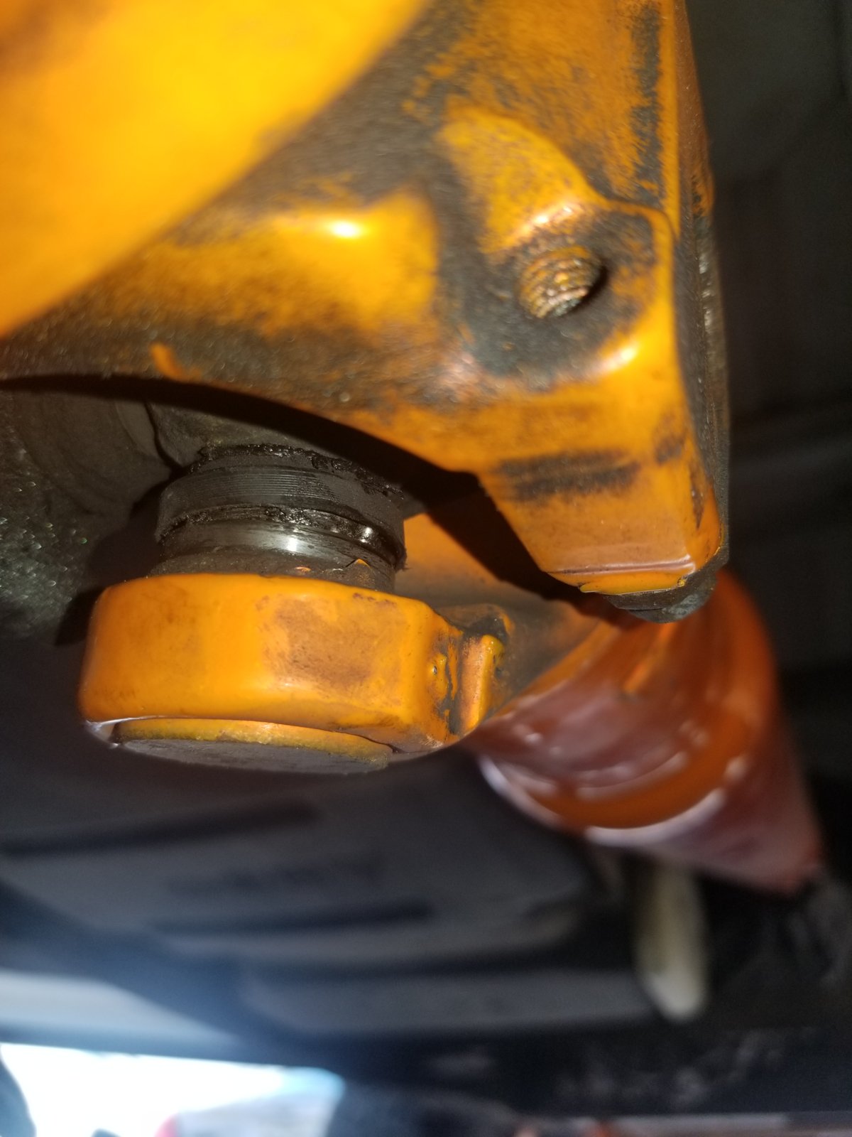

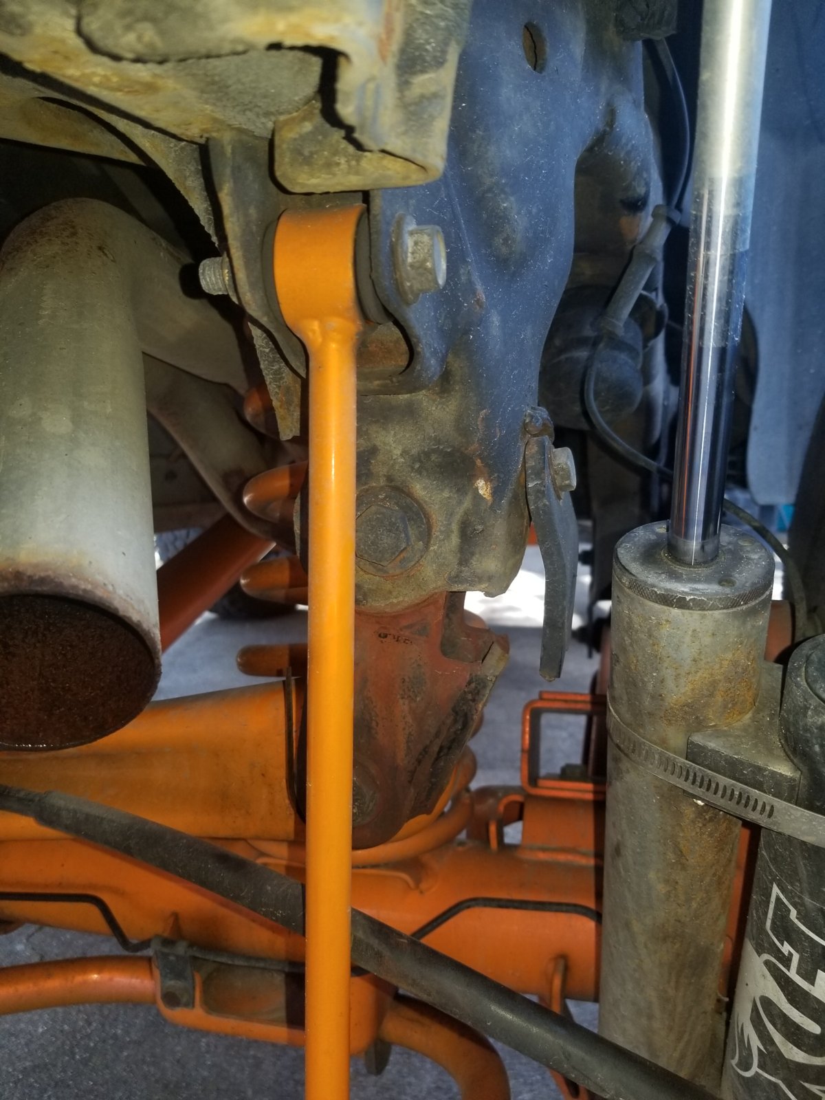

Rear u-joint on drive shaft I believe is the culprit!
And floating feeling is because I snapped bracket....
