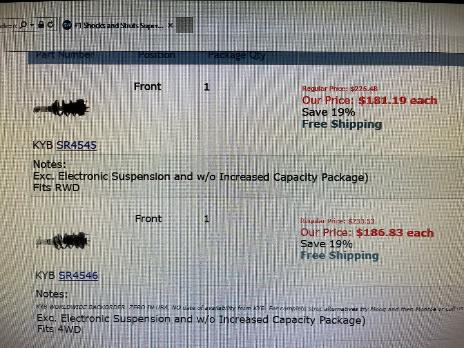

Hi guys I have a 2015 Yukon XL SLE with Max trailer package that gives rear automatic air leveling. The fronts are standard struts/springs and I don’t have Magnetic Ride. I wanted to go with a KYB quick strut that comes fully assembled and ready to bolt in. Anyone know the correct part # for the KYB’s? sr4545 or sr4546 seems to be the ones to choose from but it said “without electronic ride” and “without increased capacity package”. Is that the same as the tow package? Why wouldn’t it work if that is the case? Did they change something in the front end with tow package as well? Thanks

Thanks. Funny thing is this website says about the 2wd and 4wd but other websites don’t mention it and actually say the sr4545 are for 4wd. Here’s my Vin#.

Frnt struts GM#23276075
Rear GM#23276087
Thank you. I’d need to order the complete set up to be assembled including spring with all new rubber and top mount etc. I don’t believe it’s sold thru GM as a complete assembly. Can I order directly through you?
