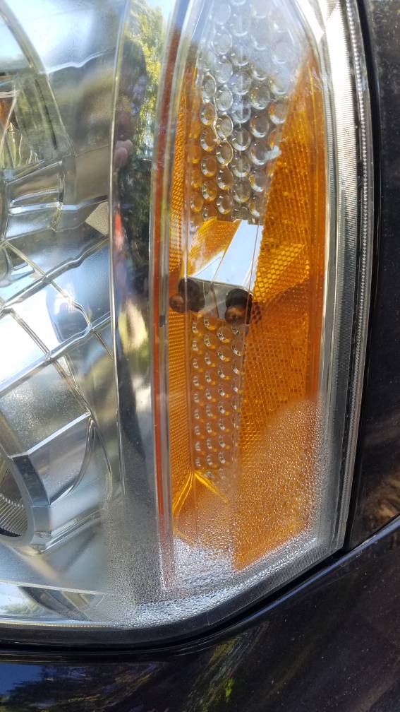

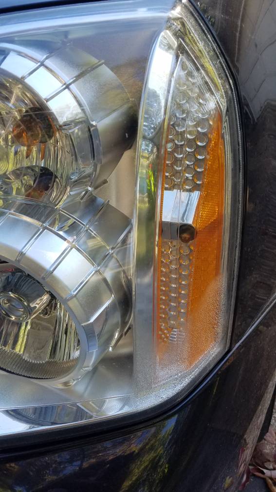

Never seen any moisture in the headlights since I bought this about 2 months ago. This moisture is in the lower outside corner of the drivers headlight and just appeared today. The weather here has gone from 80-mid 90s last week to 30s-40 at night and 50s-60 during the day this week.
Is a littl moisture now and then OK or should there be none at all, all the time?

Should be 0 moisture in any lens.

You think whats pictured is going to be a problem? I still have about a month left on the 3 month warranty the GM dealer I bought it from gave me. There's a $100 deductible on it though, and I haven't found anything else wrong or not working.

You could try drying them out then running a thin bead of silicone around the entire lens, and just for good measure put some dielectic grease on the gaskets, where the bulbs twist and lock into the lens.

I think so, yes--it can and will get worse if you don't address it now.
