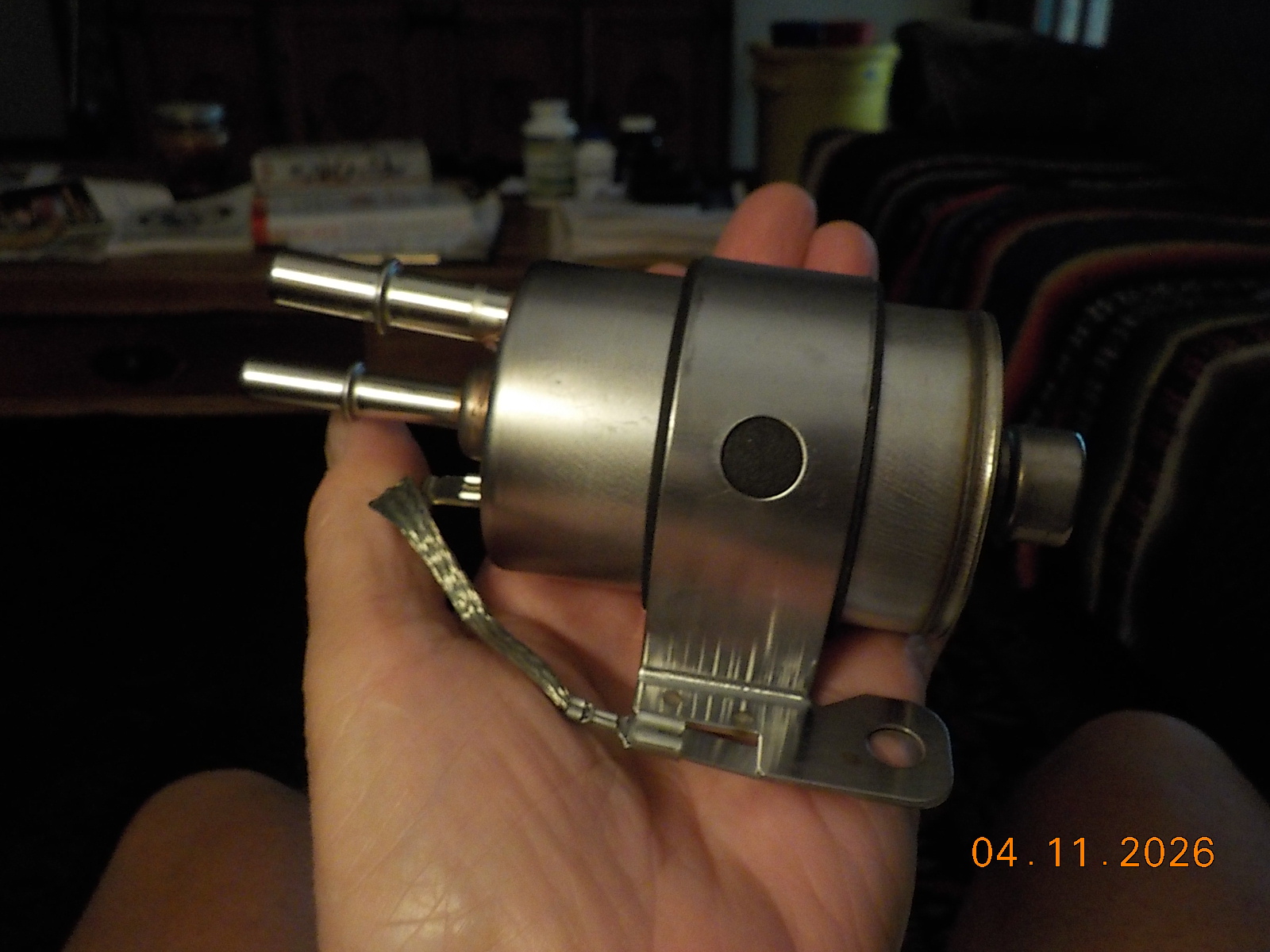

My 2002 LS1 Corvette has what they call a "fuel filter/regulator".
On the south end of it there is an inlet and an outlet to/from the fuel tank/pump.
On the north end of it is one outlet to the engine.
NAPA Gold #3737, same as GM# 19239926 or ACDelco# GF822
yes, this thing.
it's kinda works like a returnless system by having only one fuel line run to the injector rail. but really it's just a regulator mounted in the back and takes place of the old school inline fuel filter. even though I believe it has a filter in it too.
a true returnless of the newer vehicles have no mechanical fuel pressure regulator anywhere in the system.
