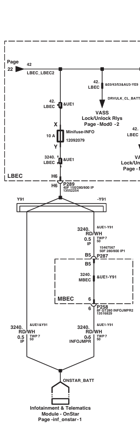

Guys, I have a draw that happens randomly. Sometimes if I leave the truck parked it'll drain the battery in 2-4 days, other times it'll be fine for a week or more.

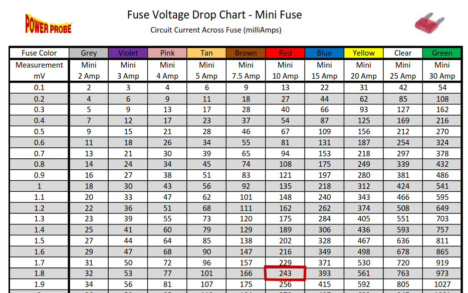

New alternator and charge cable, replaced the agm battery twice. I've now done a full parasitic draw test and the only circuit that had mV was the info circuit, which only had 1.8mV.
Am I screwed? What's next here?
