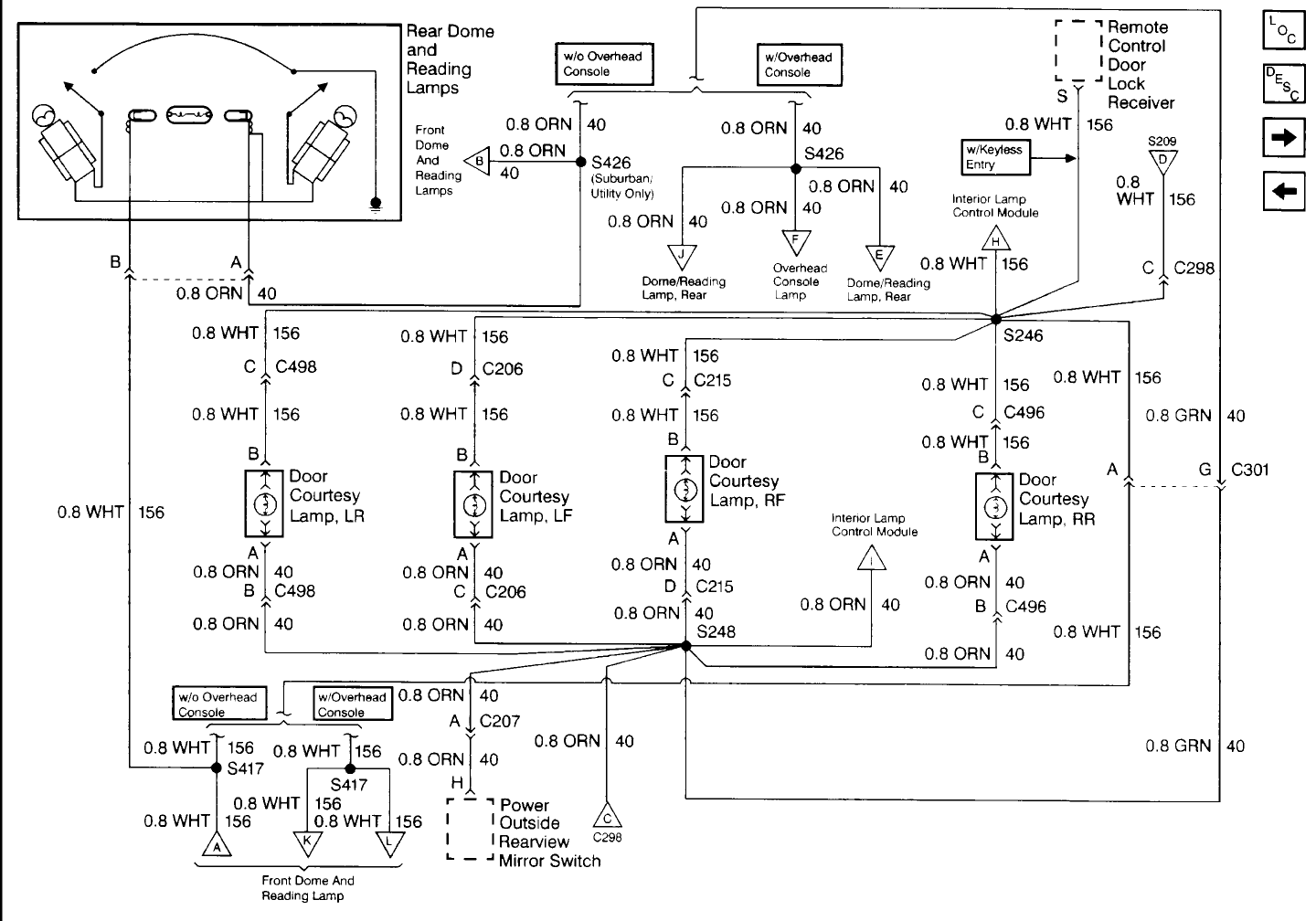

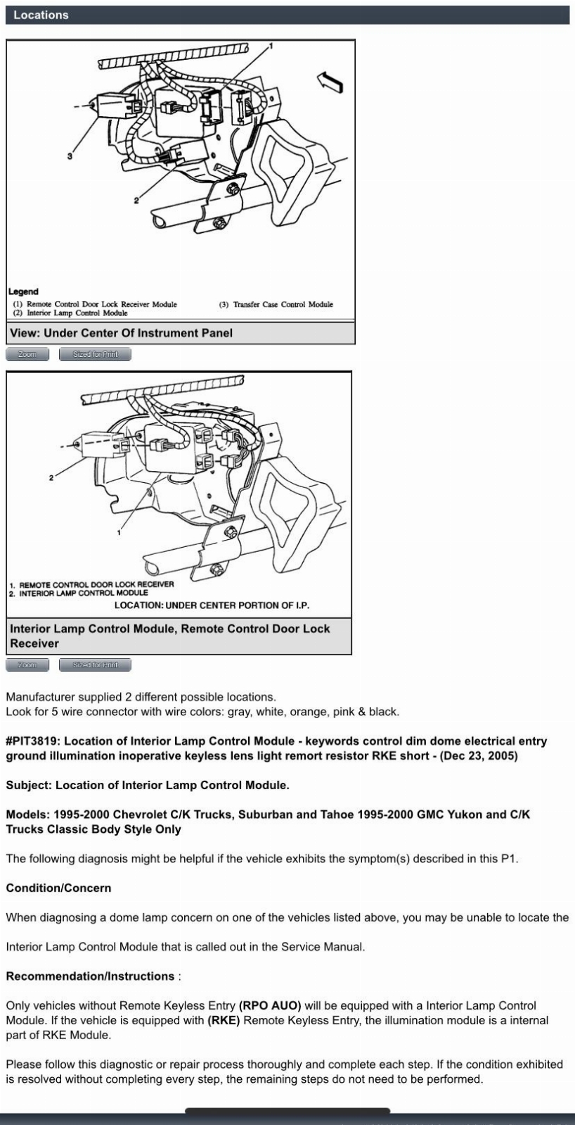

Here are the diagnostic tables for a 98, maybe it will help
358d46c265984d67cc599b032073b212.plist
6ee081ec0e355abb175ba73d040c0b25.plist
