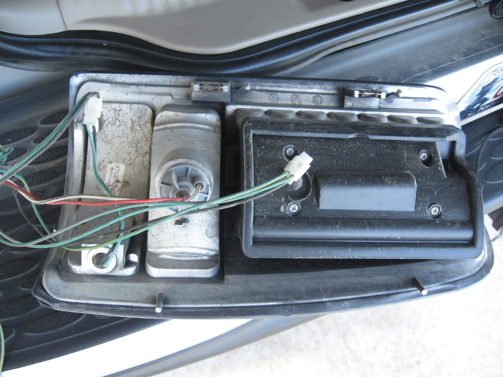

The loomed part of the harness is terminated with a plug just like the stock harness just goes under the yd to the stock plug location. I just hadn't seen LED tails with a complete wired harness yet. Sorry no pics of them lit up yet.

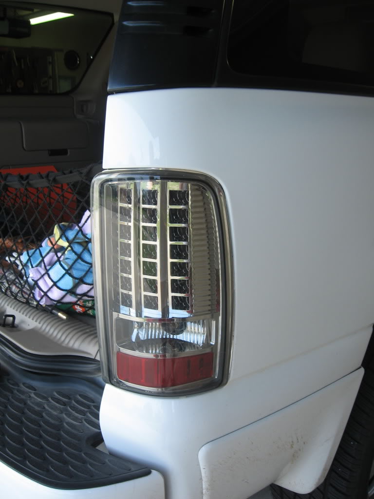

I've been running these tails (made by Sonar) in my truck for months now with absolutely no issues at all.
I had the fast blink problem when I put in the front LED's and the resistors didn't fix it. I cut the pin on the flasher and the lights flash slightly faster than stock but not at warp speed like before.

Depends on the light. If you get the Sonar brand lights, everything is wired for true plug and play. I was actually pleasantly surprised at how nice the lights are and that they don't leak whatsoever.
