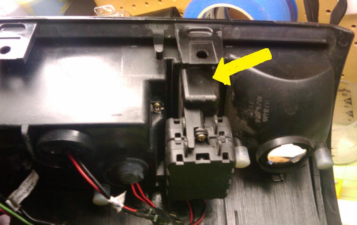

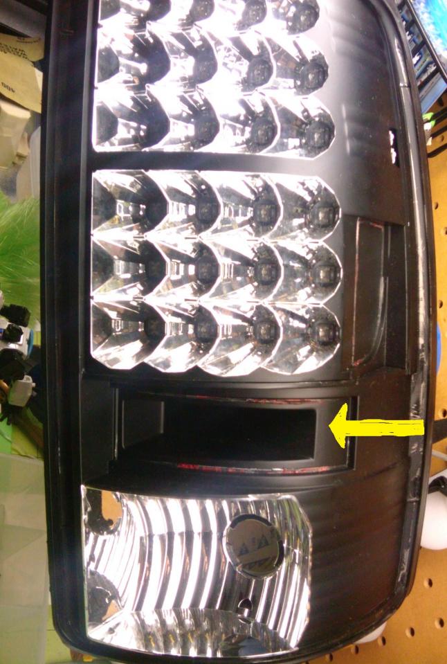

4 months ago i purchased a set of the SONAR LED lights.....Clear/with black housing....and tinted dark
these lights are pretty much the same as the majority of you have.
just 2 wks ago some 1 backed into my HOE at a parkinglot....and well they broke the Plastic covering....
I always wondered about the rectangular red piece on the housing....y it didnt light up.........turns out its nothing but empty space.......but yet there's enough space to maybe put in a small light..
question is....which light should be put there..and where would it be wired from?
it can be used as an extra brake light or turn signal..

robb.
Oct 10, 2009
65
dallas
doesnt reflect much of anything ....especially if the lights are smoked.......so lets put it into some good use

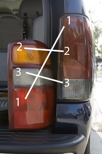

How to install your LED Tails.
We had a nice little thread on TF, and I figured I'd make a new one since the tails don't come with any instructions.
For this model, they have a clear version and a red version. Both come normal or smoked.
When you install your taillights, I would suggest numbering you light sockets and writing the corresponding # on the housing, just incase you need to install your old tail and to make things easier.
There are two metal clips that the screws catch on. These are located on your old taillights. You will pull these off, takes a little muscle and prying. But be careful, so you don’t break the plastic on your taillights.
When you hook up the harness' you want to follow the order above.
The Running lights/Brake light will be at the top.
The Blink will be in the middle.
The reverse light will be at the bottom and you will use the bulb for this.
If your lights aren't working check your fuses under the hood. I had a problem with my brake light switch, and it needed to be replaced.
(Don't remember his name off the top of my head, but on TF.com he had a little wiring diagram to have both the blinker and brake light to work in unison like the esky lights) Hopefully he'll join up and chime in.

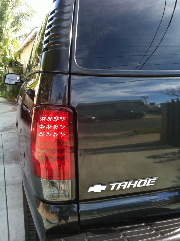

question.....
i bought the same led tail lights u have for an 04 tahoe.
once i installed them.... my turn signals were flashing rapidly. and my parking lights werent turning on, just the brake lights... any suggestions? thanks.
btw, i didnt follow your diagram above... i actually used the urn signal on the top and brake in the middle... could this be the prob? thanks....
bkboatnsleds
Nov 13, 2009
936
McHenry, IL
Could be the problem - also make sure the black wires at the plugs line up. I have same ligfhts w/ no issues.
mando2776
Sep 21, 2010
66
Van Nuys, CA
thanks bkboatnsleds... problem fixed..... i did line up the blk wires...
didn't wanna blow the fuses. i did use the diagram above and connected the turn signals to the middle plug. looks great and works perfect...
