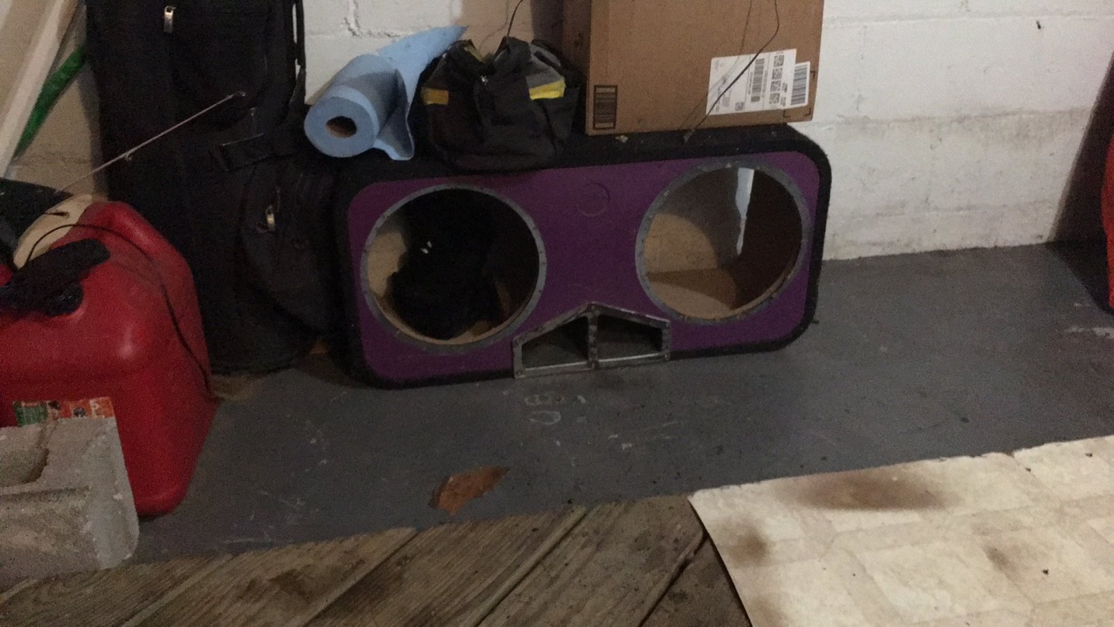

I installed 8” touchscreen, backup cam, and have had 2 industry Titan 15’s in the back. No 3rd row. I did however build a box for twin 12’s that fits between the 3rd row and hatch(Non XL), that sounded pretty good. As of now, picked up a third car, so the Tahoe is now my Hoe. ;)
