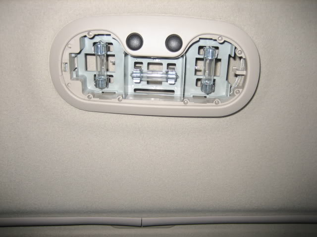

This is what the 2nd row/rear dome lights look like. The two outside lights were replaced with 4410 (not shown) and the center light was replaced with 4210 high powered (not shown)

2nd row/rear map lights (each dome light has 3 bulbs - 2 outside map lights that you turn on with the button, and one middle dome light that comes on when you open your doors. Check out my last pic above to see what I'm talking about. Like I said, I dont think they are that bright, so you might want to go for the high powered ones, which are a tad bit more:
4 X 4410-x9 LED Festoon bulb | $ 4.74 |
Cool White 4410-CW9 2.25
2nd row/rear dome lights (middle bulb):
2 X 4210 High Power LED Festoon bulb | $ 14.95 |
Cool White 4210-CWHP6 7.00
