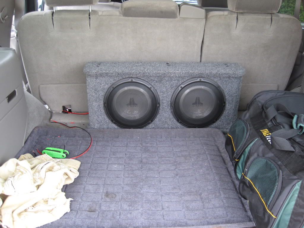

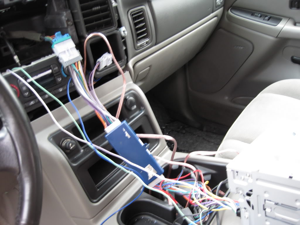

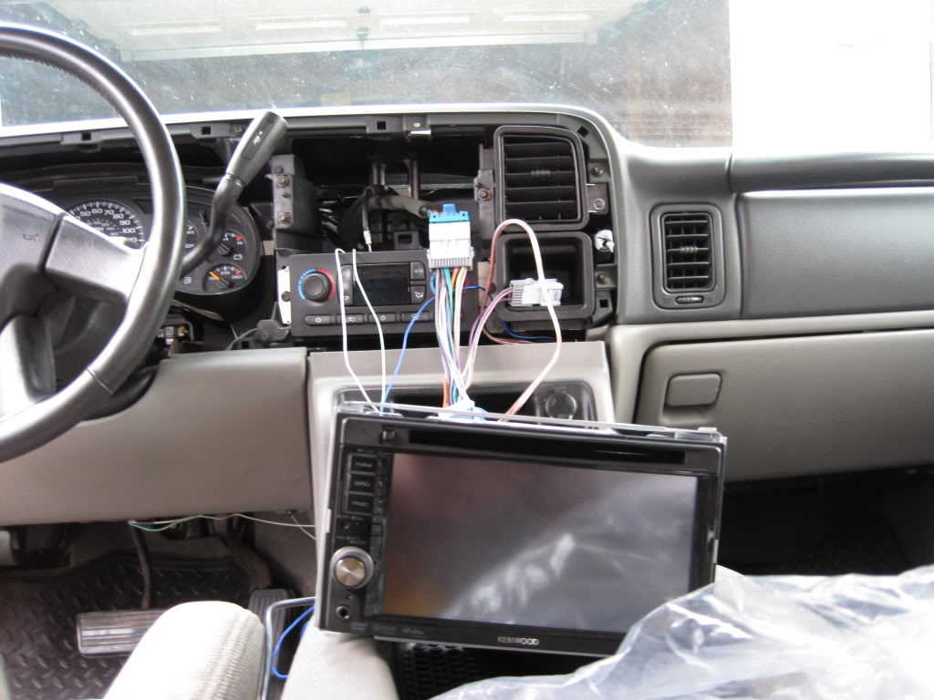

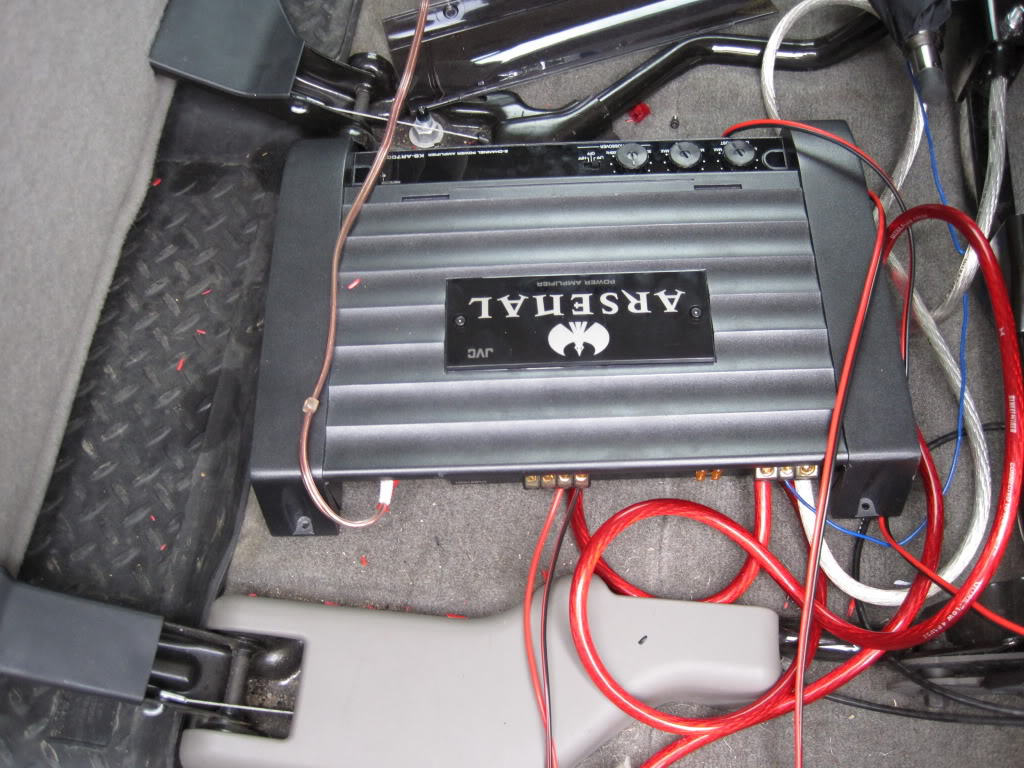

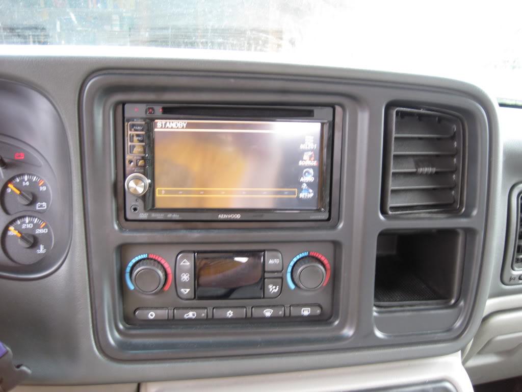

Update: Everything hooked up and buttoned up! Took a few pictures:

is the blue box for the steering wheel controls? if so how many wires did you have to connect to it?
oh wait I just noticed that you dont have any steering wheel controls
gmcjohn
gmcjohn
Oct 21, 2009
192
It is actually for the Bose system and steering wheel controls. I don't have steering wheel controls as you noticed, but if I did the same adapter would have worked. It's the PAC-GM bose. It runs about $65-$75 depending where you get it. All in I soldered 36 wires together so that means 18 pairs. You can do all the soldering outside the vehicle if you're smart. If you forget about the Amp power wire like i did, then you have to do that in the car. I got the head unit for $365 with a 5 year warranty- it was a steal!
