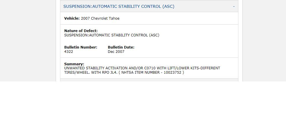

you guys are way off theres a techincal service bulletin from gm on this problem.
seems to be more comomn on the 07 modles. its not noticable untill its been lowered
had the same problem on my 07 avy when i first droped it
document id is
1920299
1702043
1672489
from what my local service rep told me is that theres a sensor under the drivers seat that is supose to sense if the vehicle is going to roll over and ingauges the brake, i noticed it on sharpe turns and if you brake at the same time the pedal bobles back and forth. my local dealership corrected the problem and i never had it since then

I just found this TSB (pic below)!! I called my local dealership and i'm taking mine in in the morning to get fixed.
