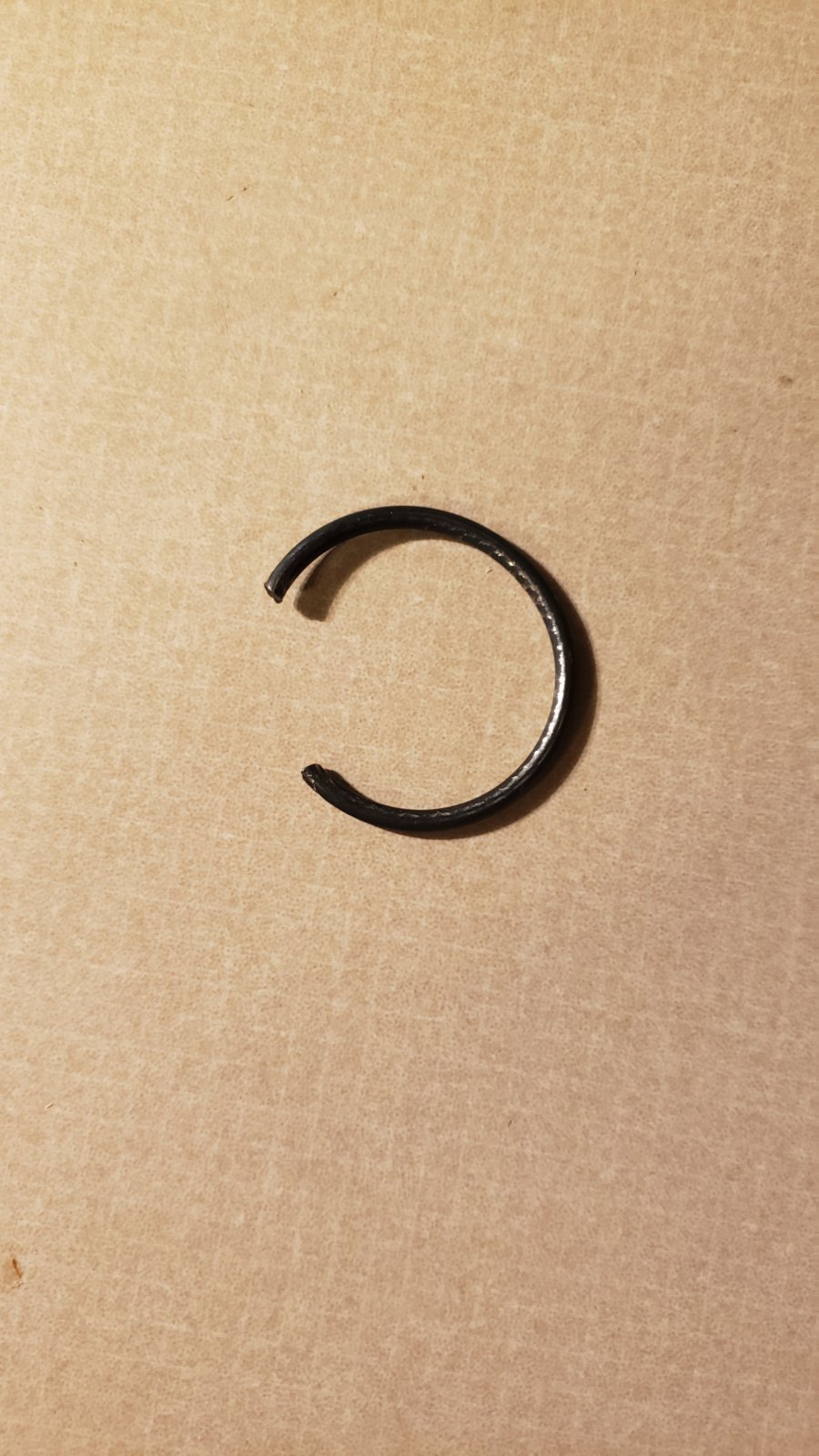

@Fless in that first picture the shaft definitely isn't centered. I can hold it up and push in and feel it touching something and kind of eyeball it to where it seems to be centered. But when I took the picture it was in a spot where it really has a quite of play (the radial and axial play inwas referring to).
I did not compare the new cir clip to the old one. On observation I made though was that the new cir clip fit fairly snug around the shaft. There was no squish to it where it would compress to go through a bore. Could the wire diameter of the cir clip be a little big and causing issues? I don't have the new cir clip with me to compare to the old one, but I'm thinking going and picking up another new one. I can compare those. But I got the first one from the local GM dealer. The guy looked up the part from my VIN.
@George B I wish I had seen your comment before I pulled the shaft. I had already left though and gone back home for the week.
Couple questions though. Does the orientation of the needle bearing matter for the shaft and cir clip to fit through? The cir clip that I have now has gotten a bit beat up from me trying to knock the shaft in so I'm figuring getting a new one. Should I be at all concerned with the needle bearing?
