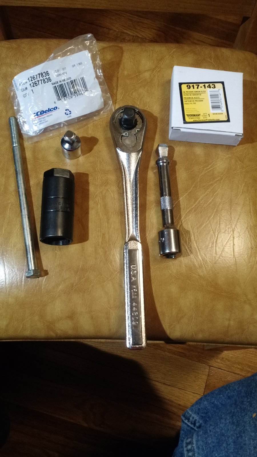

Welcome to the club.. ME.... not sure if it was related, but today after a pretty hard acceleration(harder than normal, not 100% throttle) I found myself
with 0 pressure reading, and a "low oil pressure stop engine" DIC message. Engine quiet, I pulled over and listened, had my boys with me so I drove home 2 miles to get another vehicle.
No signs of oil loss, levels good, oil looks good and clean. changed the oil about 2000 miles ago with Mobil 1 and I think a K&N filter.
Parked now at home Oil gauge will move slightly if revved up.. engine sounds normal.
I'm aiming at oil pressure switch and the little filter with it as first line.
Although I may change oil/filter first to see if that has effect.
Would love to hear feedback, hope it's not the o-ring because that will have to be a shop job for me, don't have the time or tools for that one.

Well it was the Sensor/Filter Being I wasn't getting any reading at all, most o-ring failures will at least show a little pressure when cold.
and this was the cheaper start(because if it comes down the o-ring job, I'll have to pay someone, I don't have the patience, tools or time for that one.
Going to add a couple pictures of the tools needed, and my yucky filter.(I'm guessing my driving it really hard, loosened up some gunk in the engine)

Yes probably but the plastic on the original sensor was so brittle that it broke off when removing it...
