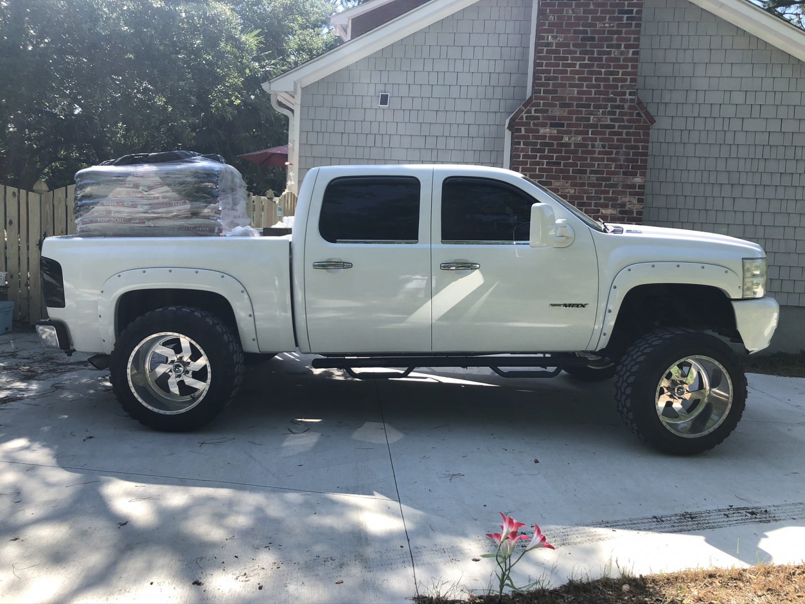

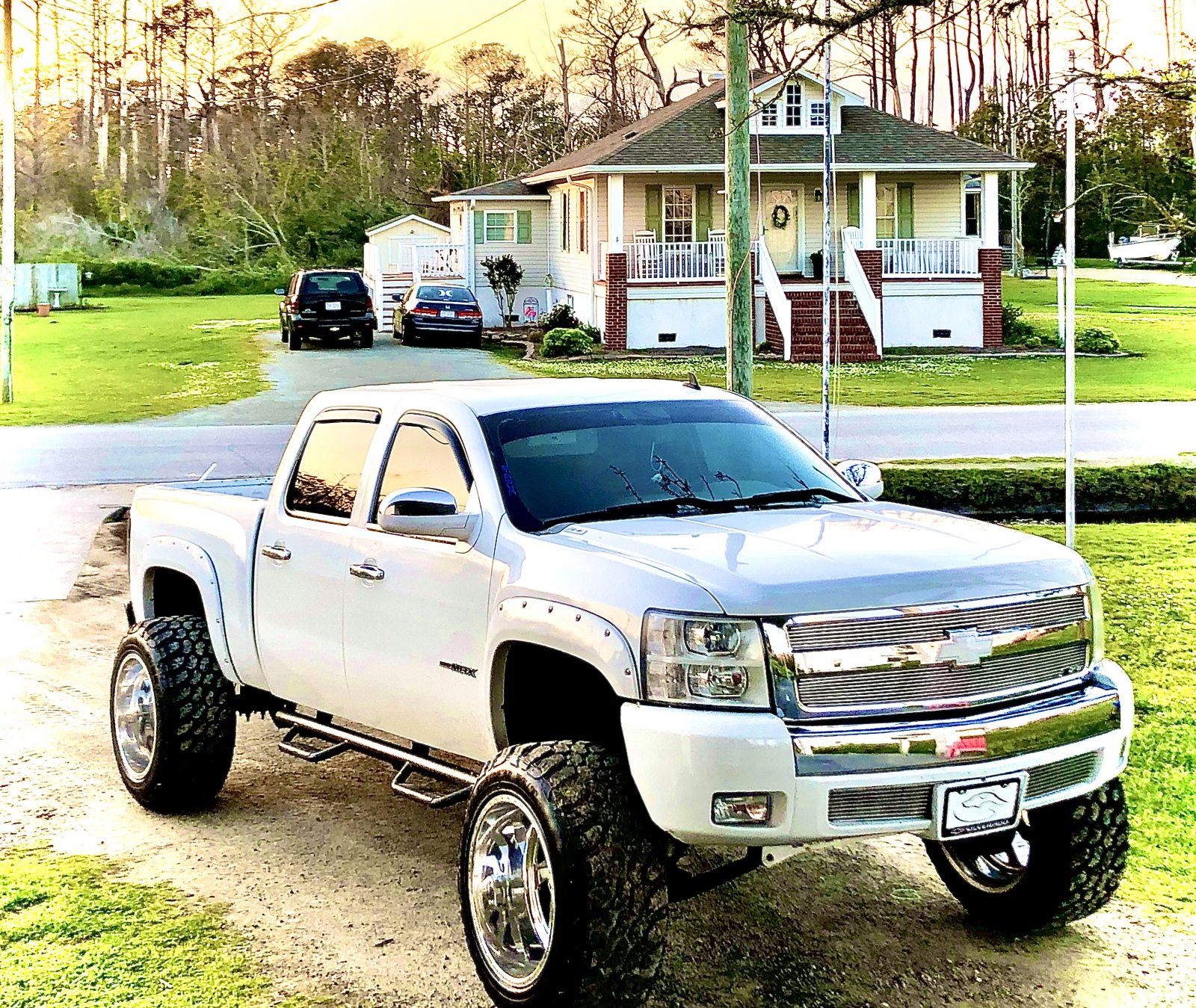

Don’t be scared of spacers they ain’t nothing dangerous I’ve ran em on every truck I’ve had in this pic I was running Amazon specials 2” wheel adapters with 2” wheel spacers stacked for a total of 4” of spacers per wheel with 22x14 -76 offset wheels and 37/13.50s run 70-80 everywhere I go driving hours on end for work just make sure the lug nuts are tight and check from time to time but I’ve never had one come loose before
Here’s a pic with some weight on them
