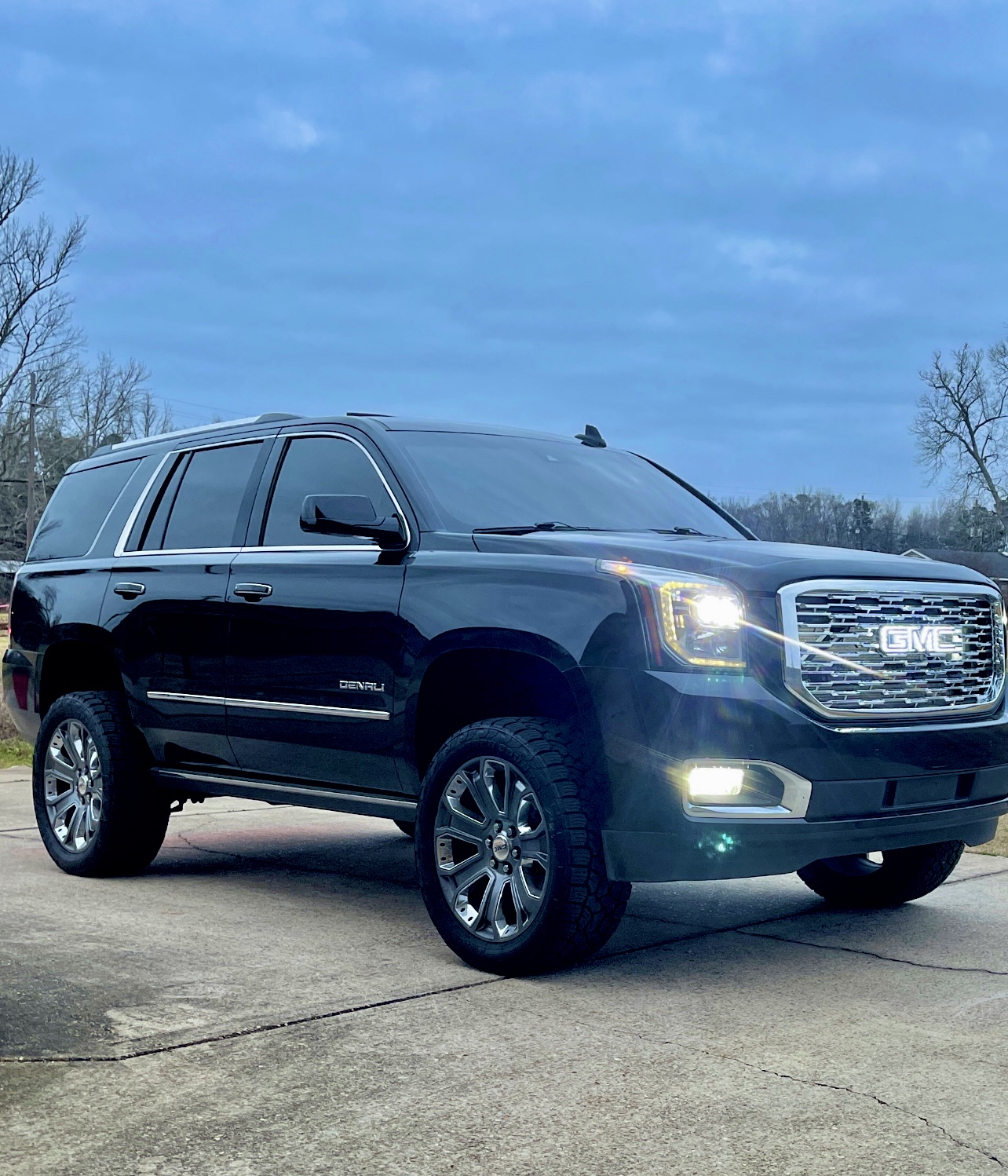

So I recently added a illuminated emblem to my 2015 GMC Yukon Denali. I was wondering if at all possible to match the color of the DRLs to the 6500k emblem? I haven’t had much luck looking online as they all seem to have poor reviews.
Anyone have experience changing the DRL inside the headlight assembly? And if so what brand?
Any responses would be appreciated.
Thanks

Where did you get the emblem?
I made it and am regretting not getting the color to match the DRLs. So I’m wondering if there is a way to change the DRL light strip inside the headlights. Any thoughts on this?

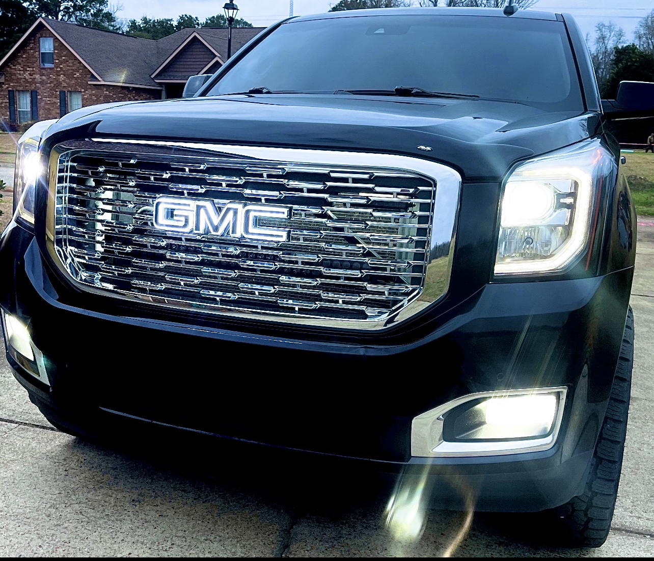

how did you make it?
It took a lot of trial and error but I figured out the best way was to buy some stock acrylic sheets and use my CNC machine to make letters slightly larger than the GMC inserts. I soldered some LEDs to fit into the voids after removing the inserts. Then I drilled small holes for the wiring, siliconed over the LEDs, added opaque/transparent led film prior to silicone drying (all precut prior to installation), then I carefully adhered the acrylic to the flat surface of the chrome on the emblem which was the most difficult part, as it only has about 3mm of flat surface prior to curving down. After drying for 24 hours, I applied clear waterproof automotive emblem adhesive to the letter inserts and placed them over the acrylic. Allowed to dry for 48 hours, then ran all wiring into a harness that I pieced together, added a “add a fuse” connection, and ran to my fuse box.

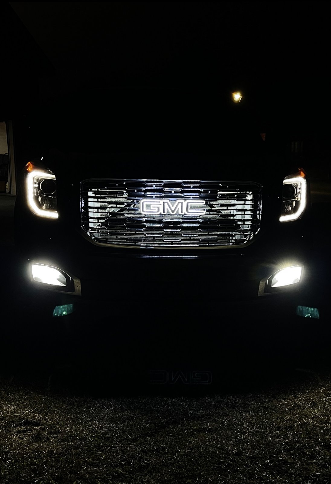

I’ll be making another one that is 5000k to match the DRL lights perfectly later this week. I don’t know what I’m gonna do with the first iteration, probably hang it on my tool box and plug it in. Lol

@Mitchell0827 You can change the LED DRL but it is very involved. As you can imagine you are opening up the headlight. The “C” shape of the LES DRL can be difficult to maintain and follow with some LED strips out there. Not all of them can bend as easy or be manipulated to follow the same shape/channel for the LED DRL without damaging the LEDs.
If you’ve ever done a headlight projector retrofit on your own I’m sure you could figure it out.
I’m confident in saying it would be way easier to remake your emblem in 5000K than to open up the headlights and change out the factory DRL LEDs.
