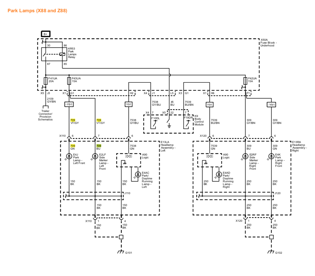

The Tahoe/Suburban LED strip is on a fuse. Here is the wiring diagram for your Yukon. Looks like that may be a relay instead.
Do you have a test light or a multi-meter? I personally would see if the LED strip is getting power. That way you can isolate if the light is bad or if there is a deeper electrical problem.
You need to test pin #6 (grey/blue drivers, blue/brown passenger)

HUGE thanks. I have a light and meter. I'll jump on testing that first thing in the morning.
So it's only one relay running both left and right (halo) led strips?
30,580
48,084
for reference that diagram is fuse # 41, 42, 43 under the hood they may not even be noted as DRL
