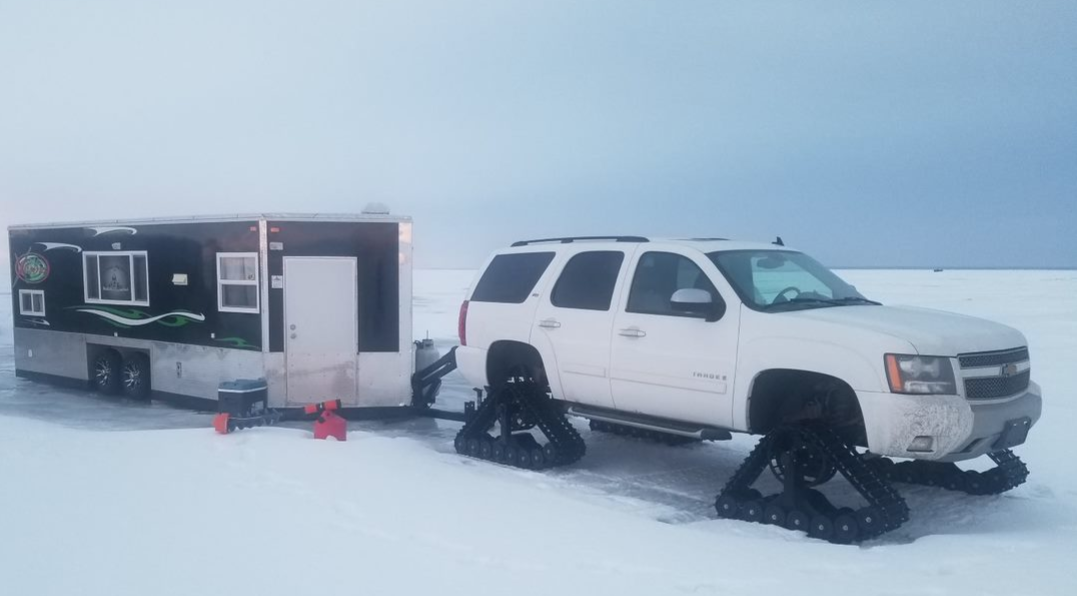

2008 Tahoe LTZ, 217k on tracks; was up on Lake Winnipeg last weekend.
I don't have a lot of time in this rig, bought the Tahoe and installed the lift / tracks right away, maybe 100 miles on it.

Love the tracks on the full size. Did you add 2x or 3x glass for the windows on the trailer/beer cooler? It looks like a hell of a good time.
