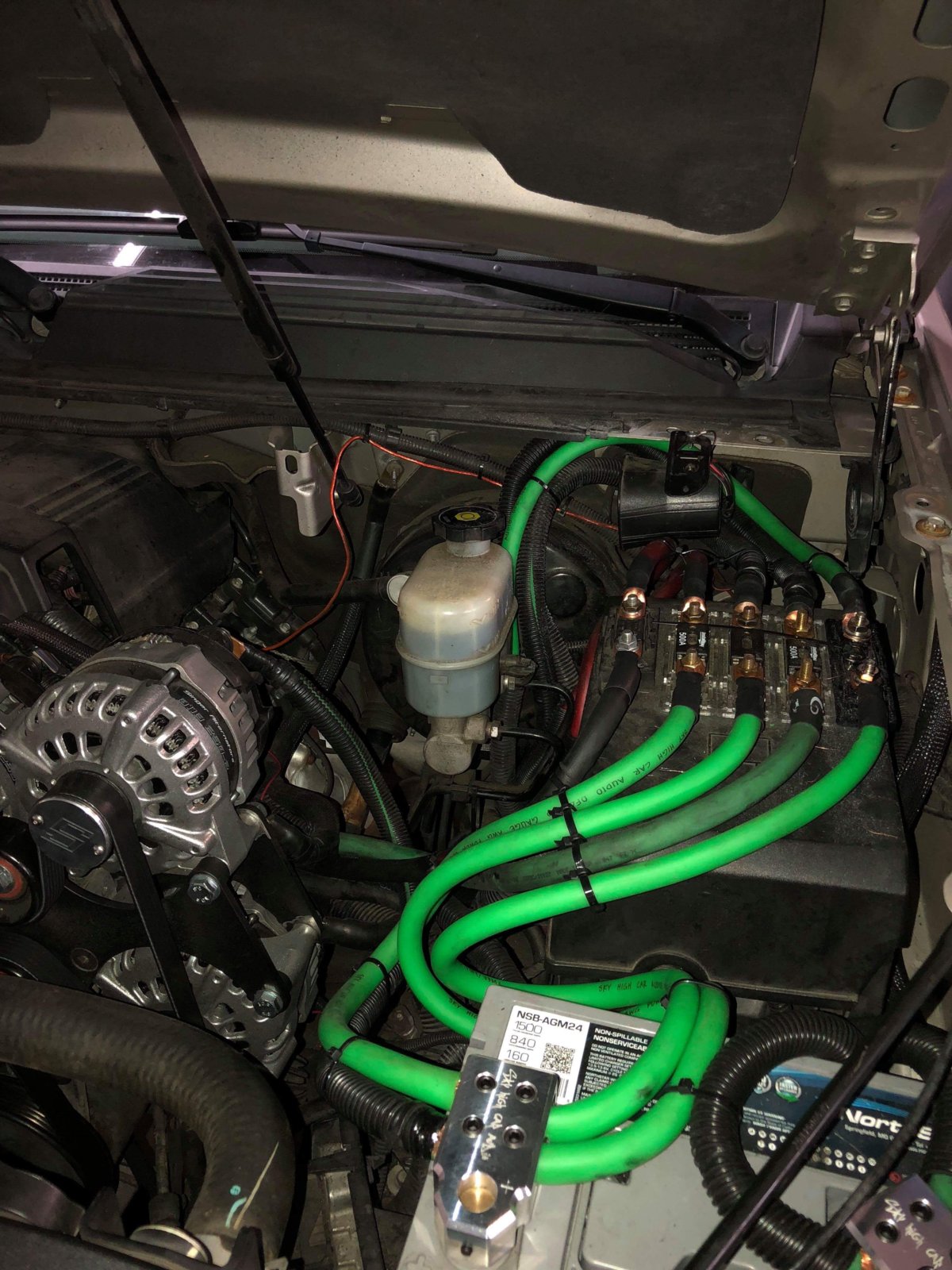

Well the other alternators had smoked bearings as well. The original 4 that is not the matching newer ones.
TahoeOn30s
TahoeOn30s
Aug 1, 2017
294
315
The reason being is they grounded out apparently paint must be removed from ground point of alts and brackets so that is being fixed

Well I ran into a few errors..one shop had rcas ran with power so we had to move and replace to other side. Bass knob broke making bass come in and out. As well had to install relay to provide enough voltage for amps. Snapped alt belt in half leaving my wedding lol but belt was used and abused from running with dieing mismatched alts. I think Ima step down to 3 alts to correct alignment issues. And I beat the piss out of my truck and now have my ignition on toggle switch truck still requires keys but I need switch for them to work lol
I have quad alts on my tahoe and my belt is fine. No need to go down to three alts If u can get your quad alt set up working proper. Sounds like improper installation if your having belt problems
TahoeOn30s
TahoeOn30s
Aug 1, 2017
294
315
I stepped down to 3 already I notice my engine doesn’t bog down at all like it was in the past and another thing too is when I switched brands on my quads they had slightly larger pulleys and I couldn’t quite find a belt they liked but everything is working a1 for now besides I think my hu now has a short because it now isn’t starting on every crank which I don’t quite understand

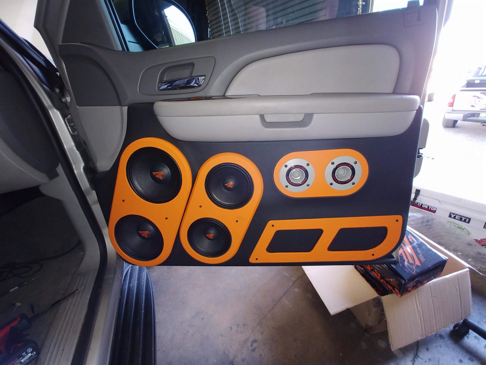

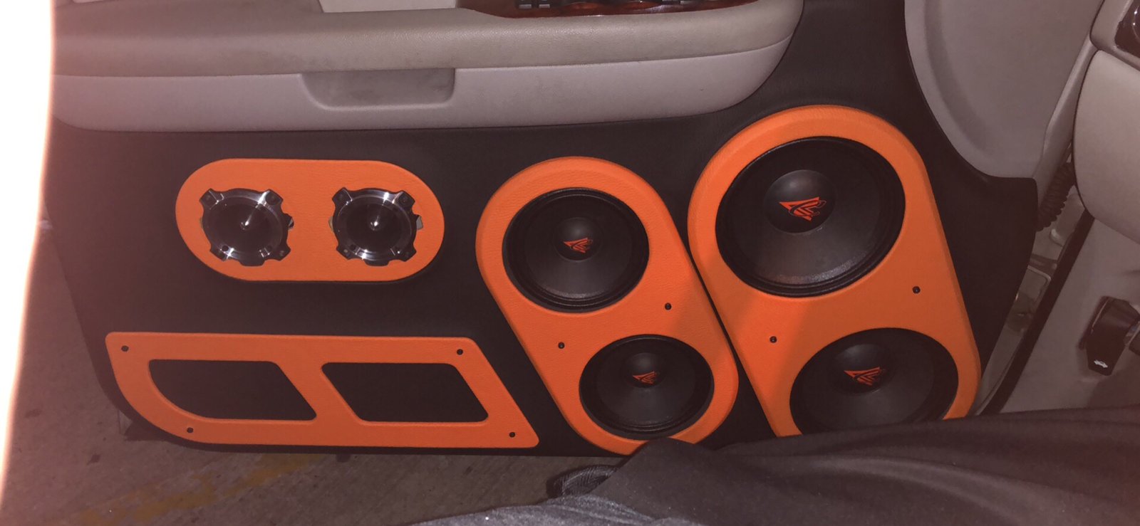

New door panels and speakers
Miami-Dade
Moderator Supporting Member
Dec 8, 2016
4,217
5,564
Congrats!! It is amazing what you have done to your Tahoe considering how abused it was before you got your hands on it..Nice job!!
TahoeOn30s
TahoeOn30s
Aug 1, 2017
294
315
Thanks man it hadn’t been cheap but I broke the two year marker with her in January
TahoeOn30s
TahoeOn30s
Aug 1, 2017
294
315

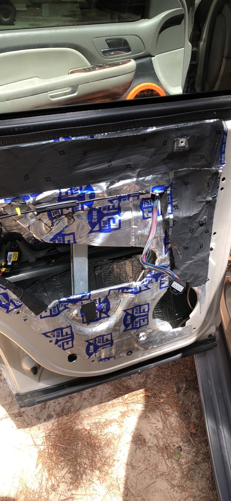

My rear doors currently have no sound deadner and a different brand of speaker so I will be replacing them with same as others and be deadening them along with rear hatch very soon here seeing that I just sold off all my old speakers without a problem
