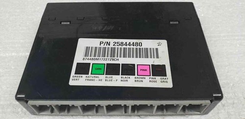

I've owned my 2010 Suburban 2500 for maybe 9 months now. I've had intermittent no start (won't crank) issues that I've always related to the battery. The first time it happened, it was also throwing all kinds of errors - 4WD, stability, ABS, etc. The shift position wouldn't display correctly. The rear hatch was inoperable. None of the gauges displayed that I can recall.
Replaced the battery and all was well.
Since then, on occasion it wouldn't start. Turn the key, power on everything, go to crank, everything goes blank. It would never jump without first removing the negative battery terminal first (in retrospect, I believe this was resetting the computers).
I figured it was a parasitic draw somewhere so I got in the habit of keeping it on a battery tender. Figured I'd get around to fixing the issue one day. I don't drive it often so it wasn't at the front of my mind.
Well earlier this week, twice it left me sit after being parked out in the hot sun for 6 hours or so (I usually park in my garage). Both times I got jumped, including having to remove a battery cable first.
So yesterday I start trying to find a parasitic draw. I was using the current draw method across my fuses, and on all the fuses I could check I'm showing 0 millivolts of activity. (Also, I've been keeping it in my garage and it's been starting fine when I do try). Well I had to run out at my lunch break, so I fired it up and went out to the store. On the way home, I heard a slight pop from somewhere inside the dash and all of a sudden the same errors - service 4wd, abs, blah blah. All gauges go dead except for the voltmeter. I can't be sure but it felt like much reduced power. Luckily I wasn't far from home.
Pulled in the driveway and started fiddling with things, turning it off and on, and it would restart fine several times until it suddenly did the black-out no crank again. I grabbed my voltmeter and checked the battery - 12.7 volts. So I simply removed the cable and attached it again, and it started up - no more errors.
So now I'm thinking I don't even have a draw - or if I do it's not my primary issue. I suspect the BCM may be bad, and it is being especially affected by heat. Before I start chasing down this rabbit hole, does this sound plausible? I don't own a tech2 so it would probably just be off to the dealer, unfortunately.

As a matter of required general maintenance the battery grounds should be replaced. They rot from the inside out effectively acting like a backed up pipe. Essentially it drains slower & slower until it’s time to call a plumber when it doesn’t.
The presumption of the BCM failing goes hand in hand with the grounding issues. The boards get cold joints. The price of replacement is so inexpensive that it doesn’t make sense not to swap out both when the signs are there.

I find it highly unlikely that any intermittent problem is computer-related. They either work, or they don't.
This is completely and utterly a bad electrical connection issue. I'd even replace both battery cables. Check the primary feeds to the alternator, to the mega fuse holder, and to the load center. You checked grounds? Check them again.
