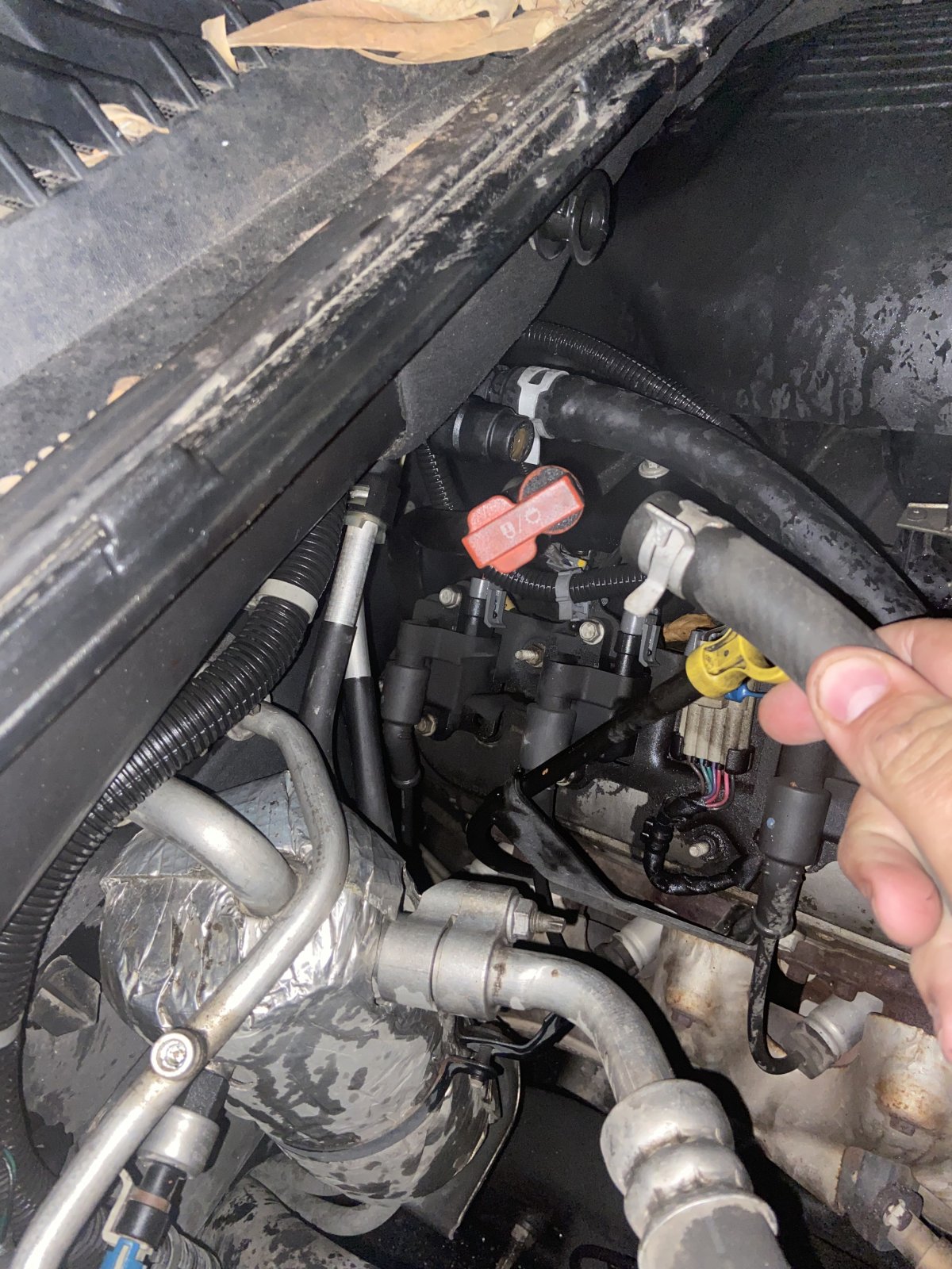

One is white one is black the parts except the hoses and metal part close to the thermostat is OEM replacements that’s why I’m so salty anyway here’s the get to and from work for a week setup

One is white one is black the parts except the hoses and metal part close to the thermostat is OEM replacements that’s why I’m so salty anyway here’s the get to and from work for a week setupView attachment 392111
looks like blew out to due to age, over time the plastic gets soft and brittle from all the hot/cold and then this happens, luckily you weren't 50 miles from home or some place where you would have had to walk out.

Age would be rediculous considering it’s a new part I have a grave feeling the mechanic stress cracked it when messing with my radiator and coolant flush
from the photo to me it looks like the plastic got brittle and broke right where they always break (the weak spot), it looks brownish and discolored like a old one would. if that was a new one that sucks
