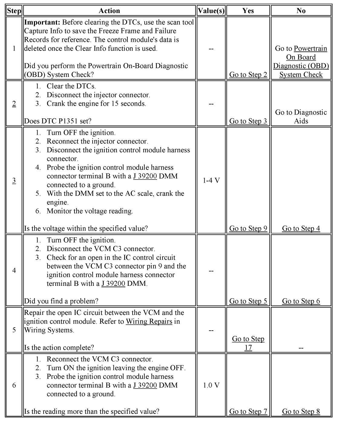

And if not AllDataDIY subscription, then get a PDF or hard copy of the GM Field Service Manual (FSM) for that model year. Really helpful to have all the wiring diagrams available and all the instructions on how things come apart (or go back together).
There are tons of great YouTube how-to's, but the FSM is great to have in front of you.
Also, the FSM has diagnostic tables with step-by-step instructions to walk you through what to do and look for. The tables also have specific instructions that pertain to menu navigation and running the diagnostic and programming functions of the Tech 2.
Not any of the Tech 2-specific references in this one, but here is an example of the diagnostic tables in the FSM and shows how it walks you through one step at a time, skipping steps based on what is found...
