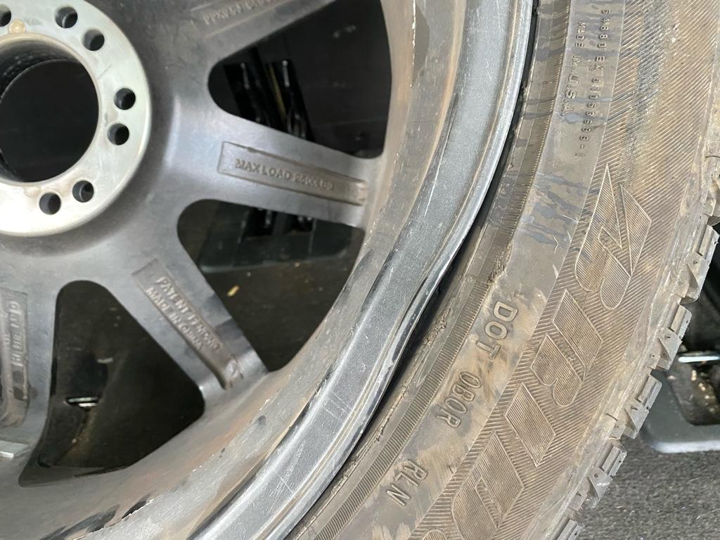

I took the busted rims off the vehicle and inspected the suspension and frame. Everything looked ok. So I put the 02 Esky on jack stands and pulled the wheels and tires and put them on hers. I drove it to work today and everything seems fine but I’ll get a better look this weekend when I get under it and change the oil. I’m tired and frustrated as hell but at least her vehicle is back rolling again.
I guess these rims are discontinued. They ended the run on these this year and I guess they have been in production for 15 years. So nobody that even has them wants to sell only 2. They want to sell the full set. But if I gotta buy a full set I’m gonna get something else that is at the beginning of a run so I know they’ll be available for a while. I’ve been getting kicked while I’m down over and over again here lately. I also need to get 2 tires so this is gonna be another $2k after all is said and done.

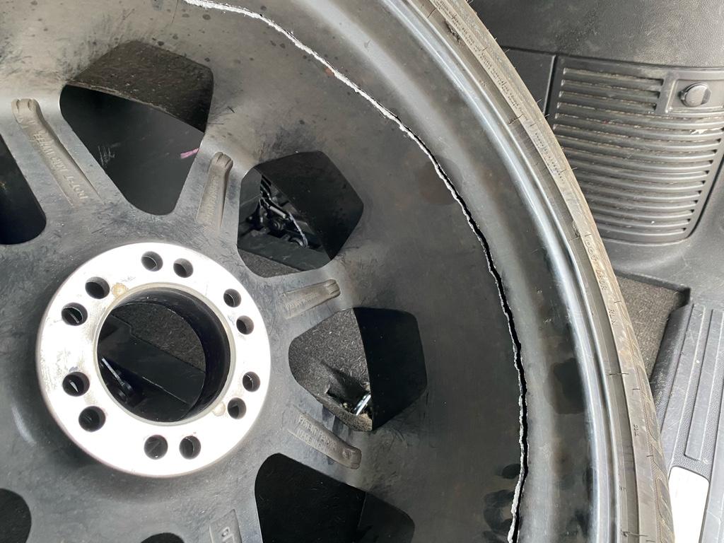

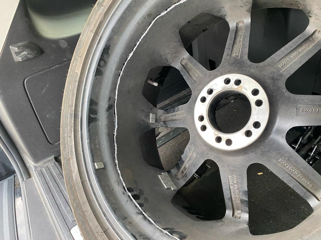

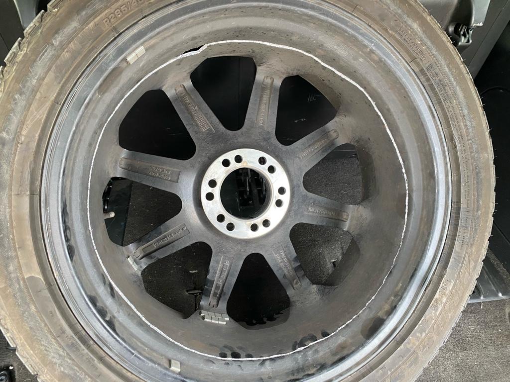

I'd be one miserable SOB if I didn't get any sleep!
KMC KM651 Slides in 22.
This is the rear one. Busted all the way around.

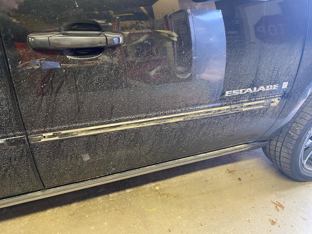

The latest thing that comes to mind was she caught the side molding on the chain link fence when she closed the door and tore it loose. She didn’t want it flapping and I wasn’t home so she ripped it off the rest of the way. Typical!
I ended up buying one of those eraser wheels. They actually work. I was skeptical at first and very hesitant but I figured if I can stay where the trim piece is gonna hide any marks from this wheel I should be good.
Suppose to use it on electric drill but my drill is at the old house still so I just turned air pressure down to 85 and it worked good.
Couple spots were stubborn and I didn’t want to dig in too hard. I can’t believe this wheel gets consumed so fast. I knew that it was consumable and would wear out but damn, all that mess on the floor is from the wheel itself. $12 I shouldn’t complain. At least I didn’t have to scrape it all off. I soaked it down with some Goof Off and scrubbed most of it the rest of the way off. The very edge is hard to remove and it probably won’t hurt nothing.
My biggest concern was with the alignment holes in door. The paint was chipped around the holes and I can’t just cover that up, I’ll hear it rusting while I’m trying to sleep and it’ll drive me crazy! So I sanded the spots down with some 400 and then used my touch up paint pen/brush thing to get the metal covered. Let that dry for 40 minutes and then used the clear thats on the bottom of the paint pen.
I guess I didn’t get any pictures but it looked like crap. I knew I was gonna wet sand it out anyway, I just wanted it sealed. Wet sanded with 1500, then 2000 after that stepped up to 2500 and finished off with 3000. It could have used another coat of clear but I didn’t have time. It’s covered anyway.

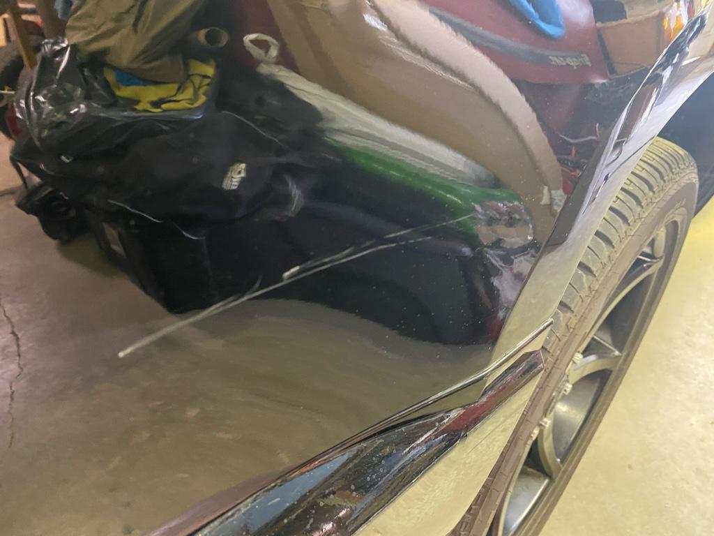

I could have left it at that, I didn’t sand outside what the molding covers so I may have been fine but I need to try to cut and polish this little scratch out anyway that she got on the rear right.
Broke out my 2” buffer/ polisher but went with 3” backer and pads on this one.
After getting aggressive with cutting compound I followed that up with polishing compound and I’m happy enough to get the trim ready to put on.
The scratch on back came out decent, I think I might wet sand it out but that’ll come later.
