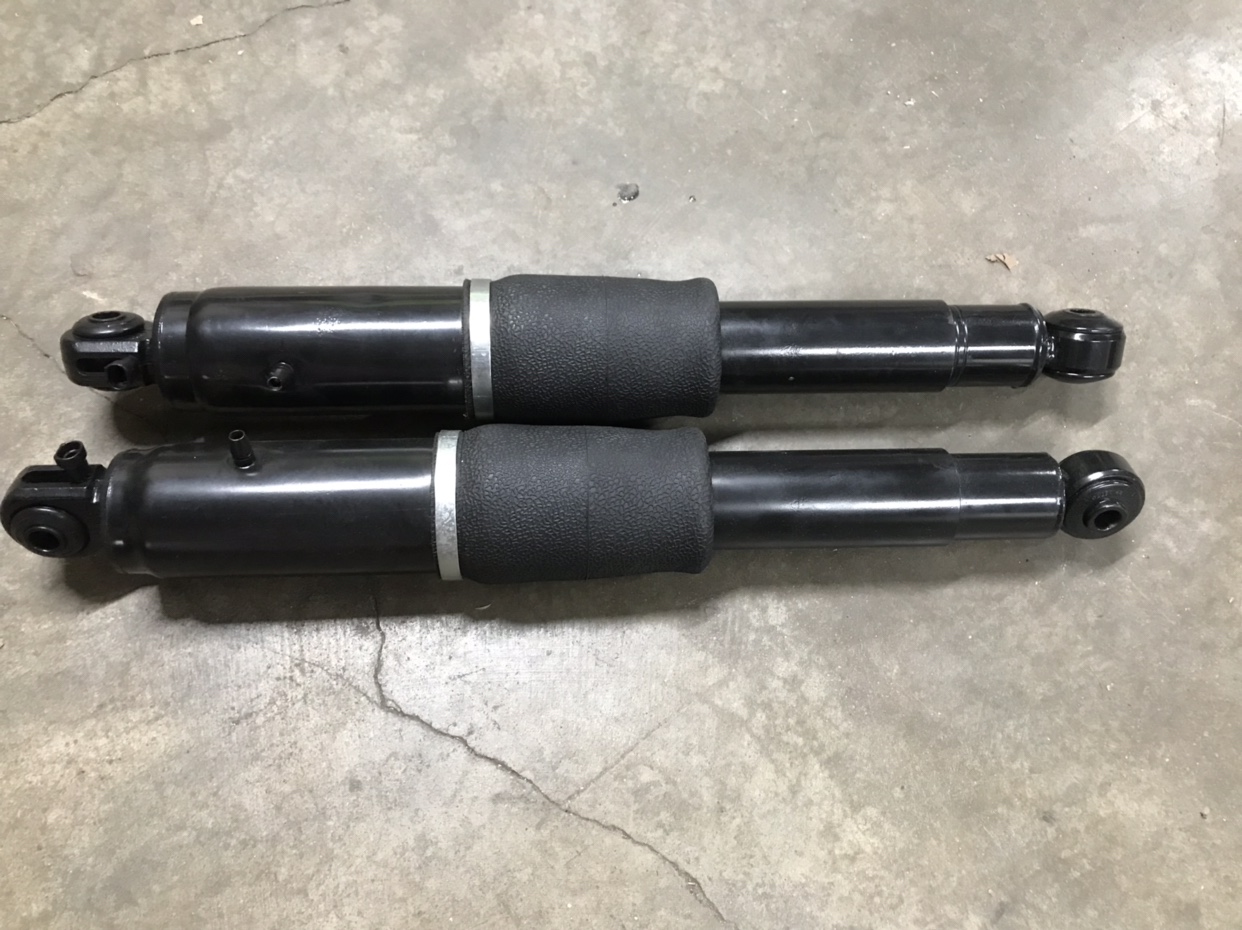

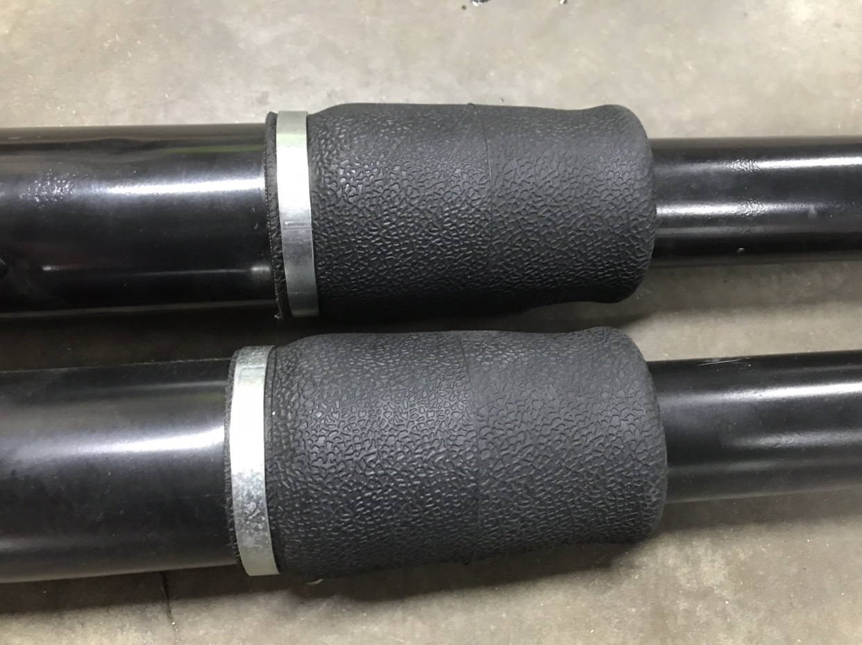

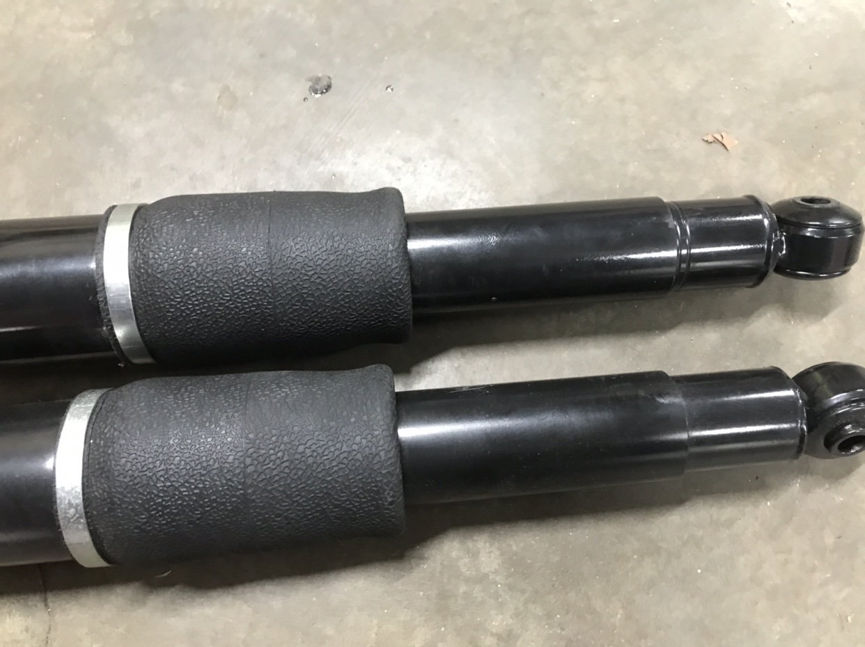

Rear shocks and compressor showed up the other day.
Boots appear to be good quality.

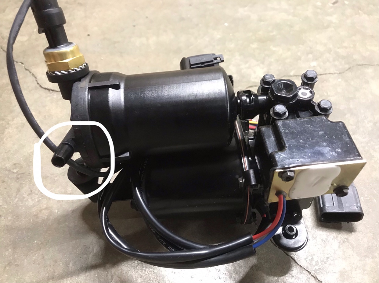

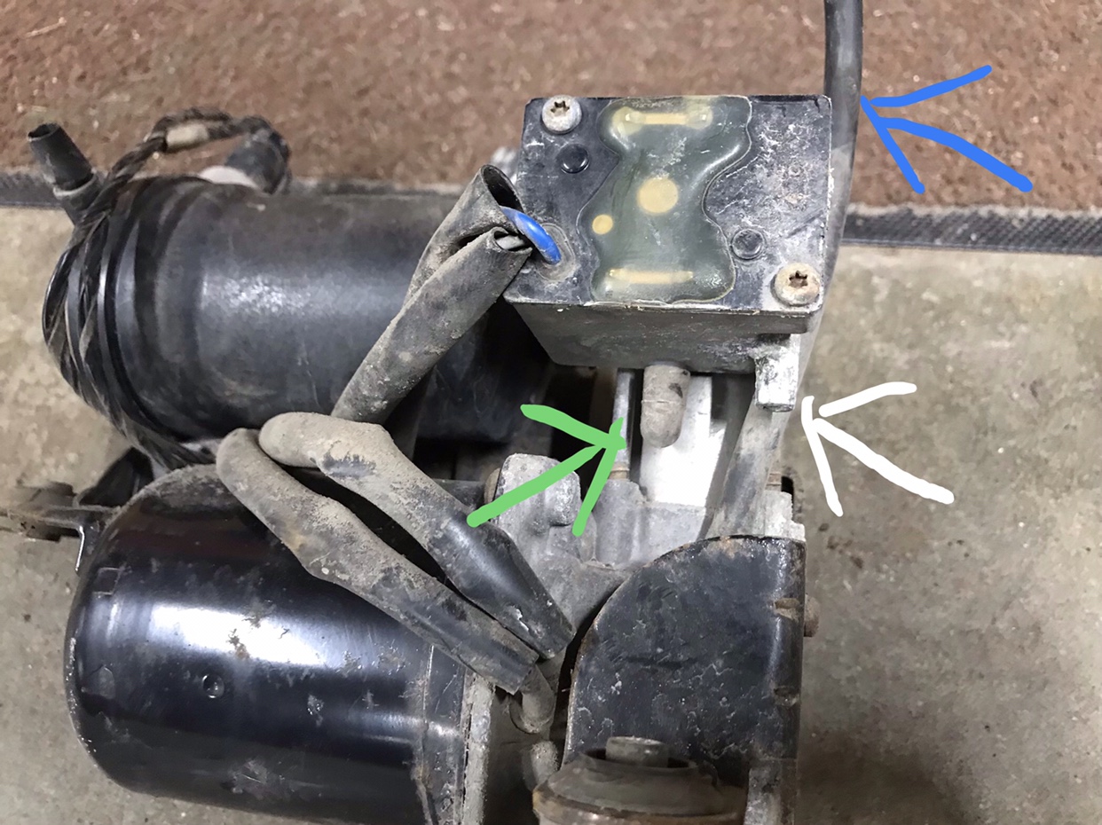

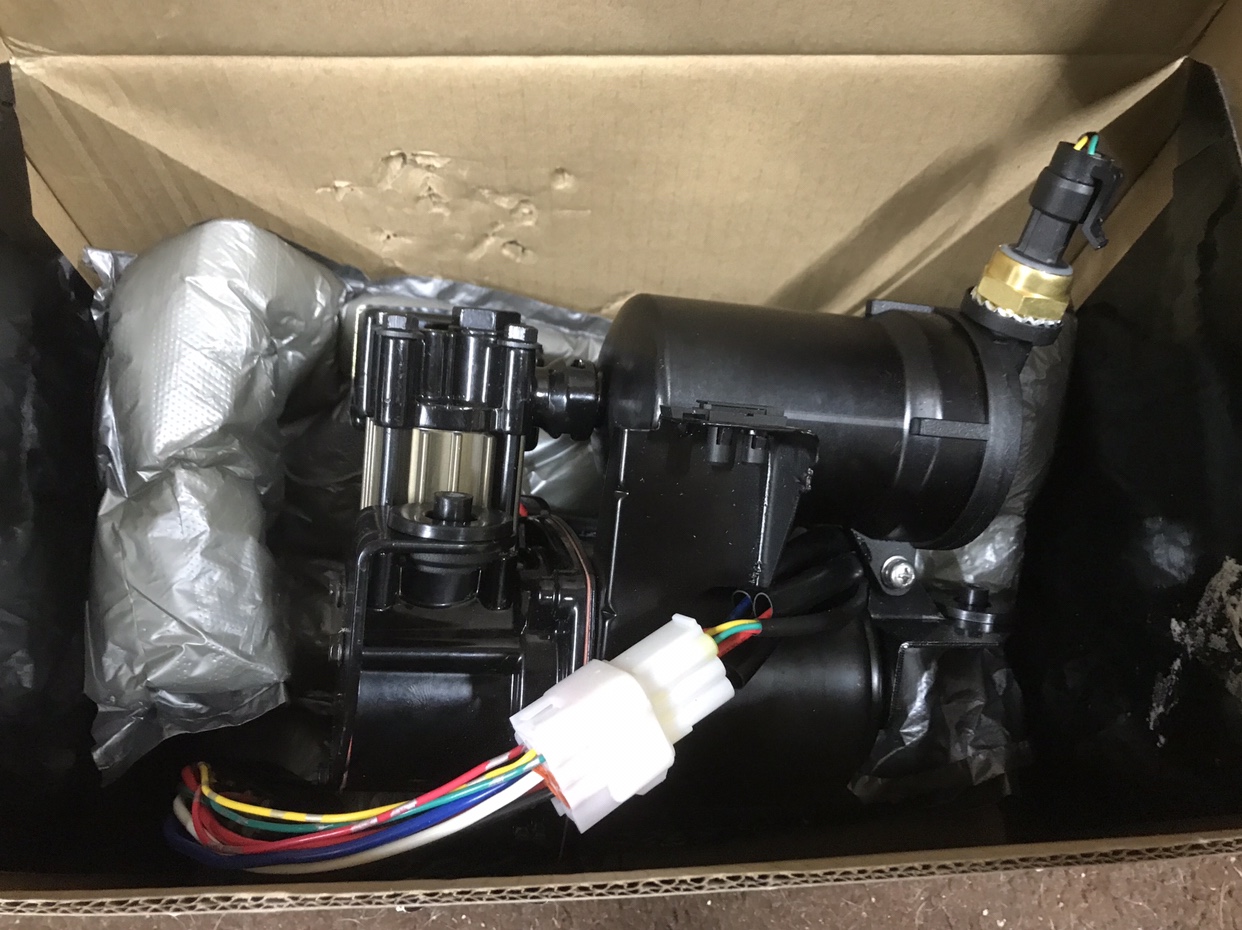

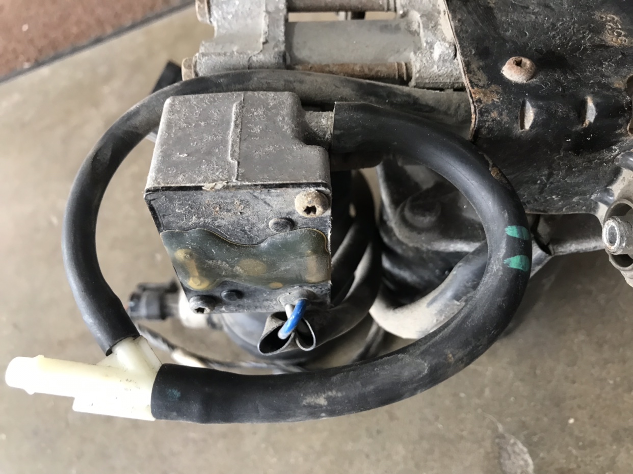

Looking at the compressor, the air inlet is different. The pics should show better than I can explain.
The white arrow is the air inlet. The blue arrow is pointing at a line that is Tee’d into the air inlet. The green arrow is pointing to a vacuum cap.
The new compressor
The white arrow is air inlet. The blue arrow is a line that jumps the line with blue arrow from first pic to the vacuum cap (green arrow from first pic).
I’m assuming to take out the Tee and attaching air inlet only to the port with white arrow. I’m not sure why the original has inlet to two ports and replacement has line attaching the two. Couldn’t find an answer or clear pics of what the purpose or differences between the two. Thoughts?
Then I went to install the compressor and the forward mounting tab is different. It should slide thru a hole in mounting bracket to allow compressor to be put up in place. The replacement unit has a fatter mounting tab that didn’t allow compressor to be slid forward so I couldn’t install it. Again, pics will explain better.
The new unit has the tab bolted to the motor. The original is spot welded on.
Drilled the spot welds and opened up the holes to match the bolt holes.
Swapped out the bushings
And got it attached to the motor.
That was an easy obstacle to overcome and I’m ready to install it but I need to find out what each port is for and if I should use the Tee or just attach inlet directly. I’ll search more after work today. Hard to find any info or breakdowns on this compressor.

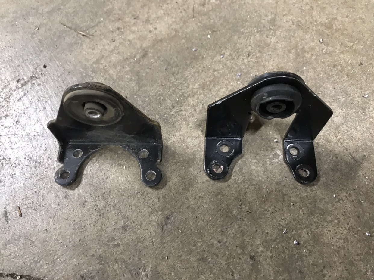

I don't understand what t? there should just be a air outlet on the pump and you just reconnect the line that came off the old pump, then that line will split to both the shocks

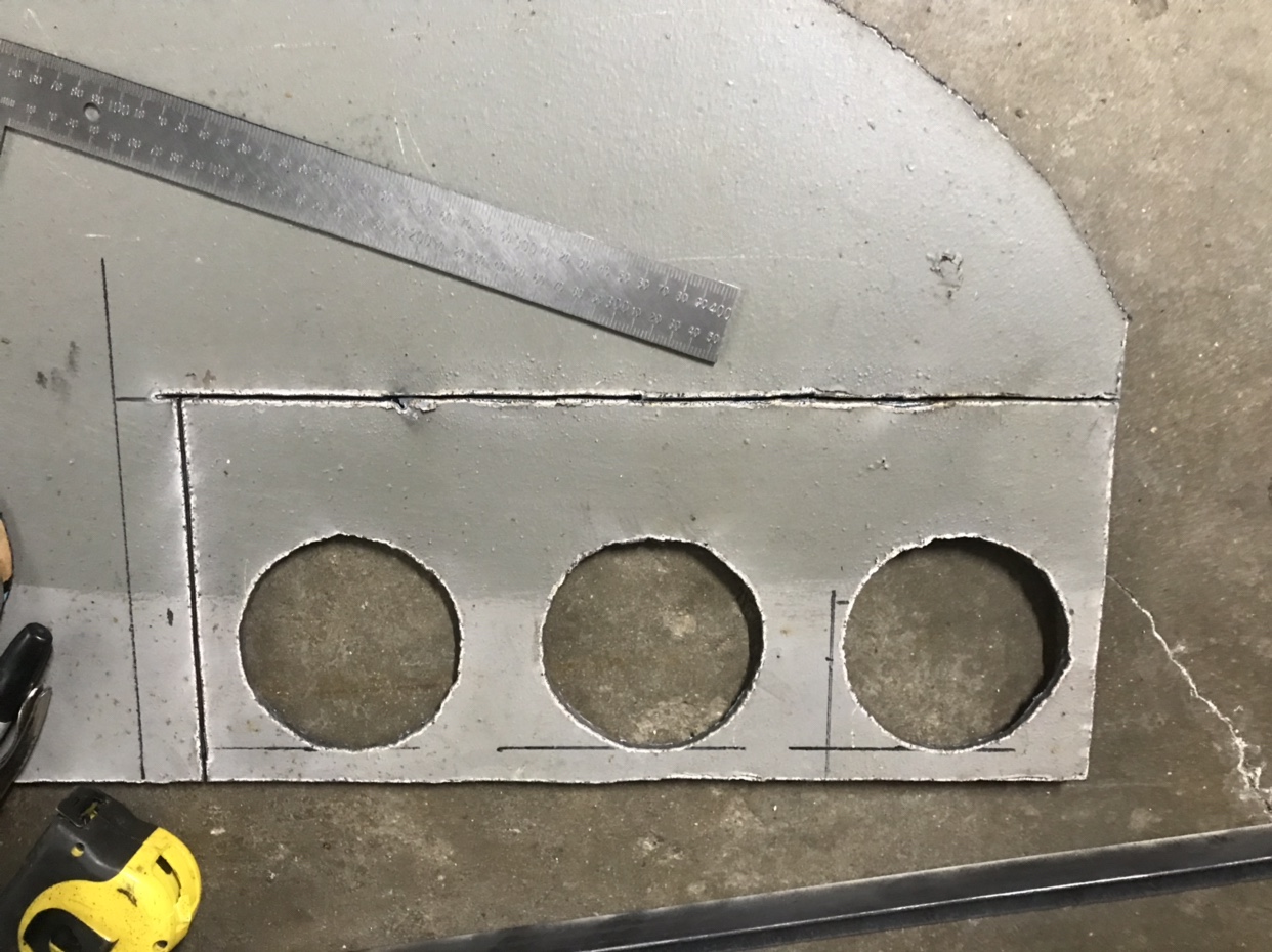

I did get a little more work done on my trailer. I had to fill a cut out that the PO did. He had an auxiliary fuel tank and pump under the trailer. The filler neck came up to this.
Used cardboard template and cut out a piece of 14 gauge steel.
Tack welded into place.
Cleaned it up with a grinder.
Bent the bottom up and around and welded it solid on backside and them primed it.
I don’t know why it was there either. I’ll get a picture a little later to show how it was connected.
I found this doing an image search. It’s an Arnott replacement. Notice the Y connector? That’s what I have. I said tee, but same difference, it’s actually the same thing, it’s a Y.
Why is that there? The motor is attached to a box which holds the crankshaft that drives the piston up and down. Inlet is tied into that box. Like a crankcase vent. But the replacement has “crankcase vent” jumped up to the box on side of cylinder. I’m thinking that the box on side of cylinder is a pressure release solenoid of some sorts. Does that make sense?
the pump system has a release valve, the purpose of that is to allow the pump to release some air out of the system just before the pump kicks on to lower the amp draw needed to start pumping air so that is why it is designed like that.

Here’s what I have exactly.
“New and improved design”?
I’m not gonna be able to put this thing on tonight, I’m trying to get spring hangers welded to trailer. I need to get this done so I can get it out of my driveway.
Where is the air output on the new pump?
30,773
48,479
Off the end of the dryer.
then all you need to do is mount the pump, plug in the harness, then connect the airline hose to that nipple.

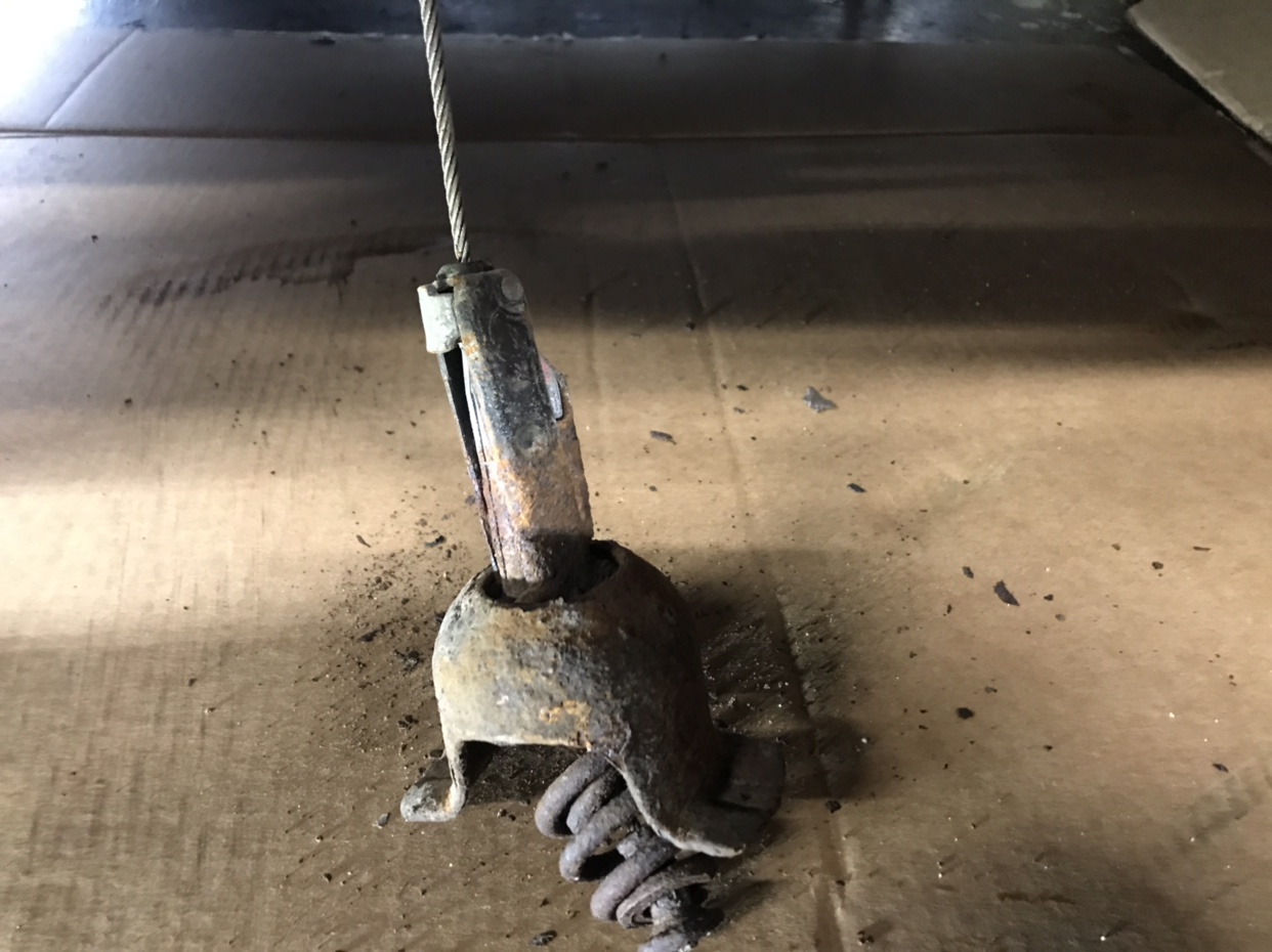

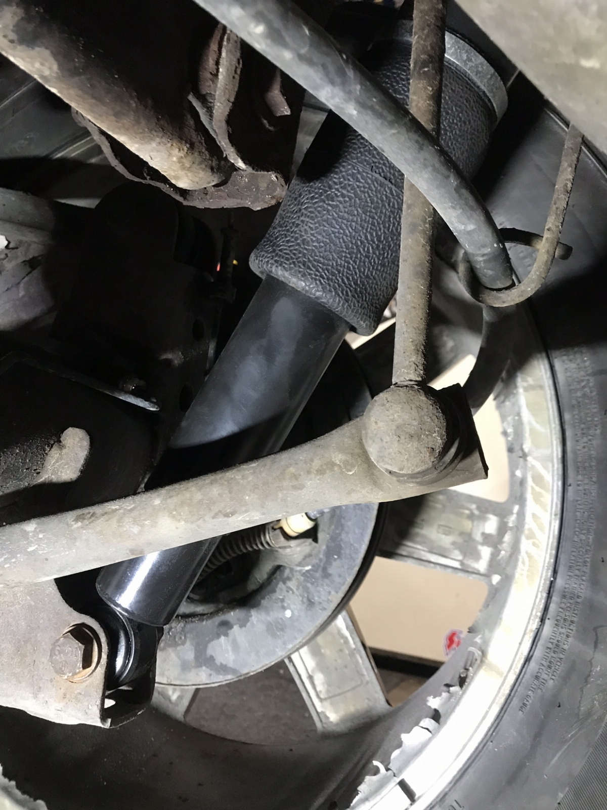

Funny you say that about the wheel speed sensor because I did just that. Forgot to plug it back in and got service stabilitrac, service traction control and an ABS light and then realized what I did.
Stupid secondary lock stuck on the spare tire. I hate them things. Wasn’t as bad as my truck but still had to get up there with some channel locks to manually compress the lock.
I cleaned it up and got some anti-seize in there before I put it back up.
Rear shocks went on without issue.
Pump went on and I left the Y off and ran intake hose directly to compressor.

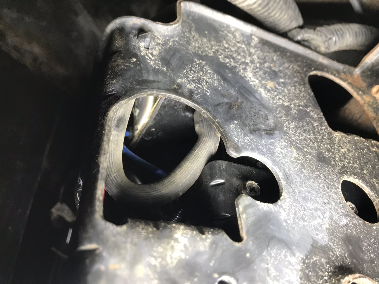

Before I put spare back up I had to address the suspension control module. It came loose from its bracket and was just sitting on top of the crossmember.
The rivets corroded and this bracket looks like complete crap.
I didn’t have time to give it the sandblast and POR treatment so I cleaned it up with a wire wheel, drilled out what was left of the rivets, used a 3M pad on a die grinder and cleaned to shiny metal where the module is riveted to the bracket and reattached with new rivets.

I have never had to compress the lock for the spare, I have always just lowered the cable enough to turn the bell part sideways and push it through the hole and it's off it only holds the spare on there by a little bit once the cable is loose enough it tilts and you can push it up and out. am I crazy? or will it not come off that way?
Can't lower it enough if the secondary latch won't come out of the tube. I had to do exactly what Jim did. Channel locks and a big screwdriver to force it closed so it would drop. Stupid thing. I lubed it up, and got it moving again when I put it back up. If it sticks next time, I'm grinding that tooth off the side without a second thought.
Yep, exactly. The cable should lower the tire to the ground. I’m cutting mine off too if it happens again.

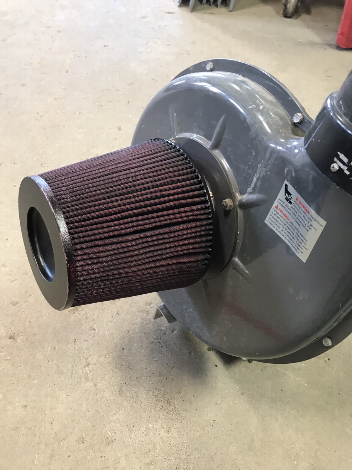

Took a minute this morning to get the blood changed in my dirtymax. I usually run about 5k between intervals but I’m at 5200 so I needed to get it done. Every other oil change I send a sample out to Blackstone Laboratories for analyst. I do this on all my vehicles just for early detection of any possible failure or premature wear. This time it’s due again and I’m also gonna cut open the filter and inspect it.
I wanted to share how I service my air filter. I used to pull the K&N and install a temporary filter until the cleaning process was complete. I hate how long it takes to let it dry before applying the oil so I came up with a different method which cut down the recharge process to about 30 minutes.
After pulling the filter I soak it with cleaner. I use my own concoction of simple green, fantastic and baking soda. Don’t ask me why, I used it for cleaning other things and it worked great so that’s my go to spray bottle. Then I brush it with a 2” chip brush to loosen the dirt. Bring it to my slop sink and run hot water from the inside out and continue to brush it while I turn it.
Now it’s soaked and this is where I speed up the process. I attach the filter to a Dayton exhaust fan on the outlet side. Turn on the fan and while it’s blowing the water out and drying the filter I use another chip brush while separating the filter baffles. Anything that otherwise would be embedded and a time consuming process to physically remove like cottonwood, flies right out.
I don’t want any dirt or dust getting blown into the clean side of the filter so I only run on the discharge of fan long enough to get the debris out in between the folds. Once I make it all the way around the filter I install it on the intake side of fan. I’ll let the fan go for about 10 minutes and that’s all it usually takes to get it dry enough. About equal to 3 hrs of sitting in the sun.
While fan is still running I apply the oil. This pulls the oil into the filter. I let it continue to run for another 5 minutes. If I don’t, I run the risk of oil coming thru intake tube on truck and it coats the MAF sensor and I get low readings which causes under fueling.
Install filter and don’t need to use my temporary filter for a few days while this one dries and gets oiled. Just thought I’d share some of my hillbilly engineering.
