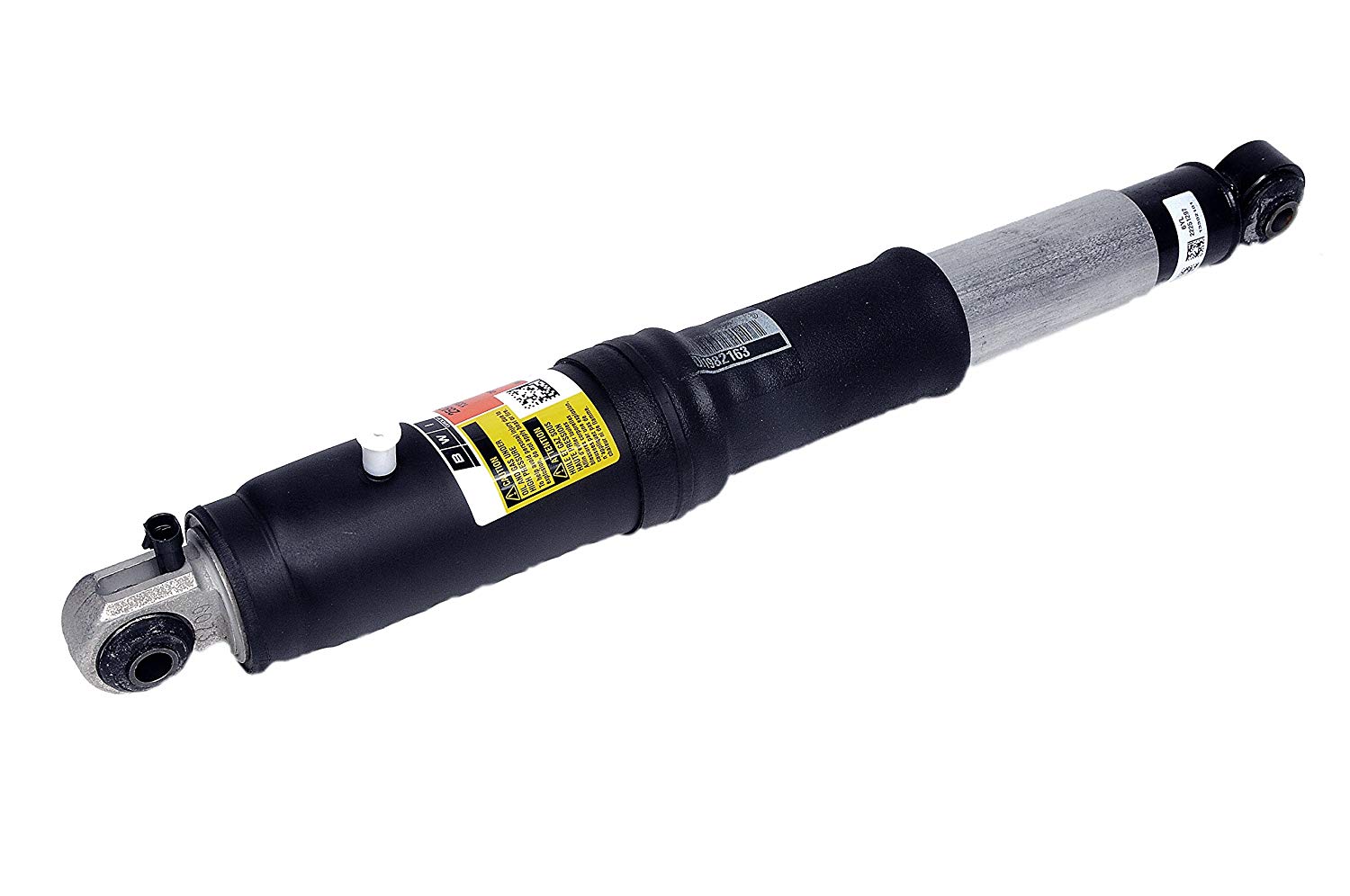

Is that bladder in the shock completely blown out? On the sticker--maybe try to convince her to do one in subdued. I mean it'll still be on there, but not so blatant, or "fancy" lol :gayfight:
It doesn’t look like it’s blown out. Almost looks like the bottom part had a rubber boot on it and it got pushed to the bottom. I don’t know. I have to find a picture of what it should look like.

i'm 99.99% sure that is a blown shock, it should look like this
45,016
Definitely a blown air bladder. The fuse(s) for the air system are probably blown so the whole system is just off- no activity, no warning lights, etc. The process usually starts with an air bladder leaking which results in the compressor running more than it should, then the leak gets bad enough that the compressor is running so much that it overheats or seizes. The compressor fuse blows and people usually just remove the other fuses for the system so it's totally disabled. The AutoRide part of the shock still functions as normal since it's a separate system and part of the StabiliTrak.

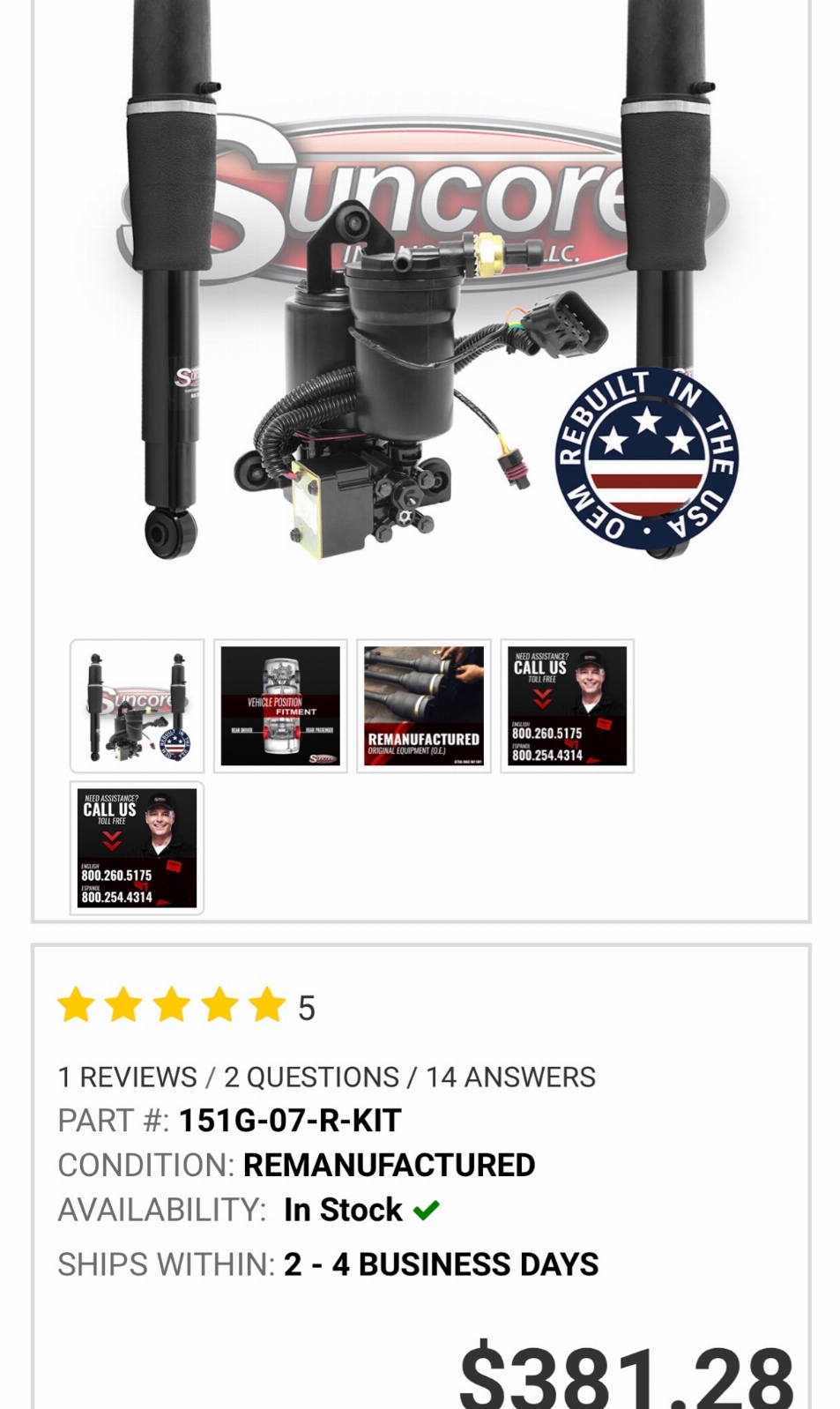

on rockauto the
ARNOTT AS2708 are $150 each plus a $50 refundable core, lifetime warranty
ARNOTT P2793 compressor is $230, lifetime warranty
so ya the cost is slightly more but It's a onetime cost
I don’t usually go cheap or cut corners when I do shit, so I should have gone that route but I went ahead and ordered the Suncore Industries package. Only bad thing I heard was about customer service from some. I guess I’ll find out. If I only get 2 years out of them I’ll go a different route. But now I’m second guessing myself.
30,773
48,479
I only paid what I did just because of the warranty and it was still cheaper than going oem with only 1yr, although rockauto does give some ac delco stuff 2yrs and sometimes lifetime depending on the part, I bought the front oem shock portion from rockauto and I think they said those had a lifetime warranty they were only $155 each, dealer wanted $480 each and $800+ for a complete strut

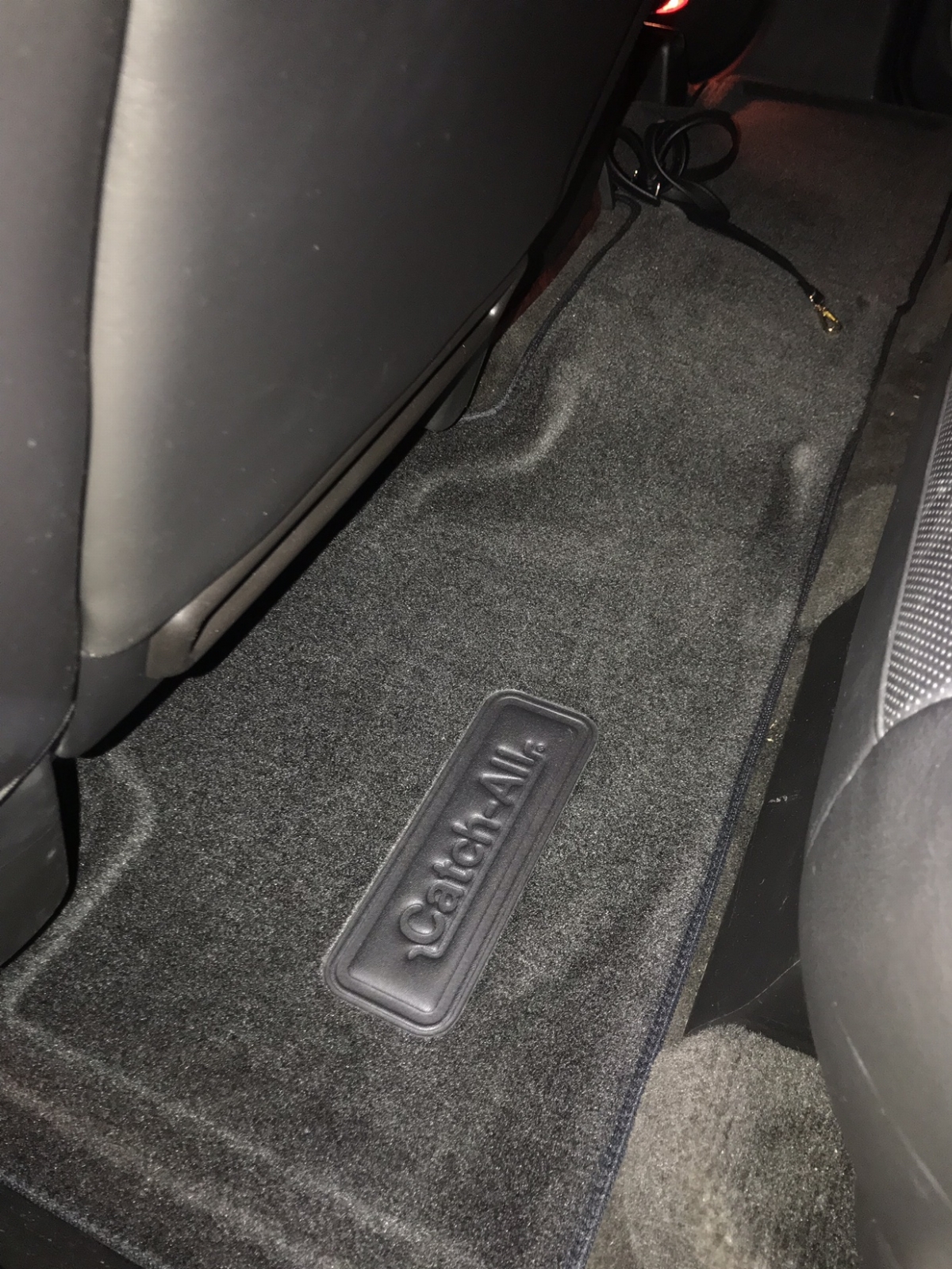

Sorry to be so late to the party. Nice build thread.
Where did you find the Catch-All rear mat? I can't find one anywhere; not even the Lund website. All I see is the Catch-It, which is different.
Thanks for checking it out. It’s kinda strange how it went down. I bought the front mats and the rear on the same day.
The fronts fit great and the second row was just what I wanted also. But the pics show the 3rd row way different than what I got.
That thing doesn’t fit anywhere. Nowhere in the description did it say base model or ESV. So I went on their website and that’s where I found the fitment.
I didn’t want to send it back, I needed the protection because it was crappy outside and my wife nanny’s my friends 2 kids and they were climbing in and out. So I put some welcome mats in the 3rd row until I could find something else.
I came across this and figured, it’s gotta fit. Looks like what I need and I liked how it goes under and in between the second row seats.
It showed up and no way. It’s for an ESV also. The hump in the floor is different and I couldn’t make it work. Had to send it back. I’m still at a loss for 3rd row coverage. I’m not swapping them out to weathertech even though they are made 10 miles from me. I like the plush look of the Catch-All mats. So if you find any, please let me know.
Your gonna talk me into cancelling my order! They should be here on Monday. Decisions, decisions.

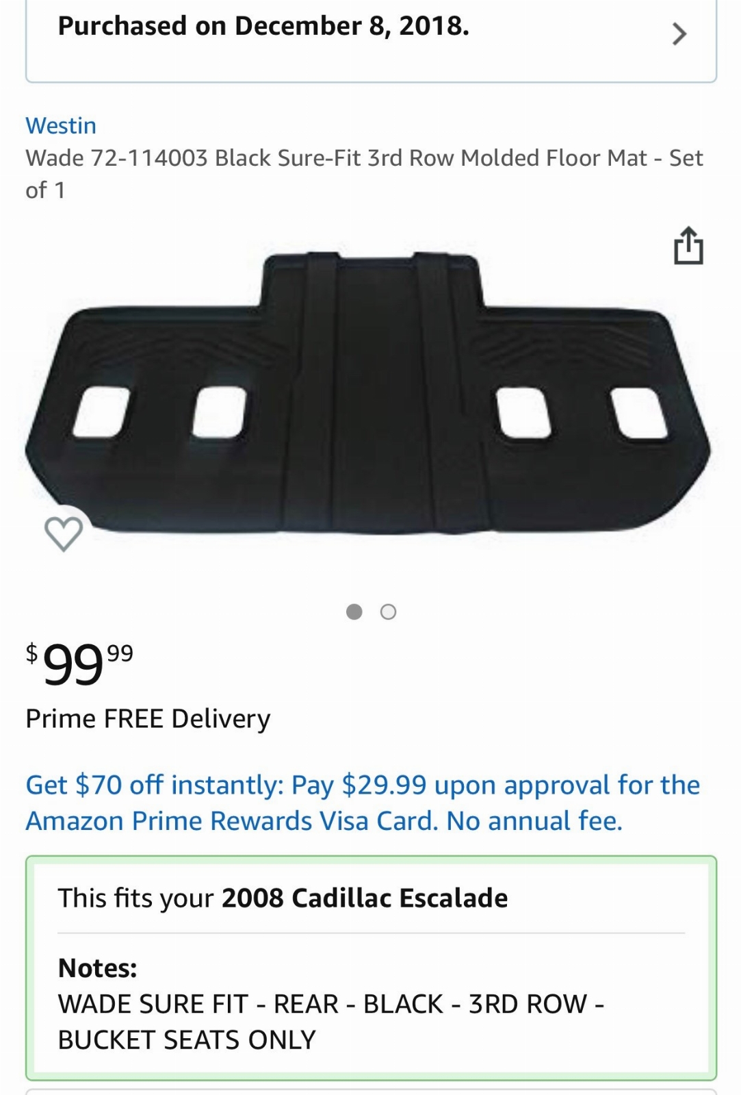

That explains it. I didn't realize 2nd and 3rd row came as one item. I was just looking for 2nd row only. Thanks for the link.
