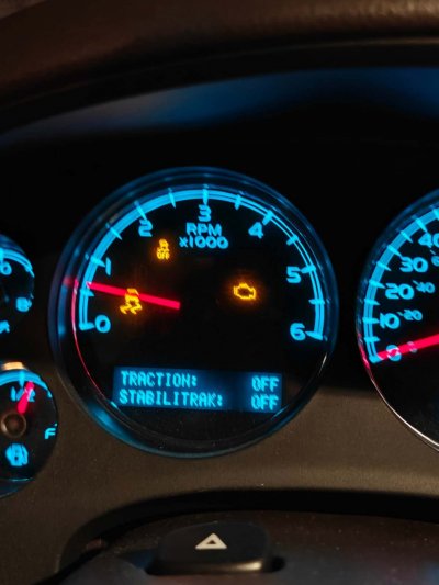

The truck is 2012 Denali XL, 106K miles, no mod.
I have experienced a weird problem since November last year. It happened 4 times only in humid weather after rain/snow.
During normal driving in a humid day, both Traction and Stabilitrak were set OFF with some burning smell.

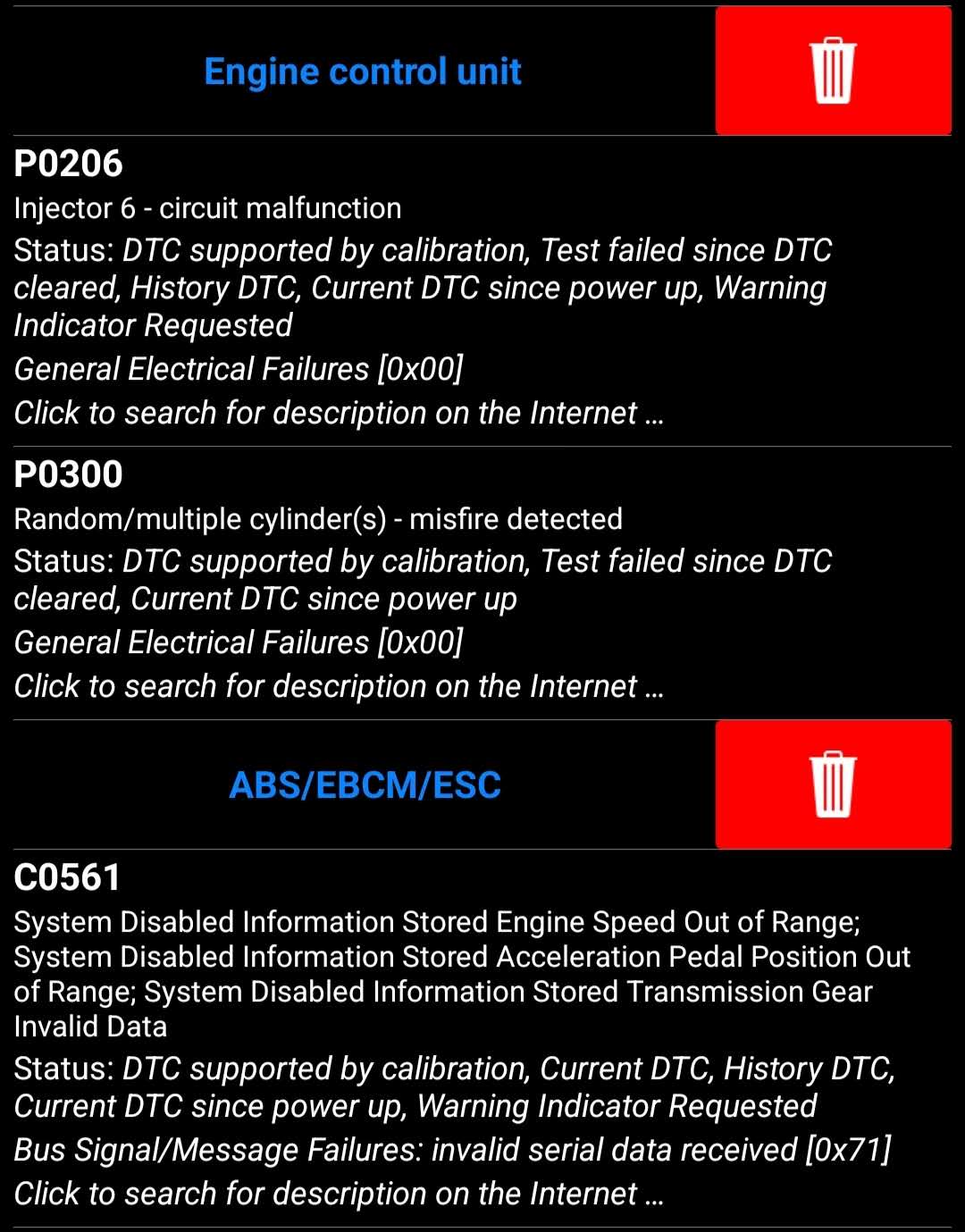

Engine codes P0206 P0300 P0306 showed up twice. Engin shaked and stalled once. Code C0561 showed up once.
I checked the resistance of injector circuit/wire with a multimeter and all fluid level are in range.
I used a generic bluetooth OBD scanner to clear the codes. The truck was driving fine in sunny/dry weather.

IIRC the misfire issue will trigger those functions off.
Do you mean that the misfire caused Traction/StabiliTrak OFF. Will misfire happen intermittently? Will misfire happen at engine idling?

The Traction/StabiliTrak light came on before flash engine light. Does this still imply the the misfire may be the root cause?
Foggy
Jul 25, 2019
1,423
1,952
KS
Misfires will cause it to go to "limp mode" which always sets off the
traction control abs wheel speed kinda stuff.
You need to fix the p206 & p306.. Cylinder 6 misfire and/or injector
or wiring issue for sure. The P0300 almost always sets with specific cylinder
misfires. maybe time for plugs, wires, injector cleaning imo

Since nearly all the misfires are at cylinder #6, try swapping plug wires with cylinder #1.
If the problem moves to cylinder #1, you need a new plug wire.
If the problem stays with cylinder #6, try swapping COILS with cylinder #1.
If the problem stays with cylinder #6, you need one new spark plug.
If the problem moves to cylinder #1, you need a new coil.

feels like this is probably a coil breaking over to ground when it's wet. is my guess. Definitely do this coil swap. or I've even seen a loose spark plug cause weirdness.
