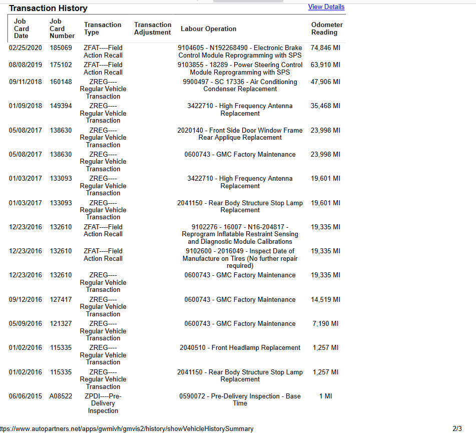

Picked mine up yesterday for $29k (92.5k miles). Thankfully the selling dealer (Jeep/Dodge) also owns a Chevrolet dealership. I asked them to give me a full service history for any dealer work and they emailed me a .pdf of all work performed at any GM dealer. It also included a list of any warranties still in effect. Looks like I'm good until 2025 and 150k miles for the "Special Coverage N182202780" brake booster issue. I'm blown away how fast they had to replace a headlight and taillight unit at 1,257 miles when this thing was still warm off the Arlington assembly line! But its had both taillights replaced, the leaking antenna replaced, and the condenser replaced. Hopefully the 3.5 year old condenser was of a better design...

Very nice! Like some else posted, I'm always concerned with where the truck comes from. Get a carfax and see how many owners, where it started its life and if it had any accidents. I never buy vehicles if they come from big cities or salty road areas. The dealers will run a carfax for free for you.
