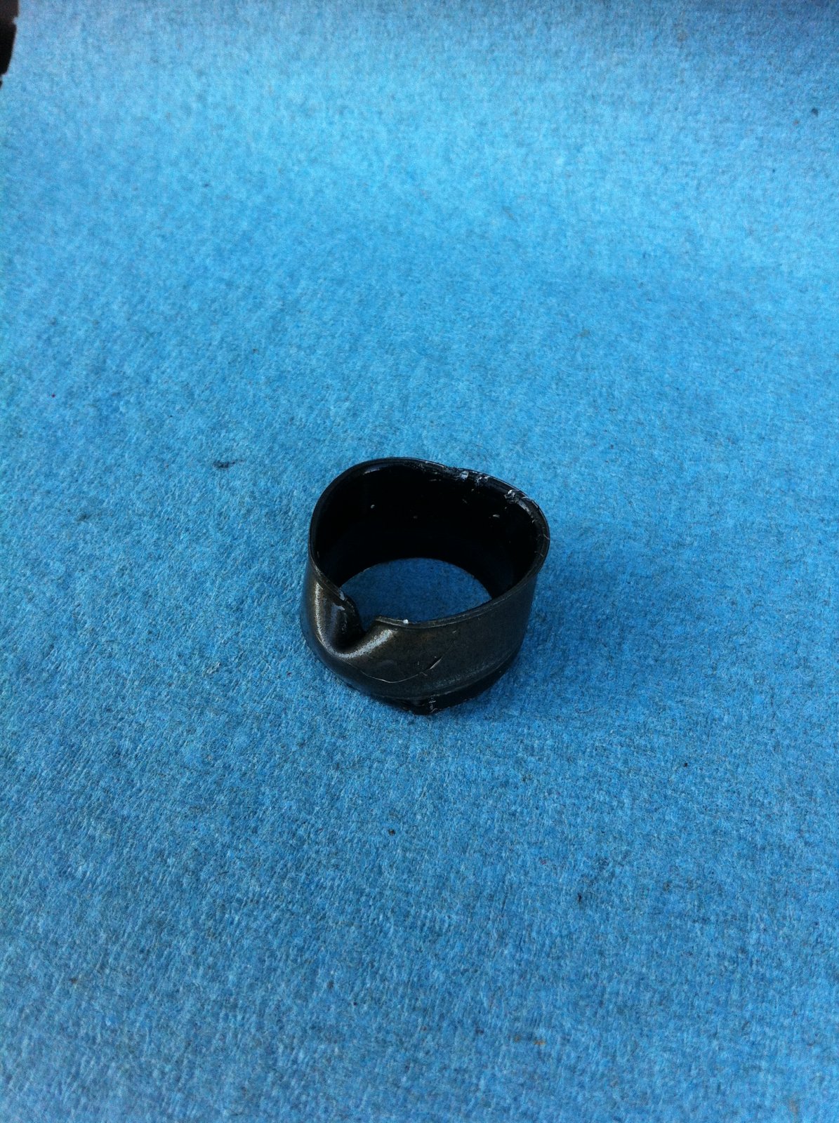

This seems to be the only other option. I didn't want to damage the body if I could help it.

I'd bet that was the original from the factory. There was only one tiny spot where I could put the small pick and it wouldn't slip straight off. Gave it a few hits and it moved enough to where I could get the screwdriver on it and hit it a couple more times. When it slipped back I pulled out out with long nose pliers.
The new one has a nice lip all the way around and will be easy to get behind/out.
