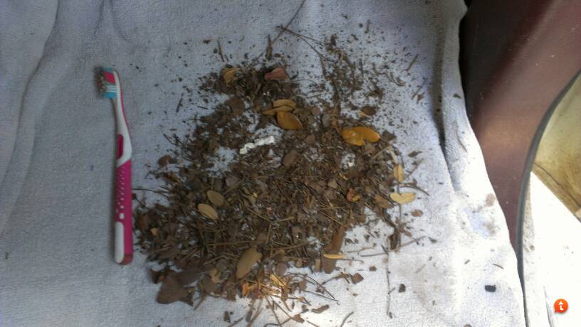

I just did this as well today. Best thing I have ever done! My ac was ok at best. (Front air only, no rear) I decided to try it. It works! Ac is much better! I had tons of crud in there. Looked like a bird nest! I have a few before and during pictures. None of the final because I started to clean up some of the water and forgot!
Thanks to the OP for a great write up!
The last pic is during, not finished.

Thanks for the great write up... oh yeah, here's what I pulled outta mine.

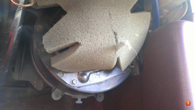

Am I the only missing a plastic cover on mine? All I have is this...abe9eged.jpg

Wow...what do i win for most shit in this? Lol Didn't wash it out yet, for another day...but cleaned it out and blew it out with an air hose a little bit. Already made a big difference. I can feel the air touch my face now in the front seat again. Thanks!
Sent from my HTC One X

When you actually get some cleaner in there and let it soak, then brush it. You will see a nice difference. Mine has the full plastic cover but it's pretty beat up and doesn't fit well anymore.
