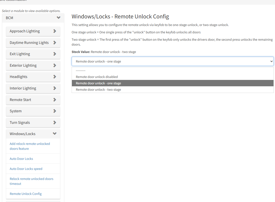

Anybody know if I can use the diablosport predatorX to do things on the BCM like remove the 2 button push requirement to open all doors?
mikez71
Mar 9, 2023
3,369
4,174
BTDieselworks autosync w/BCM programming can make it one press unlock all.
I'm aware of nothing else that can program the BCM..
(heard of some engineering type tools that can easily brick your module if you don't know what you're doing, and also costs much more)
And regarding @MarvinVR 's question about disabling stabilitrak., it seems anything that faults the system may do it.

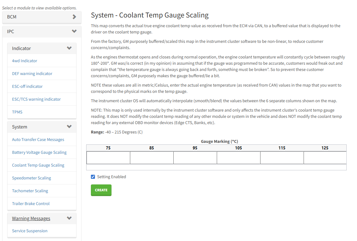

Autosync now has cluster programming if you want to scale the sweep of the guages, or disable the stabilitrak lights!
Though I have not purchased that or tested it.

'Auto door unlock' is a DIC setting you can turn off already!
Auto lock can be defeated with the Autosync.

Just got my Autosync and bought the programming license,
I'm thinking about doing a detailed review on all the features and how they work.
Here's what did NOT work for me, but if we bug him, maybe he will get around to it?
Speed sensitive wipers
windshield washer wipe delay
auto door locks - might work but it's more of a process disabling it and having to select default settings in the DIC..
(I set my speed very high which was simpler and works)
