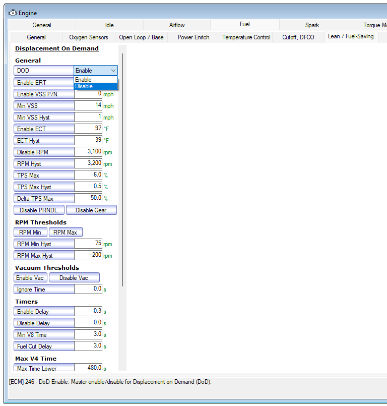

how the hell does a guy figure out what any of those tunes do on ewaltsautotuning ? there’s no descriptions. All I want to do is turn off the DOD on my 08 Tahoe 5.3. I have a HPT MPVI2.

You have to compare them to the stock files and see what's different.

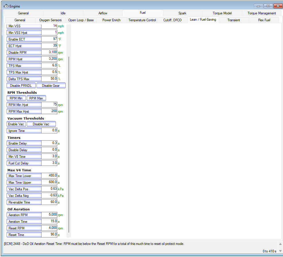

@mikez71, would you mind posting the rest of the 'Displacement On Demand' stuff that got cut off under the bottom of this pic?
Let it be known that there are several other ways to disable Engine Half@$$ that are more elegant and clever than the 'master switch'.
*Raise 'Min VSS' over the vehicle's top speed, for example. Still enabled, but it'll also never happen anyway.
*Raise 'Enable ECT' over 266F so Engine Half@$$ never happens anyway
*Lower 'Disable RpM' to 500RpM
*Lower 'TPS Max' and 'TPS Max Hysteresis' to 0.0%TPS
*Lower 'Max Time Lower' & 'Max Time Upper' to 0.0sec
Anyone noticing a pattern here ...
Here ya go
